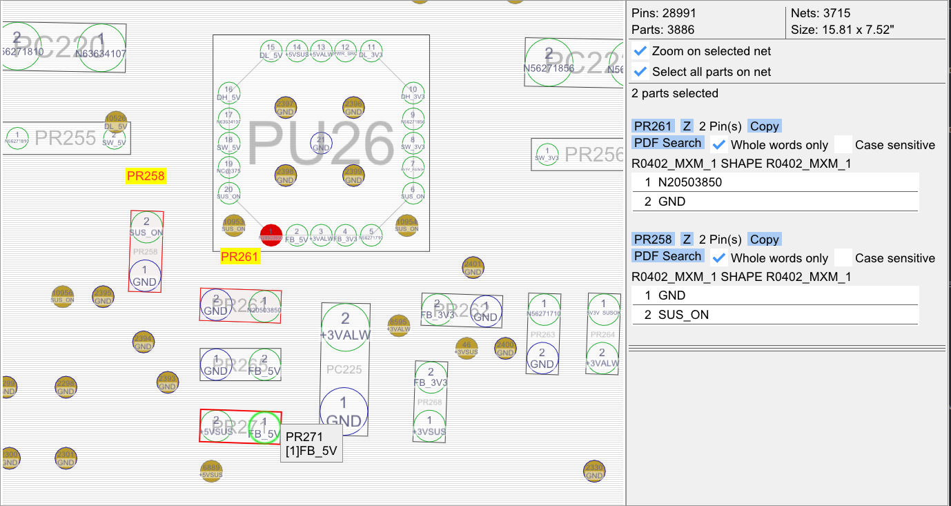

    Originally posted by Dcortest View Post
    Pin 1 resistor 1kohms
    Pin 2 resistor 22.2ohms
    Pin 3 resistor 1kohms
    Pin 4 resistor 22.2 ohms
    The resistor near pin 1 is 100kohms
    Do you have the resistor values near PU26 (TPS51225C) on the boardview? Specifically PR258, PR261, PR265, and PR271? I displaced mine when I removed the TPS51225C chip for replacement.
      Does anyone have the schematic for the MSI GS75 (9SG 242 US)? The boardview for the MS-17G11 is close enough but I can't find a schematic for looking up resistance and capacitors values anywhere.
