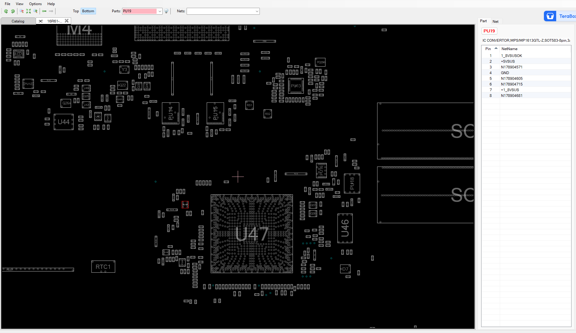

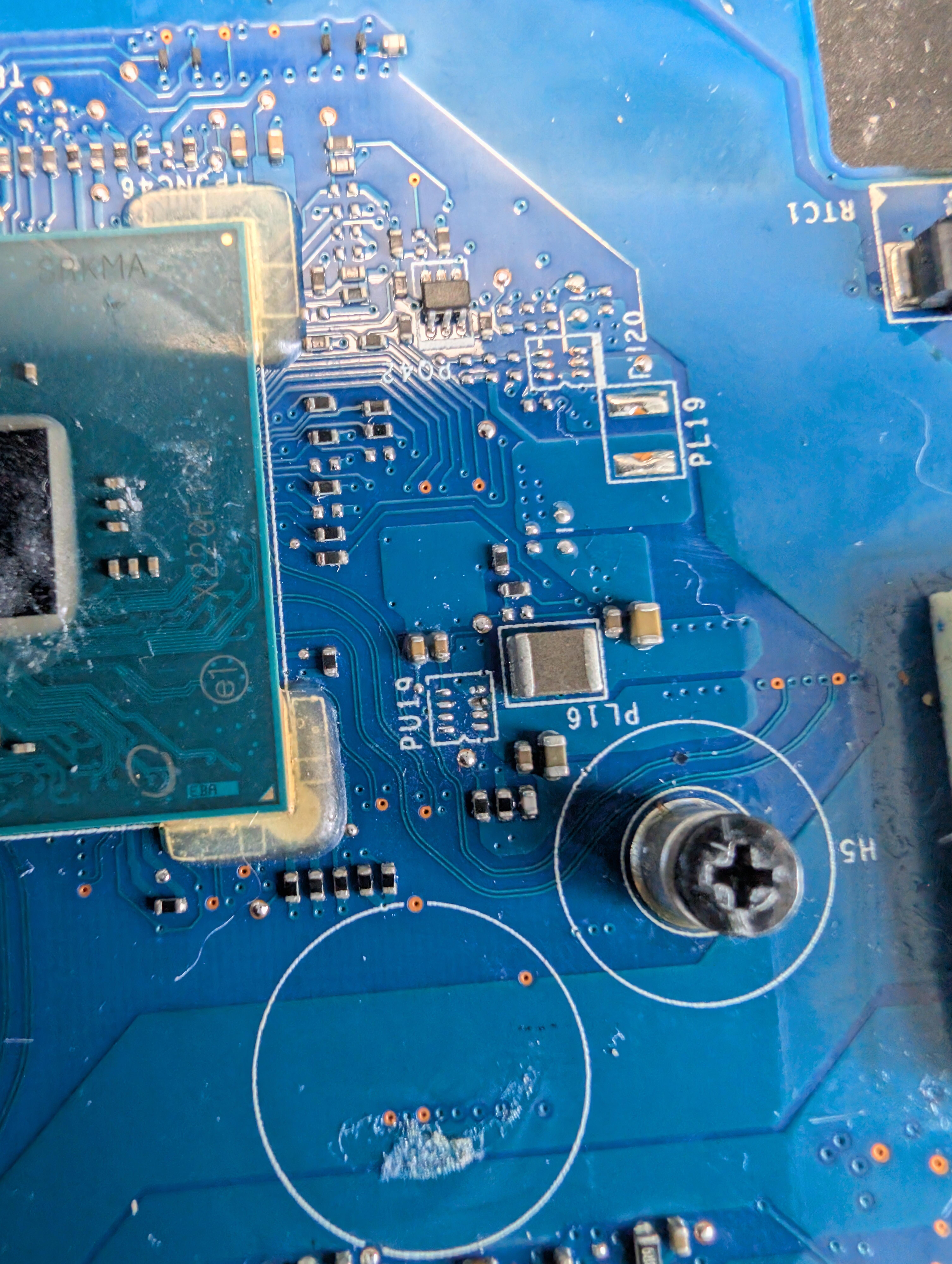

          The PU19 chip is ripped off, and PCH is dead.
          But I can't find the PU19 chip, because no datasheet / boardview, and olders motherboards didn't use the same chip.
          Someone can help me ?
            IC CONVERTOR,MPS/MP1613GTL
            • loic2907
              • Feb 2020
              • 34
              • France
              Thanks a lot, where do you find the information ?
                here Click image for larger version
