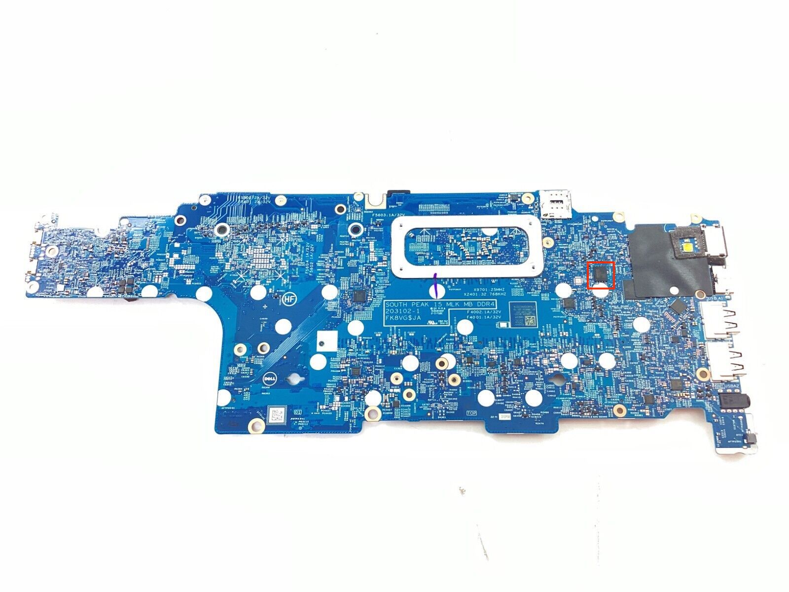

    Hi., can someone help to unlock the BIOS. I tried this method on this thread (https://www.badcaps.net/forum/showpo...ostcount=1250) but it did not work at all. I have uploading the Original BIOS Bin File. Please help. Thanks in advance. Dell Latitude 5530 Serial # G22JCS3
    Thereยดs another bios chipset on the other side, for EC, read that chipset and post it here.

        @volinakis thanks ., here you go EC (25Q256JV) BIN file at the back of the board. Thanks in advance

          1st boot press F2, write service tag, disable Absolute, apply changes, restart. 2nd boot press alt+F to exit factory mode.

              @volinakis one thing more. "disable Absolute" is this a feature in the BIOS setup., never even noticed it (:- !!!

                yes, in Security tab, bottom of the page
                  @volinakis thank you very much..GREAT JOB DONE!!! all works fine

                                        Read your bios again and save it than reprogram withe the unlocked file than post replay
