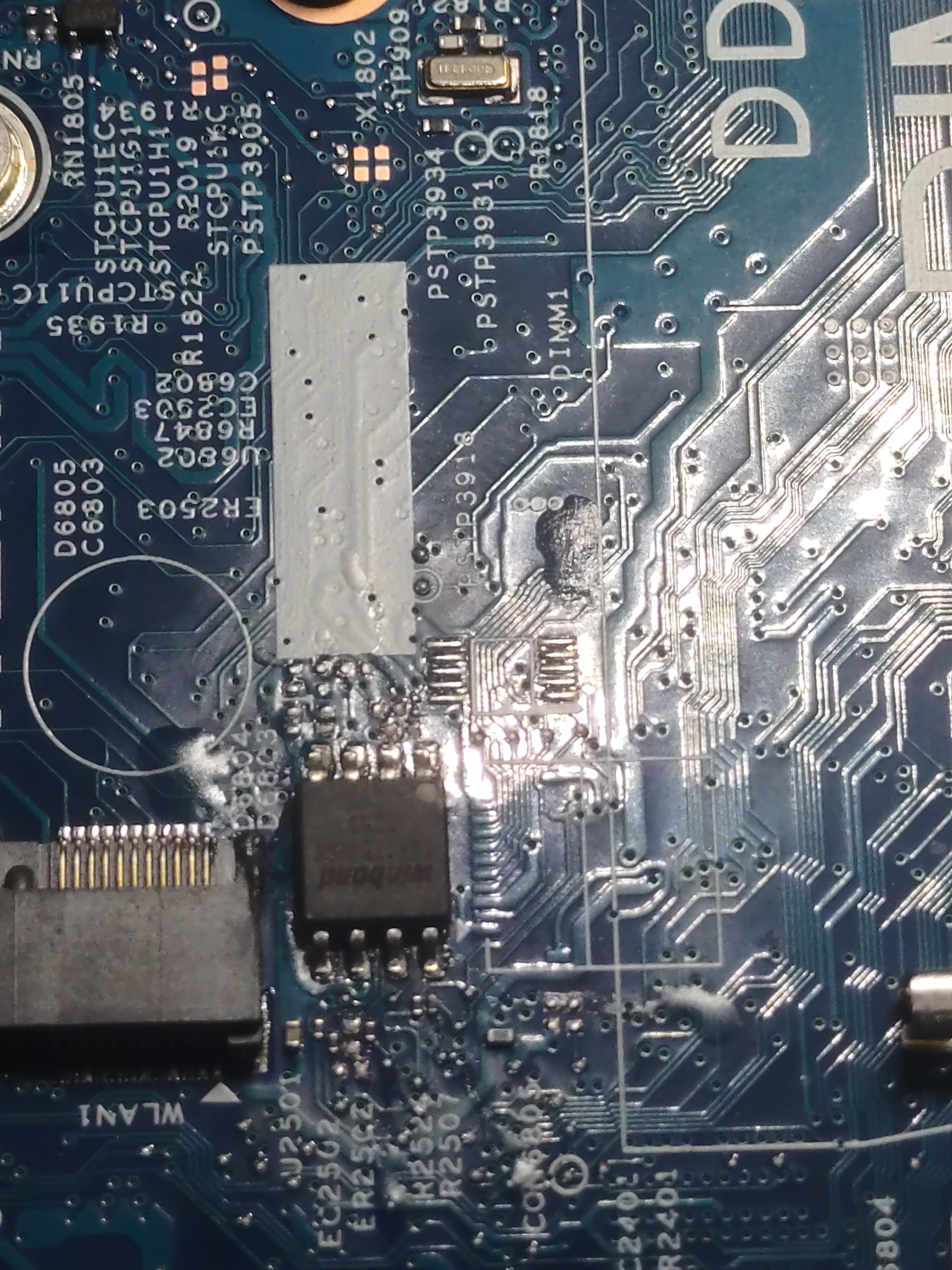

    Originally posted by GigaBlyate
    Hi all.)
    I wanted to remove the bios password. I counted 2 flash drives, in 32MB I found the password area and replaced it with FF, but after that the laptop stopped turning on.
    I returned the original firmware to the flash drive and the laptop still does not turn on. can anyone help?
    service tag 6YZSRL3
    LAPTOP MODEL DELL LATITUDE 5530
    board: south peak 15 mlk mb ddr4 203102-1 fk8vg$ca
    no one can help?

            the board autostarts, the matrix is illuminated, the cooler runs at maximum speed, there is no initialization
            • GigaBlyate
              • Oct 2023
              • 19
              • Россия
              #66
              Does anyone have a high resolution photo of the board? Maybe I knocked down some component while I was removing the flash drive...
                be patient it will boot. if not its hardware issue
                  no, still no initialization...
                  maybe you have a photo of this board or at least a photo near the BIOS flash drive?​

                              #75
                              Hello guys for some reason this chip is empty this is not the bios but someone have a backup?? its a winbond 25R128JVSN

                              #76
                              My bad
                              its a dell latitude 5530
                              ST FY8KFS3
                              South Peak MLK MB DDR4
                              203102-1
                              FK8VG$LA
                              I dont have a backup the chip is empty and i noticed its positioned in a bad way

                                #77
                                Originally posted by danielgagcia
                                My bad
                                ST FY8KFS3
                                203102-1
                                FK8VG$LA
                                use new build ec + main bios from post #73
