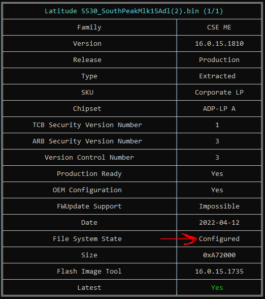

                    Latitude 5530 SouthPeakMlk15Adl
                    ​https://www.badcaps.net/donate

                          Re: Dell Latitude 5530 bios dump??
                          Originally posted by Pyareafzalmughal
                          i have same case dell logo comes and power off plz build my bios
                          This file is already "Configured", where's you Original Backup?
