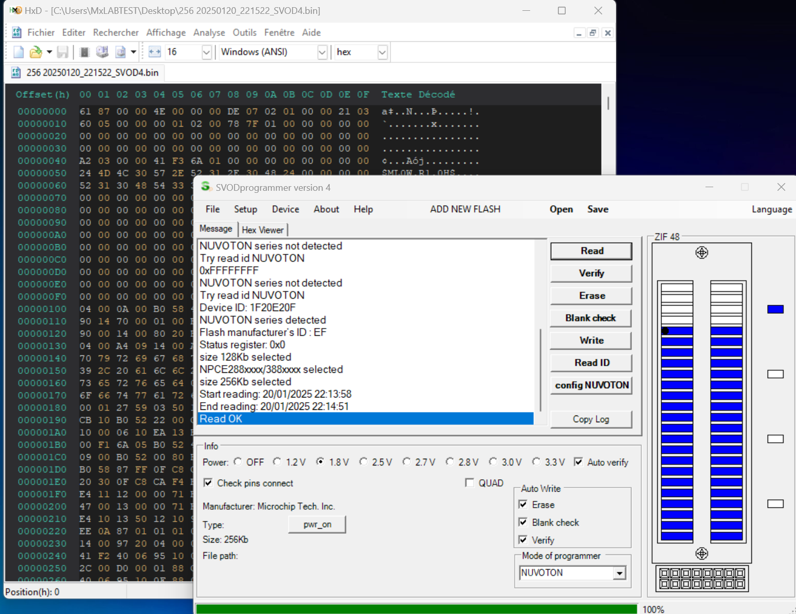

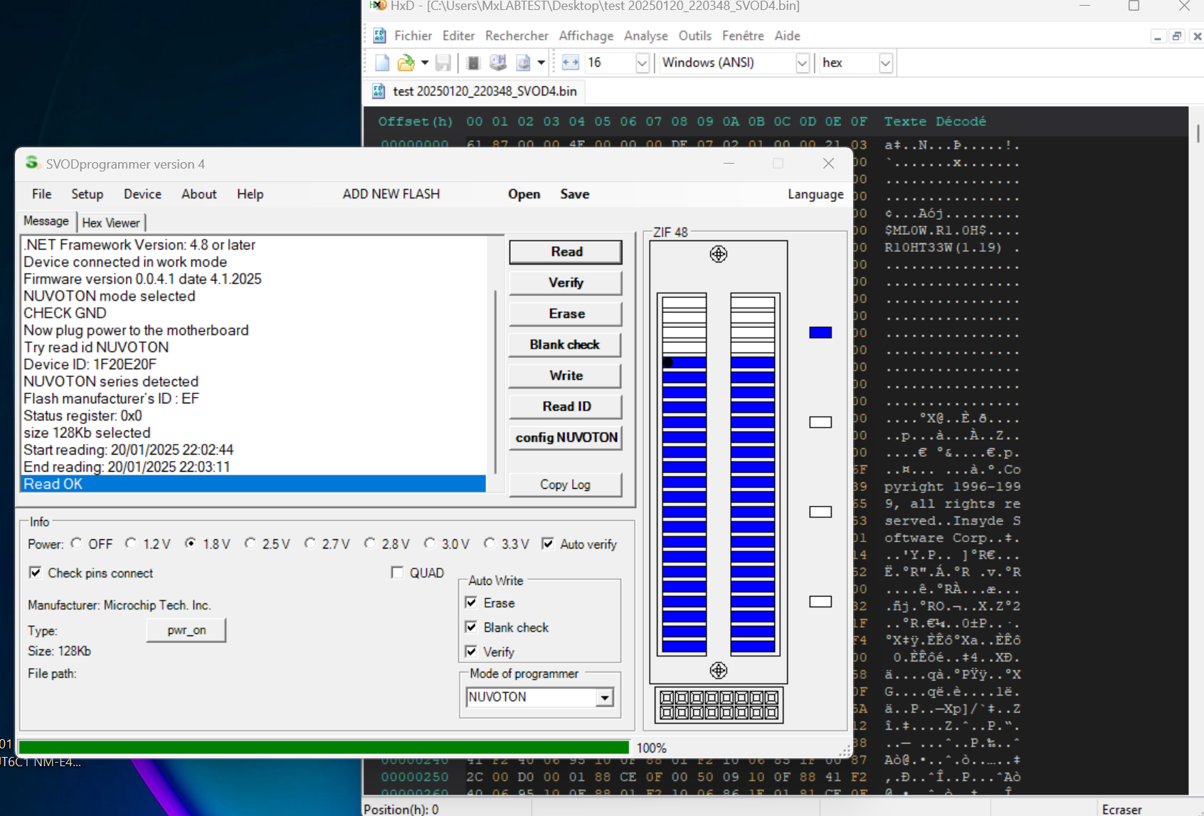

      I tried for you on L390 Intel. I think it's npce288. It worked perfectly
        Click image for larger version Name:	image.png Views:	0 Size:	487.0 KB ID:	3553109
        try to select 256Kb and see if reads 256Kb. I see you got the same ID as mine.

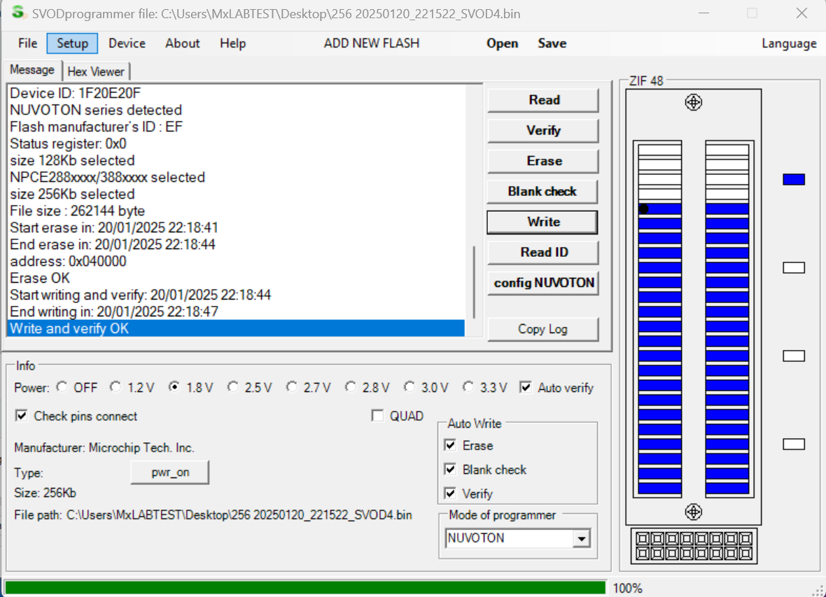

          Dead Click image for larger version
            no way! just because you selected 256Kb???
            • Maxpower3
              Bad Veteran
              • Feb 2018
              • 1372
              • France
              just after write, never rebooted with my original file in 256
              consumes a little 0.5/6 a few seconds, does things, the screen moves a little and after finished. I tried clean which I did with the Lenovo site the same. It worked before flash
              Edit I used an old version, and the same thing
              I didn't understand.
              But by long holding the power button and pressing it again,
              it restarted!
              I didn't understand why,
              it didn't start on its own. No CMOS or battery
              Click image for larger version  Name:	473633362_1152979846835799_6576057015072801552_n.jpg Views:	0 Size:	92.6 KB ID:	3553148
              I will try again with the new version
              double edit
              and now it works with new version and reboots alone.
              I don't understand anything anymore.
              the power button which was incorrectly placed and pressed alone therefore power off??​

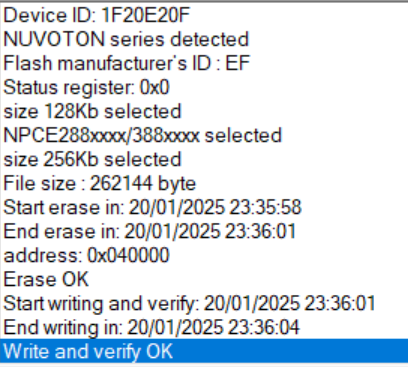

              • Maxpower3
                Bad Veteran
                • Feb 2018
                • 1372
                • France
                even I select 256Kb when I hit "read ID" it sets back to 128Kb
                Select 256 after read id
                Click image for larger version  Name:	image.png Views:	4 Size:	111.9 KB ID:	3553162Click image for larger version
                please SMDflea or others
                clean my pollution in thread. I still don't understand why it didn't work
                  I think the "culprit" is software update, I will try with an older version of software.
