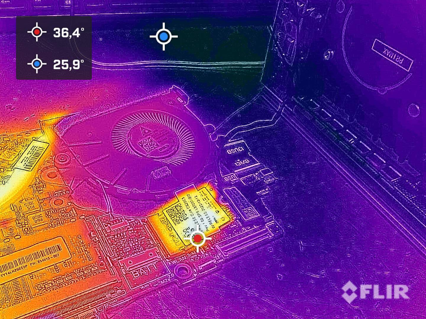

                    #30
                    Hello , Please repair bios
                    Power on, no screen, just fan spinning
                    SER : 5CG050BLJ3 830 G7 AX201NGW

                      #31
                      SSS

                          #33
                          Originally posted by hoaca388
                          SSS
                          Works, but in fact it's the wifi card that heats up and blocks startup.
                          It's broken.
