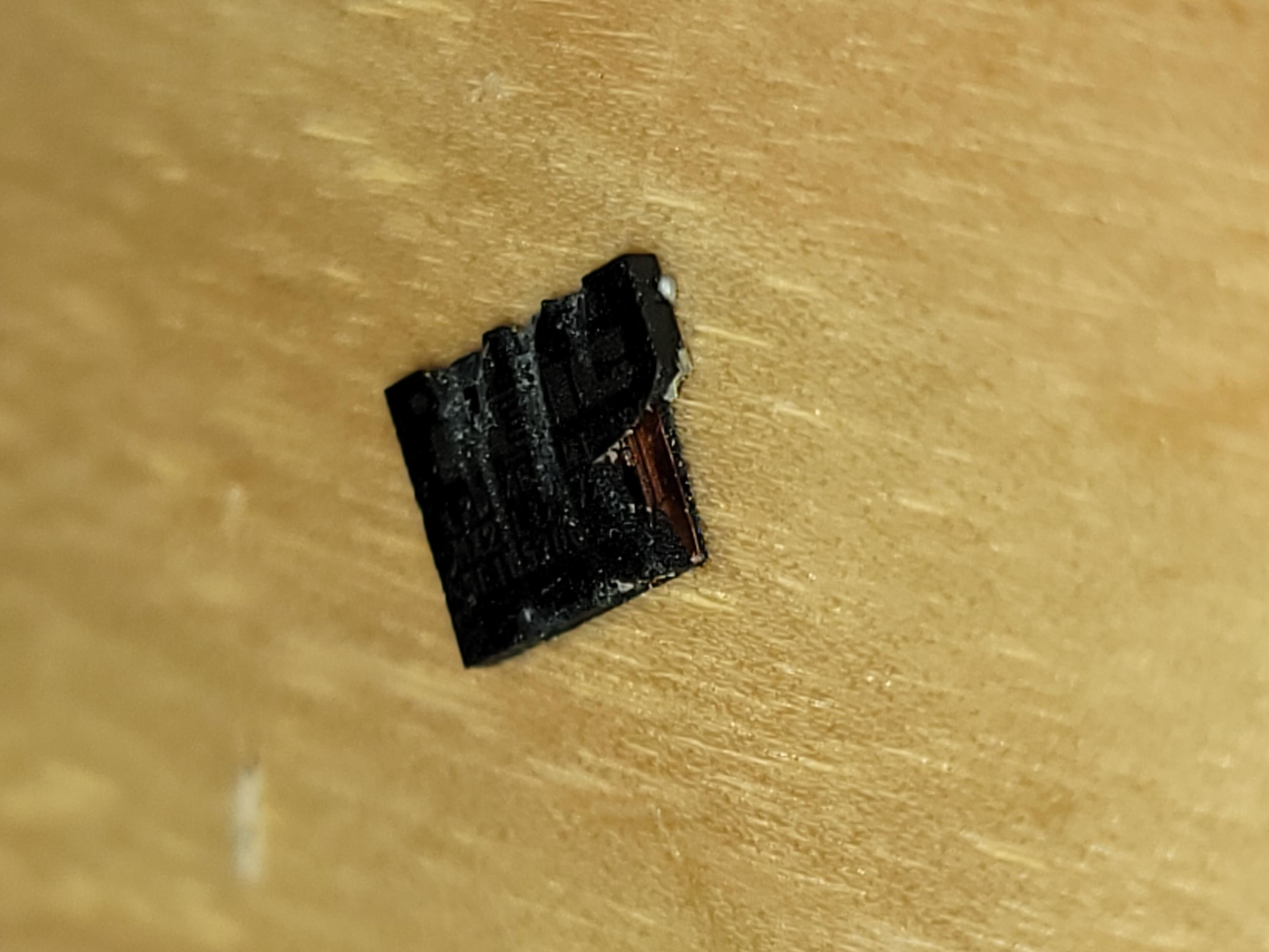

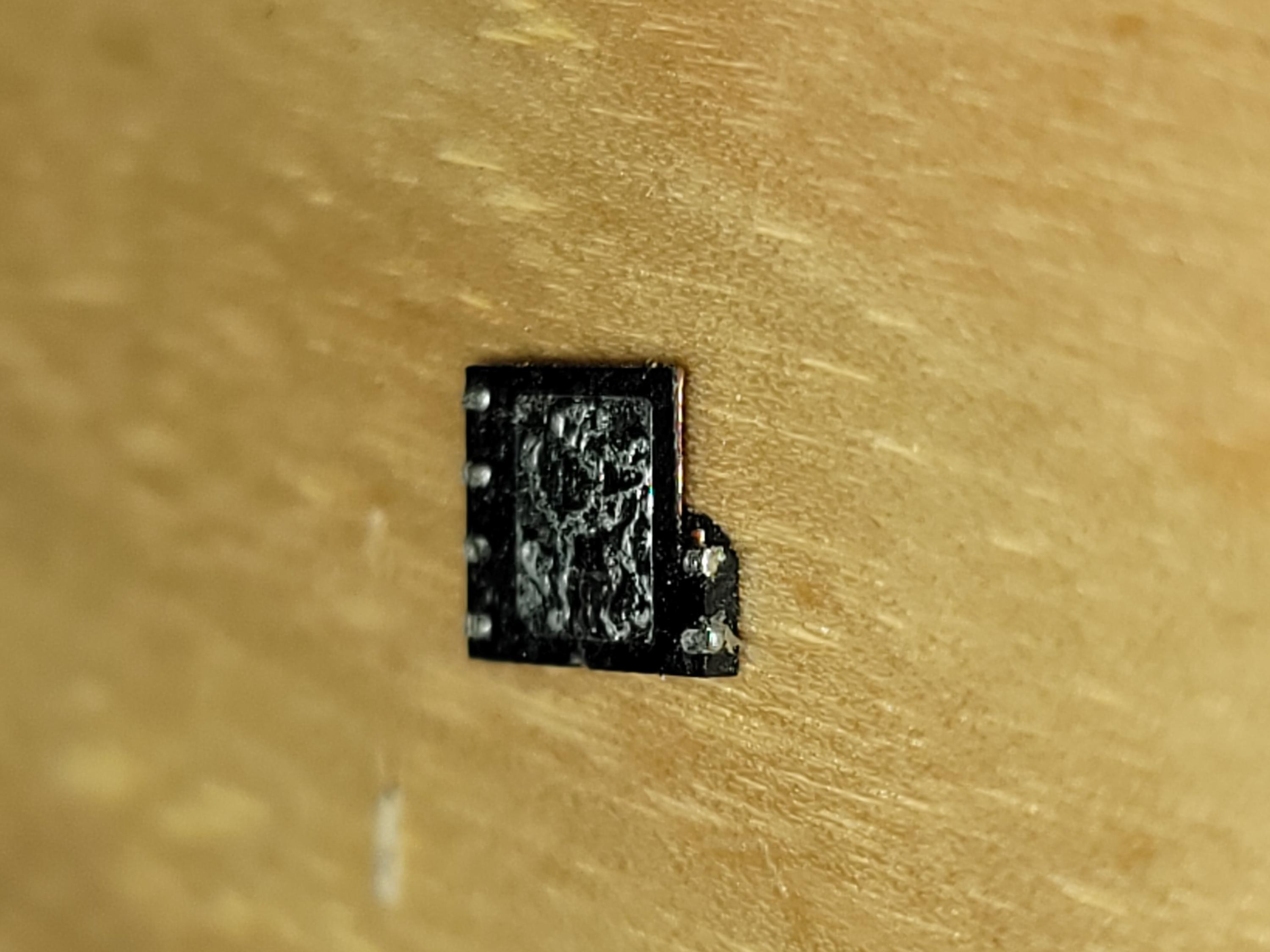

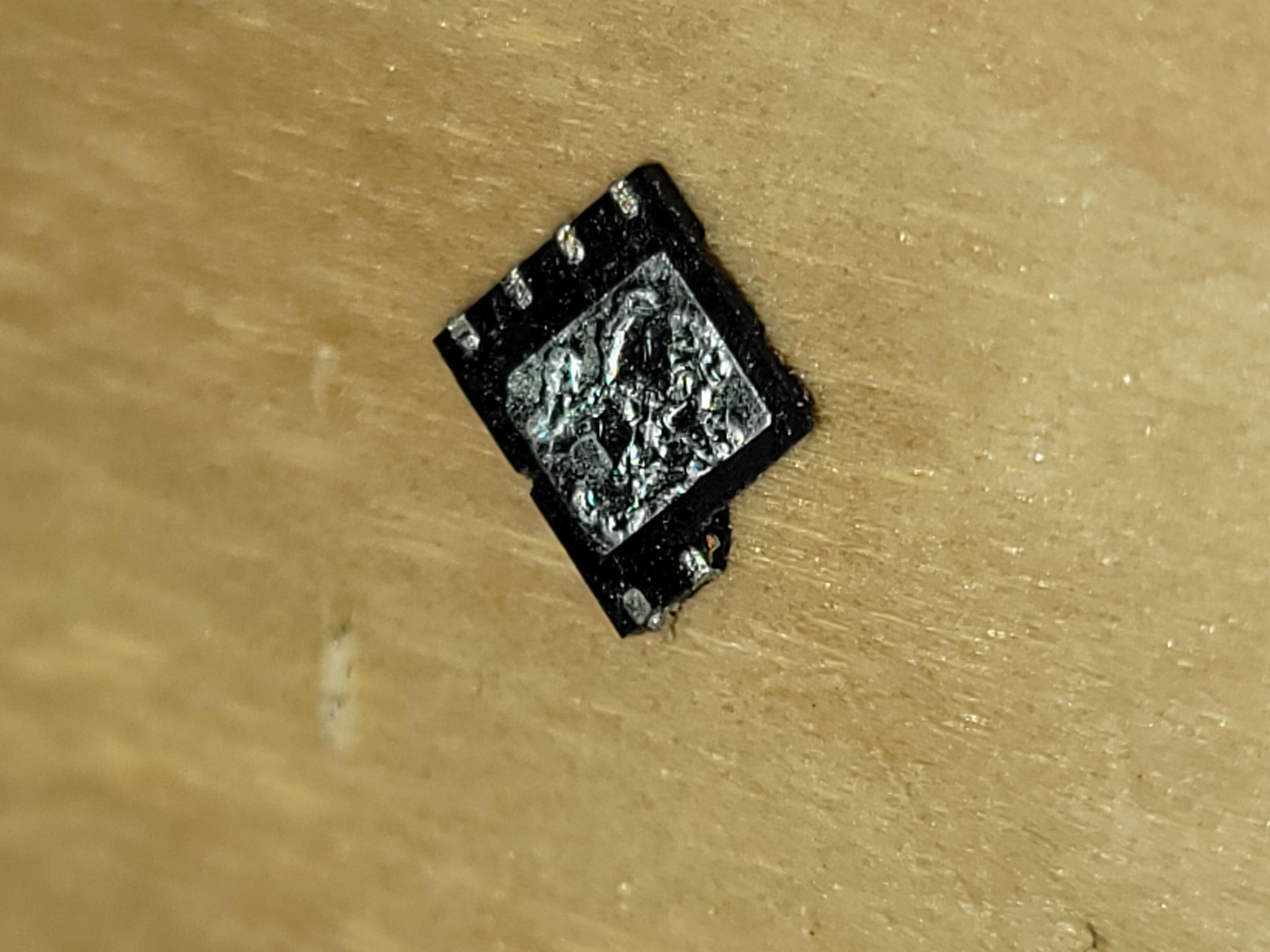

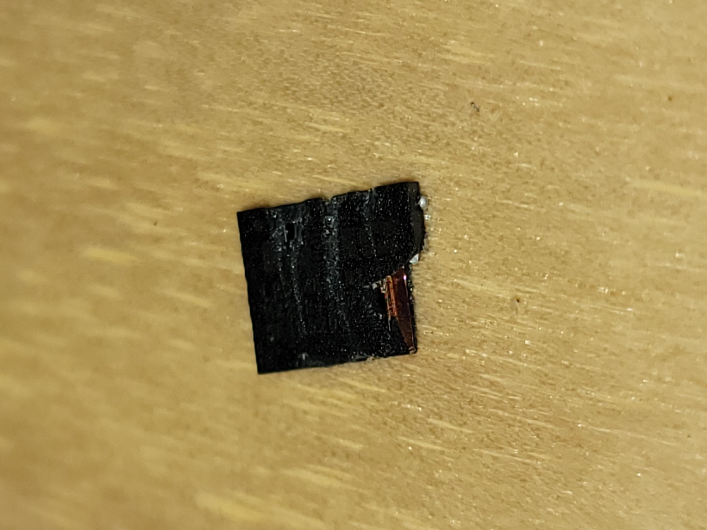

        The thing is, I accidentally ruined the wson chip while desoldering it, ordered a 8pin soip with the same features and now I need to put a new dump file on it. I don't have any backup dump from the previous. I read the new chip with programmer and works fine and its empty since its brand new from digikey. How do i proceed? thanks
        Attached are some pics of the old chip which is ruined.

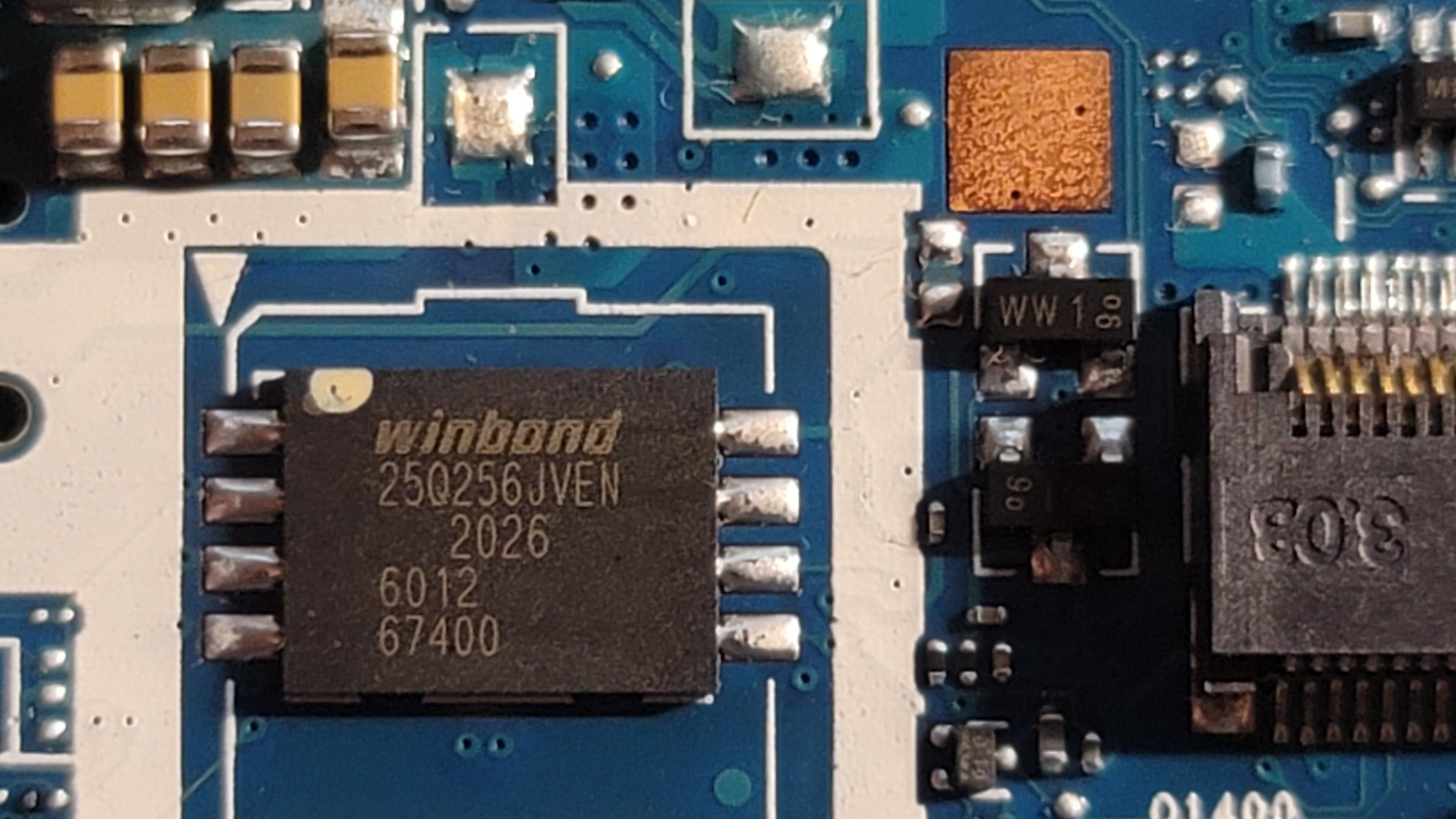

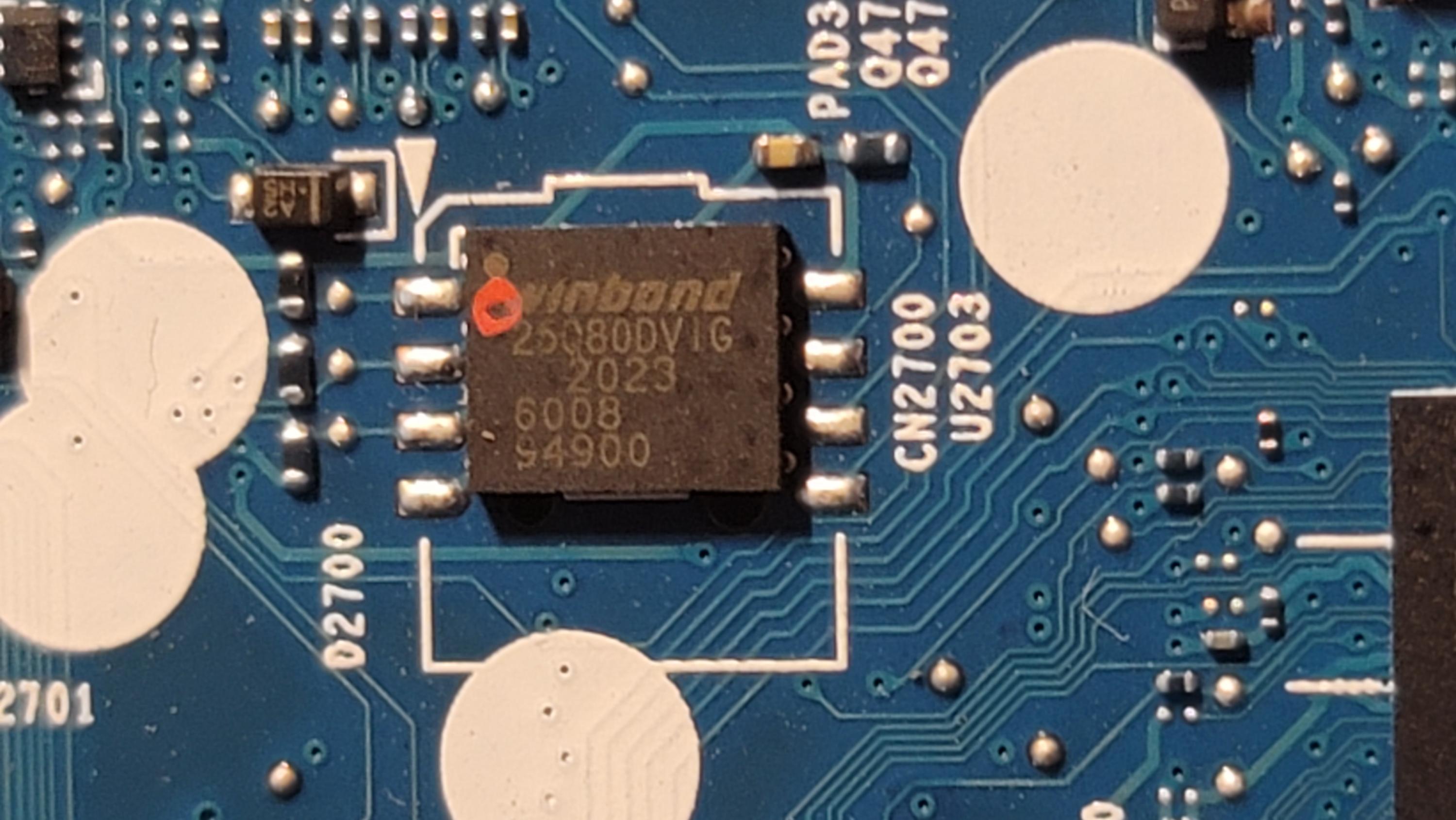

                        Hi, I am not quite sure which one is the EC chip, from this 2.
                        I know about the bios chip because i removed it last year but when it comes to EC chip it has to be this one with 256 on it, right? just wanted to double check. Here you have 2 picture of the 2 chips which I am not sure, one is in the front of the board, the other one is on the back.
                        • hoaca388
                          Badcaps
                          • Jan 2022
                          • 11784
                          Re: I need bios dump for Elitebook 830 G7
                          Originally posted by sophago
                          hi, i am not quite sure which one is the ec chip, from this 2.
                          I know about the bios chip because i removed it last year but when it comes to ec chip it has to be this one with 256 on it, right? Just wanted to double check. Here you have 2 picture of the 2 chips which i am not sure, one is in the front of the board, the other one is on the back.
                          256 -> 32 mb
                          128 -> 16 mb
                          • sophago
                            • Nov 2022
                            • 22
                            Originally posted by hoaca388
                            256 -> 32 mb
                            128 -> 16 mb
                            yep, makes sense. THNX
                            • hoaca388
                              Badcaps
                              • Jan 2022
                              • 11784
                              256 = 32MB
                              128 = 16MB
                              So it's not the 25Q80dvig chip
