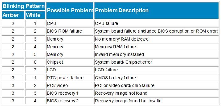

    Hello, I need bios for dell_g5 5587
    DDK51 DDK52 DDK53 LA-E994P REV 1.0, When I press the power button, I turn on the fan at maximum power without image, and the LED flashes 3 yellow pauses 1 time white and I tend to think that, It is a bios problem,thank you very much

    it's a cmos issue , try a new CMOS battery

          make a discharge , without charger , battery and cmos hold power button for 30 seconds , than change it by a new one .
          Upload your original bios file to try to clean me or fix it

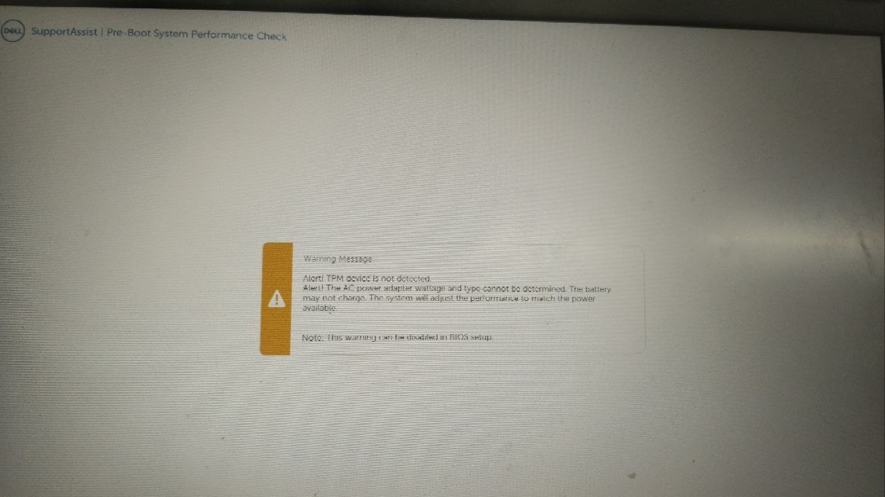

                Re: dell g5 5587 bios
                After I wrote this version,Dell G5 15 5587.rar it no longer starts dead
