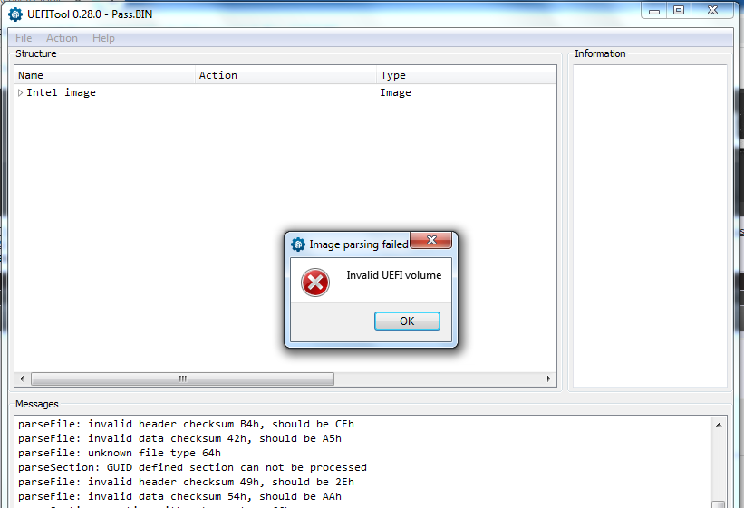

      Re: Bios unlock for DELL LATITUDE 7420
      Originally posted by lapfix
      Wait a few seconds
      I waited for more than 3 minutes to see if it will come up but it's still the same thing
        Try again with your original locked dumb and see if the lap is coming on
          Okay.

            #45
            I think my file is bad,i write it back and laptop is not turning on,i check the file on uefi tool and i get the invalid uefi volume error.
            I downloaded a file from this thread to compare,and i didn't get the error.
