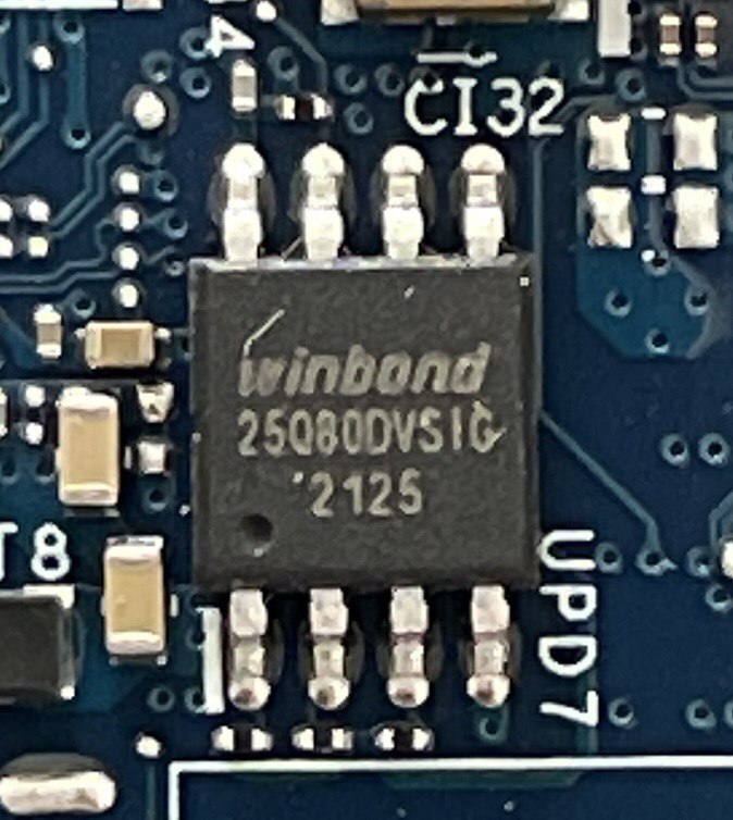

                  Sorry that's not the BIOS chip search for a chip with 256 on it. WSON8 chip

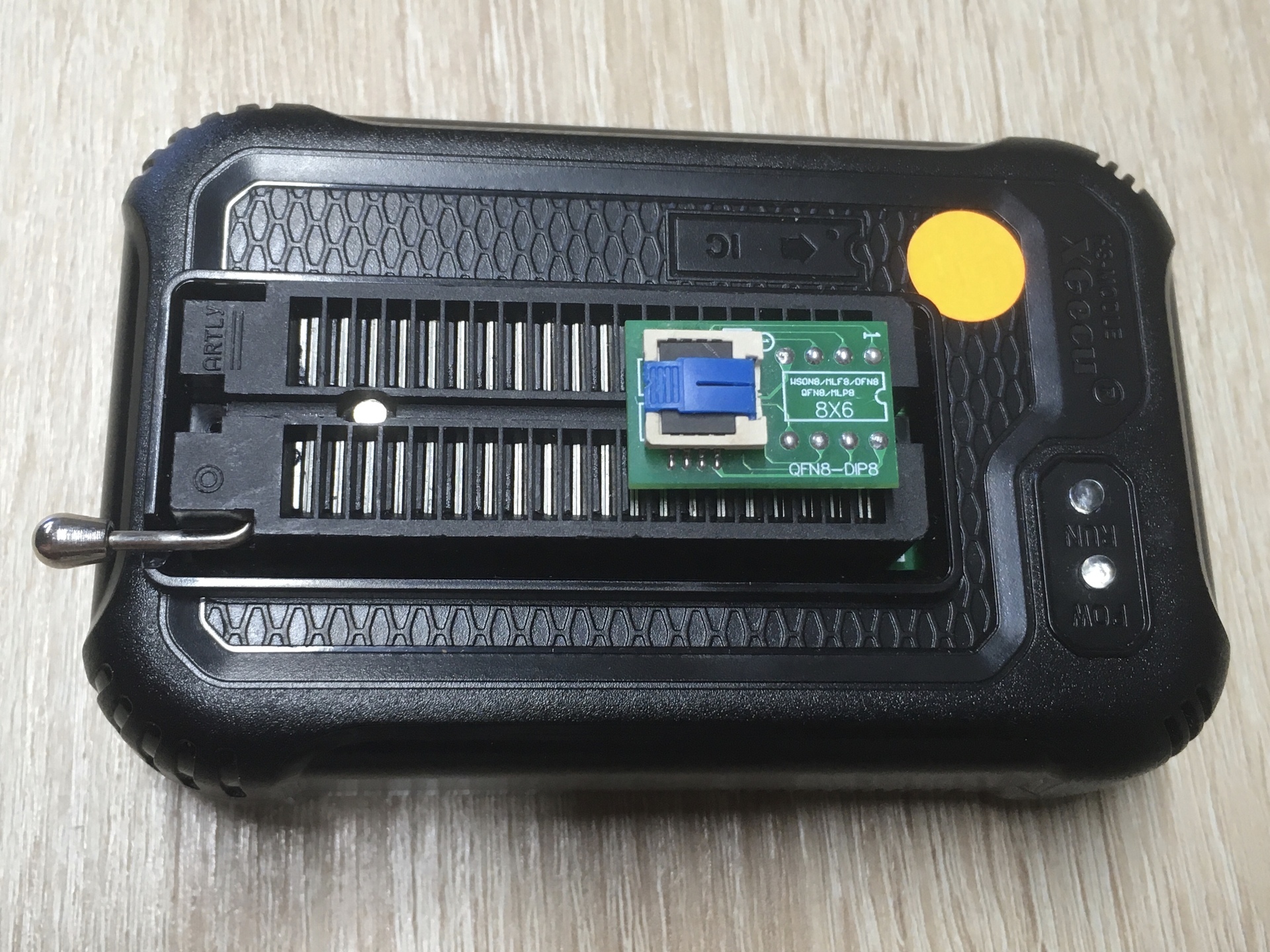

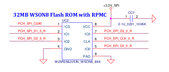

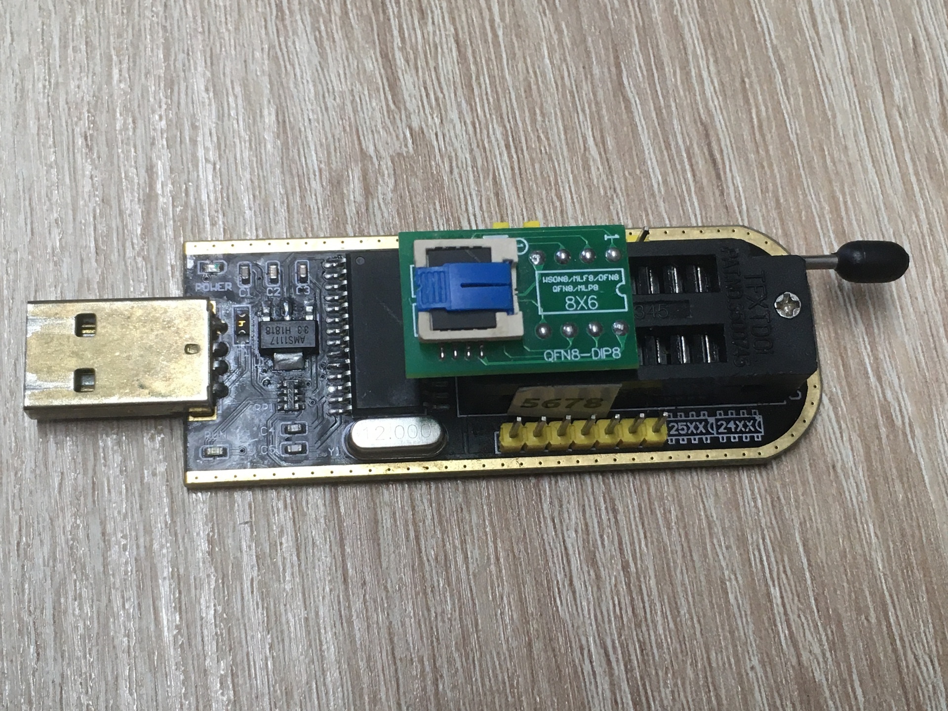

                      You need a backup of your UC2 32MB WSON8 chip and you have to de solder the chip.
                      Then you need an adapter to properly connect it to your CH341A programmer.
                      You need a decent program for your CH341A NeoProgrammer would be the choice.
                      And yes, I mean the chip on the motherboard, look for UC2, that is your BIOS chip.
                      • Markus1741
                        • Sep 2020
                        • 994
                        • N/A
                        #191

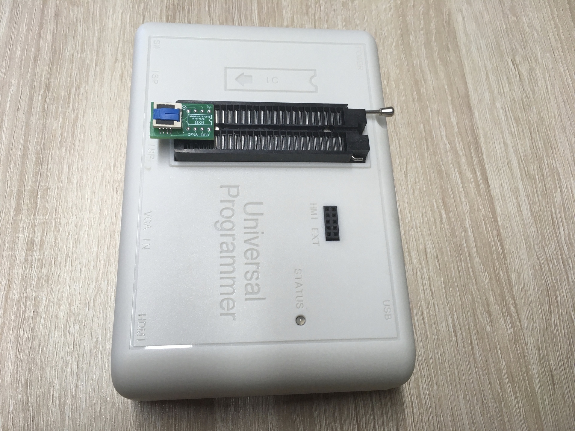

                        The minimum should be CH341A + 8x6 adapter, the other two also bring their own software.
                        The RT809H is the most expensive but also worth the money.​

                          thank you for your kindly answer. I have CH321A Programmer and NeoProgrammer but my Hot Gun is defect. I will try to fix it.

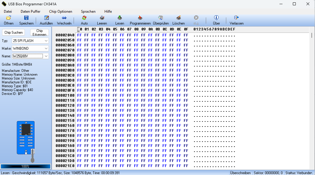

                                  my reading I was able to read/write chip 25rh256cxiq the Dell 5420. I used:
                                  1. Ch341A programmer;
                                  2. Software NeoProgrammer V2.2.0.10 (select chip W25Q256FV).
                                  SiberiaProg CH341A v1.45 detect ic XM25QH265B
                                  XGecu TL866 Plus not reading
                                  Hellp unlock
