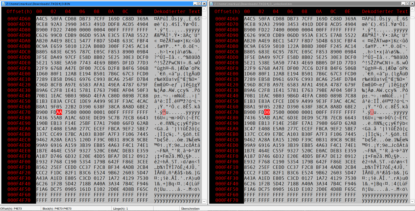

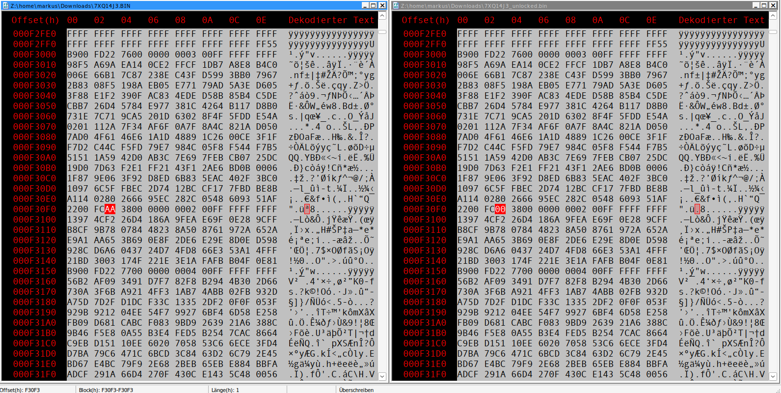

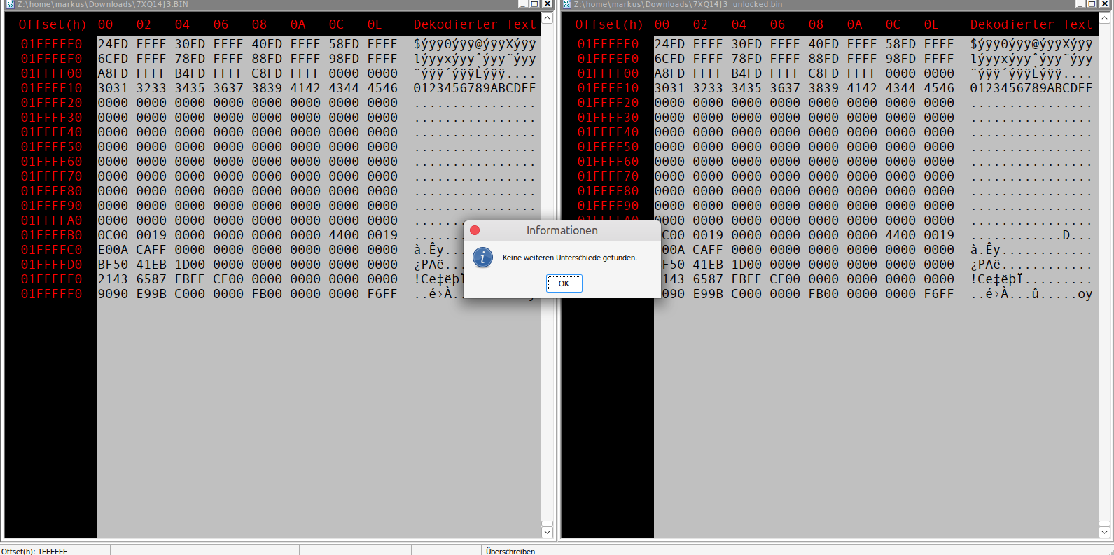

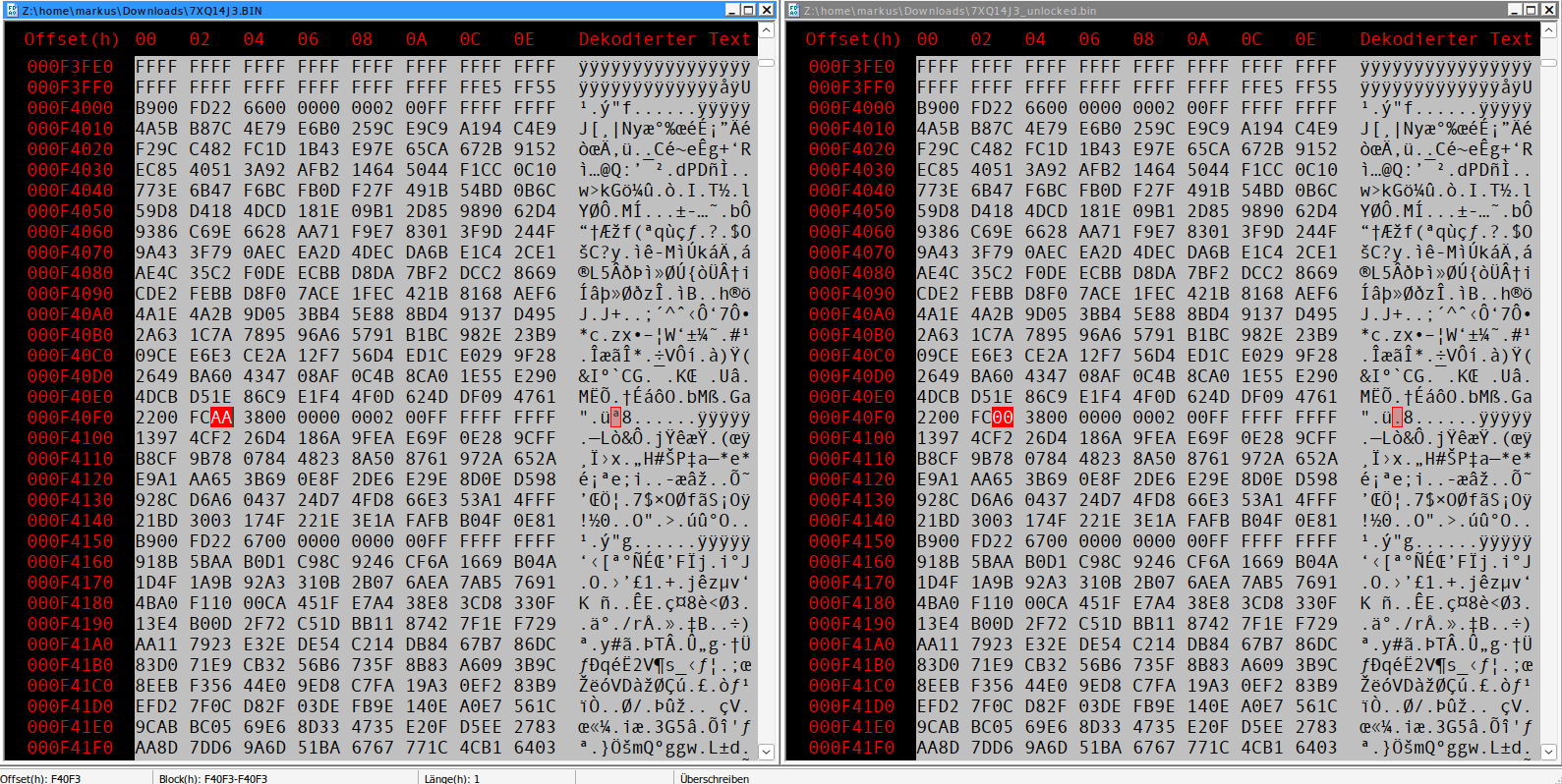

                  Hello, I'm sorry that it didn't work for you, I would like to tell you what I did using the pictures.
                  In the HxD Editor I added 00FCAA **00 0000 and 00FDAA ** 0000 and replaced the value AA with 00.
                  I didn't edit your original BIOS file any further.
                  Now I don't know what the very experienced user (minhdigital) edited.
                  In comparison, I saw that he does much more.
                  Only he knows that for sure.
                  I then always wait until I get into the BIOS after starting it several times with F2, then I insert the service tag and that should be it.
                  Maybe you'll have better luck with the new file.
                  Good luck​
