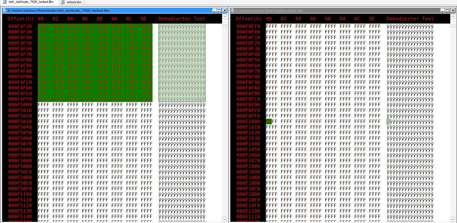

            • Markus1741
              • Sep 2020
              • 994
              • N/A
              #267
              Originally posted by Julian Bailey
              What do you mean sorry?
              Hello you need WSON8 chip under Intel WiFi card the place called UC2
              You upload the Thunderbolt chip content.

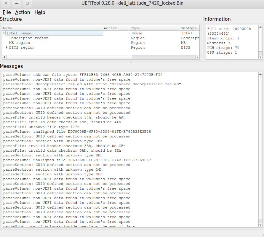

                    • Markus1741
                      • Sep 2020
                      • 994
                      • N/A
                      #271
                      Ok so Ive pulled the BIOS off the BIOS chip by UC2, see attached.
                      If someone can take a look and unlock it that would be great.
                      Service tag: 28SH0F3
                      Make / Model: Dell Latitude 7420
                      Motherboard is an i5 11th Gen, 8GB RAM
                      Motherboard model: GDC31 LA-K371P Rev:3.0 (A02)
                      Sorry but your uploaded file is corrupt try again ...

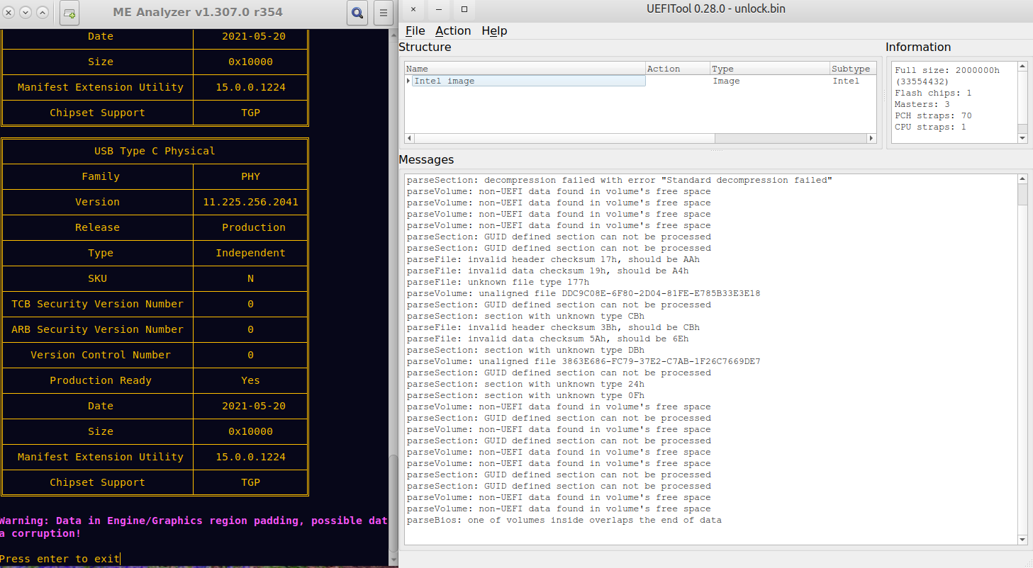

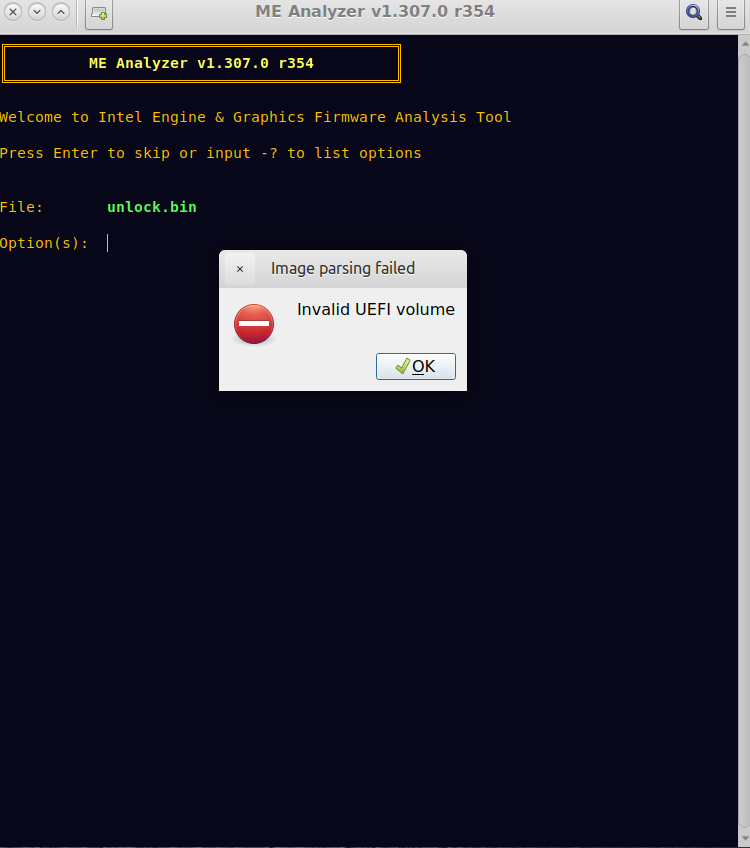

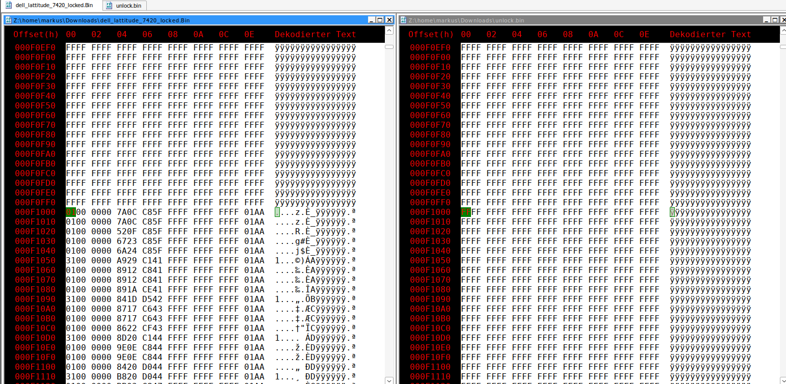

                          • Markus1741
                            • Sep 2020
                            • 994
                            • N/A
                            #274
                            What is the point of creating an unlock file from a corrupted BIOS?
                            And then probably with deleting 000F100 – 000F4FF0 (h): 4000
                            Why not with 00FDAA 00FC00
                            I know on YouTube ********** offers an .exe that does this automatically.
                            I also know that it works on a Dell 5400, but it doesn't work on many newer models.
                            If the user writes this file to his notebook he cannot use it and it will no longer start.
                            Maybe SMDFlea should please take a look at this kind of behavior.
