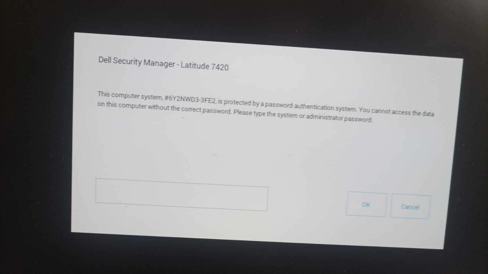

                    #469
                    anyone please remove bios password for dell latitude 7420, thank you

                      #470
                      post S/T, full name and model, motherboard model, ,etc.

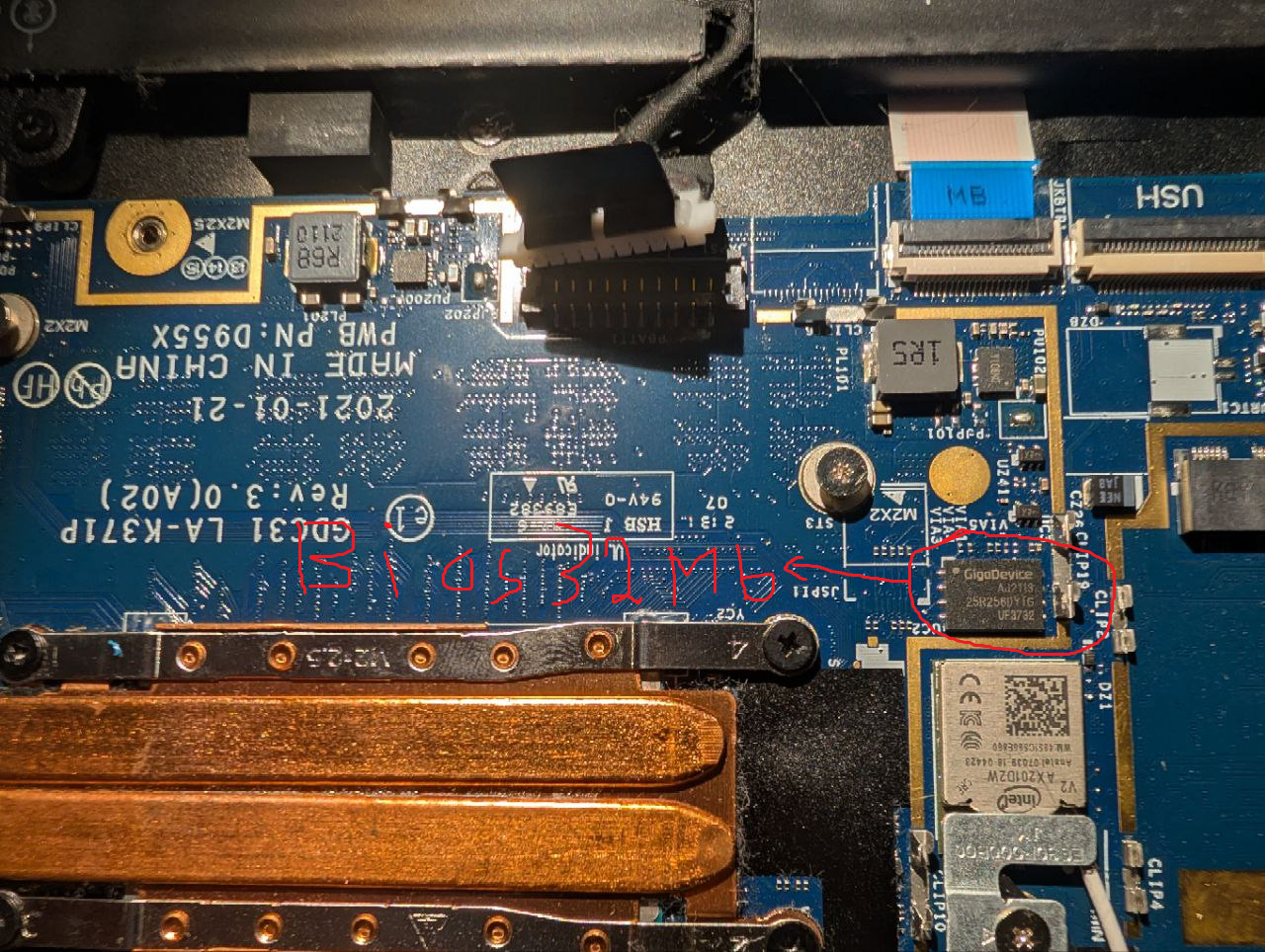

                        Is there any way to reset my BIOS Chip? Its a Winbond 25Q80DV SIG 2128.
                        I don´t have a clean bios bin. the attached bin is my backup.
                        If i erase the chip and boot the Notebook its Password protected again.
                        Can someone tell me whats the Problem?

                              bios dell 7420 ---SIZE 32Mb ---25Q256-GD256---XM256.. NOT 1 Mb

                                What am i doing wrong? I tried AS Programmer and Neo Programmer, everytime i get 1 Mb bin files.

                                  bios 32Mb

                                    O.k. Thx, Then I have to desolder the chip. My clamp doesn't fit on it.
