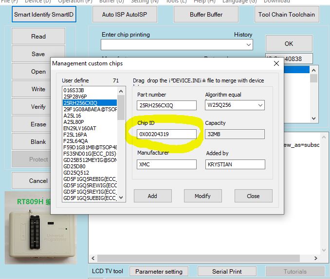

    Morning guys have anyone come across dis bios chip XMC 25RH256CXIQ it's not listed in the programmer and i hve the latest software and is not found cant be detected

            Choose a different chip instead and untick the Check-ID box .You might have to untick verify as well
            W25Q256FV @SOIC8
            If you want full support adding send them an email - http://www.autoelectric.cn/en/ContactUs.html
            EDIT: Support was added on Date : 3.05th.2022 http://www.autoelectric.cn/MiniPro/TL866II_List.txt

                Hello guys I also got a laptop with the XMC 25RH256CXIQ and the chip is not supported my programmer is RT809H. I have tried to add the chip manually but it can't read the firmware from the chip

                    I have read the xmc 25rh256cxiq on my RT809H with no problems and wrote on it as well

                      i cant read it on RT809H and TL866II

                          Rt809f reads and writes without problem
                          enter correct id and it works ok

                            hi i have RT809F with last update 20221212 i cant read XMC25RH256CXIQ not in list i use MX25L25635E but dump is not working can you help mais plz

                                Support list: https://www.hklrf.com/24download/img/RT809F-List2.txt
                                Software: http://doc.ifix.net.cn/@rt809/ENGLISH.html
                                See post #13 to change the chip ID .

                                  I'm also unable to read out this chip using RT809F
                                  Can somebody tell how can you read out this chip?
                                  These are getting very common in Dell 11th gen laptops...

                                    Did you read post #13 ,maybe that will work.

                                        Confirmed.software needs to be restarted.
