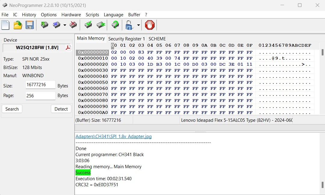

                                  • marknolan
                                    • Feb 2025
                                    • 6
                                    • Ireland
                                    #39
                                    Just adding a few notes around the bigger picture since I don't see it in the discussion:
                                    1. I read the old BIOS using a CH341B with an IC clip and a I.8V adaptor.
                                    2. The IC clip is finicky. Many reads/write failed until I positioned this correctly.
                                    3. I used Neoprogrammer to program the BIOS with the new image. To achieve that I had to autodetect the device type and select the 1.8v option. I also had to tick unprotect, blank etc. on the write menu. AsProgrammer didn't work for me. Perhaps I did something wrong.
                                    4. HxD hex editor is handy for comparing the supplied file with the one I read back from the BIOS after programming.
                                    • peste
                                      • Dec 2016
                                      • 13625
                                      • ROMANIA
                                      #40
                                      The bios chip must be unsoldered from the board before writing or reading..
                                      do not use the clip, you may have errors..if you do not have anything to unsolder it with,
                                      solder wires between the programmer and the bios chip..
                                      here is a video for example..https://www.youtube.com/watch?v=DWWi...nnel=ThisIsHow
