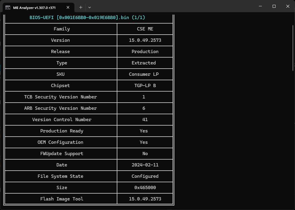

Lenovo ThinkBook 14 G2 ITL FLV34 LA-K051P bios
  • g16pp1
    replied
    Originally posted by m1ch43lzm
    Couldn't find password in your BIOS unlike previous BIOSes in this thread, try flashing clean BIOS + DMI/Win key inserted
    ThinkBook 14 G2 ITL Laptop - Type 20VD
    BIOS ver F8CN41WW
    S/N MP21G3XE
    MTM 20VD000AFR
    DMI 20000-207FF (on 16MB file)
    Win key 92000-9203F
    Flash only the 16MB chip if you only want to remove password, the 8MB chip contains Intel ME region; full BIOS is 24MB split in 2 chips 8MB+16MB, if your laptop boots fine not needed to flash 8MB (clean ME), I'm uploading it in case someone needs that version
    F8CN41WW 16MB g16pp1.rar
    Thank you very much for your files, it did work flawlessly only flashing the 16MB chip! 😎
    Leave a comment:
  • m1ch43lzm
    replied
    Originally posted by g16pp1
    Any chance someone can help me removing system password from attached bios+ec dumps please?
    Lenovo Thinkbook 14 G2 ITL
    S/N MP21G3XE
    FLV34 LA-K051P Rev: 1B
    Also, could you please teach us how to find passwords or patch these bios?
    Thank you for your help1 πŸ™‚
    Couldn't find password in your BIOS unlike previous BIOSes in this thread, try flashing clean BIOS + DMI/Win key inserted
    ThinkBook 14 G2 ITL Laptop - Type 20VD
    BIOS ver F8CN41WW
    S/N MP21G3XE
    MTM 20VD000AFR
    DMI 20000-207FF (on 16MB file)
    Win key 92000-9203F
    Flash only the 16MB chip if you only want to remove password, the 8MB chip contains Intel ME region; full BIOS is 24MB split in 2 chips 8MB+16MB, if your laptop boots fine not needed to flash 8MB (clean ME), I'm uploading it in case someone needs that version
    F8CN41WW 16MB g16pp1.rar
    Leave a comment:
  • volinakis
    replied
    Originally posted by m1ch43lzm
    Yes really, extract the f8cn59ww.exe from Lenovo website with innoextract, then extract the second F8CN59WW.exe with platomav's BIOSUtilities from github, you'll get a 24MB .bin that has to be split
Name:	Captura de pantalla 2025-09-27 180459.png
Views:	140
Size:	19.4 KB
ID:	3734387
    again, thank you for sharing with me your wisdom ... let's see when I did what you do now ... I think 4 years ago ...
Name:	Screen Shot 2025-10-05 at 01.14.40.png
Views:	131
Size:	145.5 KB
ID:	3739075
    Leave a comment:
  • g16pp1
    replied
    Any chance someone can help me removing system password from attached bios+ec dumps please?
    Lenovo Thinkbook 14 G2 ITL
    S/N MP21G3XE
    FLV34 LA-K051P Rev: 1B
    Also, could you please teach us how to find passwords or patch these bios?
    Thank you for your help1 πŸ™‚
    Leave a comment:
  • n40mail
    replied
    Originally posted by m1ch43lzm
    volinakis No need to use FIT to clean ME on this one, just extract the BIOS from Lenovo website and split the 24MB file, first 0x800000 go to the 8MB chip, it contains Descriptor+ME region (already "Configured"), the rest 0x1000000 goes to 16MB chip
    n40mail try this
    ThinkBook 14 G2 ITL Laptop - Type 20VD
    BIOS ver F8CN59WW
    S/N MP255LNT
    MTM 20VD003BRU
    DMI 20000-207FF (on 16MB file)
    Flash both 8MB (64) and 16MB (128) chips
    Hello!
    Thank you for your help. I'll try to flash the BIOS in a week.
    Best regards, Alex.
    Leave a comment:
  • n40mail
    replied
    Originally posted by elariz
    its clean me region
    working 100%
    The attachment is corrupted.
    Leave a comment:
  • m1ch43lzm
    replied
    Yes really, extract the f8cn59ww.exe from Lenovo website with innoextract, then extract the second F8CN59WW.exe with platomav's BIOSUtilities from github, you'll get a 24MB .bin that has to be split
Name:	Captura de pantalla 2025-09-27 180459.png
Views:	140
Size:	19.4 KB
ID:	3734387
    Leave a comment:
  • volinakis
    replied
    Originally posted by m1ch43lzm
    volinakis No need to use FIT to clean ME on this one, just extract the BIOS from Lenovo website and split the 24MB file, first 0x800000 go to the 8MB chip, it contains Descriptor+ME region (already "Configured"), the rest 0x1000000 goes to 16MB chip
    really? But thanks for teaching me, I'd be lost without you!
Name:	Screen Shot 2025-09-28 at 00.03.40.png
Views:	94
Size:	74.1 KB
ID:	3734296
    Leave a comment:
  • m1ch43lzm
    replied
    volinakis No need to use FIT to clean ME on this one, just extract the BIOS from Lenovo website and split the 24MB file, first 0x800000 go to the 8MB chip, it contains Descriptor+ME region (already "Configured"), the rest 0x1000000 goes to 16MB chip
    n40mail try this
    ThinkBook 14 G2 ITL Laptop - Type 20VD
    BIOS ver F8CN59WW
    S/N MP255LNT
    MTM 20VD003BRU
    DMI 20000-207FF (on 16MB file)
    Flash both 8MB (64) and 16MB (128) chips
    Leave a comment:
  • volinakis
    replied
    Originally posted by n40mail
    Hello, Volinakis!
    Thank you for your help. The fact is that the symptoms are the same before and after flashing. I also compared the BIOS files in "WinHex". The only difference is between the "U29" files. The "UC12" files are the same (please see the attachment). Maybe "UC12" was accidentally sent the same one?
    Best regards, Alex.
    nope, I used intel flash image tool to fix ME Region and bios image was split by the software.
    Leave a comment:
  • n40mail
    replied
    try. write both chipsets.
    Hello, Volinakis!
    Thank you for your help. The fact is that the symptoms are the same before and after flashing. I also compared the BIOS files in "WinHex". The only difference is between the "U29" files. The "UC12" files are the same (please see the attachment). Maybe "UC12" was accidentally sent the same one?
    Best regards, Alex.
    Leave a comment:
  • volinakis
    replied
    Originally posted by n40mail
    I have a Lenovo ThinkBook 14 G2 ITL that is not working correctly and I suspect a corrupted BIOS. I would greatly appreciate your expertise in helping me repair my BIOS dump file.
    Laptop Details:
    Model: Lenovo ThinkBook 14 G2 ITL
    Motherboard Model: FLV34 LA-K051P REV:1B
    Serial Number (S/N): MP255LNT
    MTM (Machine Type Model): 20VD003BRU
    Problem Description:
    The laptop has a black screen on power-up. The power LED lights up, and the fans spin, but there is no display on the screen . I have tried basic troubleshooting like reseating RAM, trying different RAM, and connecting an external monitor, pressing power button within a 60 sec etc, but the issue persists.
    Thank you in advance, Alex.
    try. write both chipsets.
    Leave a comment:
    commented on 's reply
    Thread merged.
  • n40mail
    replied
    I have a Lenovo ThinkBook 14 G2 ITL that is not working correctly and I suspect a corrupted BIOS. I would greatly appreciate your expertise in helping me repair my BIOS dump file.
    Laptop Details:
    Model: Lenovo ThinkBook 14 G2 ITL
    Motherboard Model: FLV34 LA-K051P REV:1B
    Serial Number (S/N): MP255LNT
    MTM (Machine Type Model): 20VD003BRU
    Problem Description:
    The laptop has a black screen on power-up. The power LED lights up, and the fans spin, but there is no display on the screen . I have tried basic troubleshooting like reseating RAM, trying different RAM, and connecting an external monitor, pressing power button within a 60 sec etc, but the issue persists.
    Thank you in advance, Alex.
    Leave a comment:
  • twonk9098
    replied
    Thanks again M1ch43lzm, works a treat. Total legend!!
    Kind regards
    Leave a comment:
  • twonk9098
    replied
    Thank you, will update you.
    Many thanks for your help.
    Leave a comment:
  • m1ch43lzm
    replied
    8MB BIOS chip has ME region, the 16MB has the BIOS-UEFI region, I already added your DMI+Win key there
    Leave a comment:
  • twonk9098
    replied
    Thank you, which file (8 or 16mb) do I replace the DMI / Win information?
    Many thanks
    Leave a comment:
  • m1ch43lzm
    replied
    Try, BIOS extracted from Lenovo website
    ThinkBook 14 G2 ITL Laptop - Type 20VD
    BIOS ver F8CN59WW
    S/N MP1YGF4K
    MTM 20VD000AUK
    DMI 20000-207FF (on 16MB file)
    ​Win key 92000-9203F (on 16MB file)
    Last edited by m1ch43lzm; 09-23-2025, 12:44 PM.
    Leave a comment:
  • twonk9098
    replied
    Sorry, the laptop serial number is MP1YGF4K.
    I note though that using a previous bios uploaded in this thread for someone else, I replaced the 128mb and 64mb bios's and the serial number within the Bios has not changed. Is this right?
    Thank you
    Leave a comment:
  • Wahaz
    by Wahaz
    10-30-2023, 08:42 PM
  • lucaszmn
    Summary of BIOS Whitelist Removal Problem Lenovo Thinkpad T560
    by lucaszmn
    Summary of BIOS Whitelist Removal Problem
    Problem:
    I am attempting to remove the WWAN card whitelist from my Lenovo ThinkPad T560.
    Initial Findings:
    • My current BIOS version is N1KET58W (1.45).
    • I have a CH341A programmer and have successfully created two full backups of my BIOS.
    • I have the ability to use command-line tools on a Linux machine.
    Troubleshooting Steps & Conclusions:
    • I attempted to use several automated and manual patching methods on my N1KET58W (1.45) BIOS, including using hex strings. These attempts all failed.
    • I concluded that the
    08-12-2025, 03:01 PM
  • TecnicaNTT
    Lenovo Thinkbook 16P G2 ACH - BIOS Serial number missing
    by TecnicaNTT
    I got a Lenovo Thinkbook 16P G2 ACH on the bench with a botched BIOS (somehow my client blanked it). I restored the laptop and got it up and running with original BIOS from Lenovo Support website.
    My problem is now that the machine details are missing in the BIOS (Serial Number, MTM, etc.)
    I tried to write the details with the Lenovo Uone Tool but had now luck. It is giving me an error: "ERROR: Locate protocol with LenovoEeprom, Status=[e]. EEPROM fail when reading or writing data."
    I am now asking here for help if anyone knows how to do this in...
    09-20-2024, 08:10 AM
  • grimacelord
    Lenovo Legion T5-26AMR5 Desktop - Corrupt BIOS
    by grimacelord
    Hello there.
    I am working on a Lenovo Legion T5-26AMR5 desktop that currently has a corrupt BIOS and I have been unsuccessful thus far in trying to fix it myself.
    History:
    1. This computer came to me initially with an error message that said "BiInitializeLibrary failed 0xc0000001" or "0135 fan error". It would always be one of the two errors. It should be noted that when it produced the fan error, there was no physical problem with the fans. They were all spinning just fine.
    I searched for this error online and discovered...
    03-15-2023, 03:29 PM
  • dvt1989
    Need help bios Lenovo Thinkbook 16 GEN 7
    by dvt1989
    I need new bios for Lenovo Thinkbook 16 GEN 7. Old bios not detect 20V.
    Main code: 233063-1M
    SN: PW0E1F0Q
    Tks for help so much....
    09-03-2025, 01:25 AM
