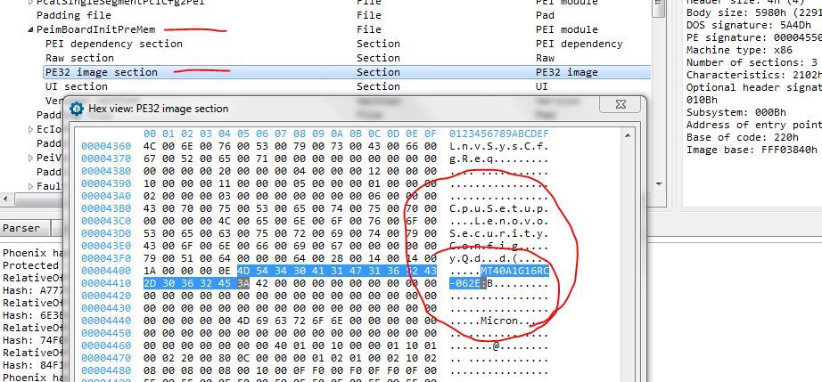

        #323
        Spd removal tool finds 16 to remove. Probably not all need to be removed. Anyone knows wich should i mark ?

          #324
          Originally posted by pirih77
          I just checked and there is no difference between this file and the one made by spd removal tool. The hexer script for ram removal also makes the same file.
          Removing only the SPD entries isn`t going to work. There`s lots more to it, it`s complicated. The ram part numbers are in the premem PEI sections. I don`t think that filling the names with 00`s would work either.
