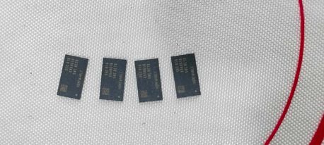

                      Lenovo IdeaPad 3 15IML05 81WB GS452 GS552 GS752 NM-C781 Rev 1.0 Ram Disable
                      i remove ram ic i send u my backup please disble ram by editing my backup bois.

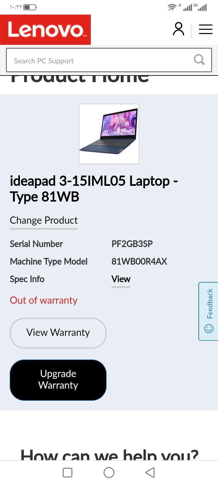

                      #153
                      Serial Number
                      PF2GB3SP
                      Machine Type Model
                      81WB00R4AX

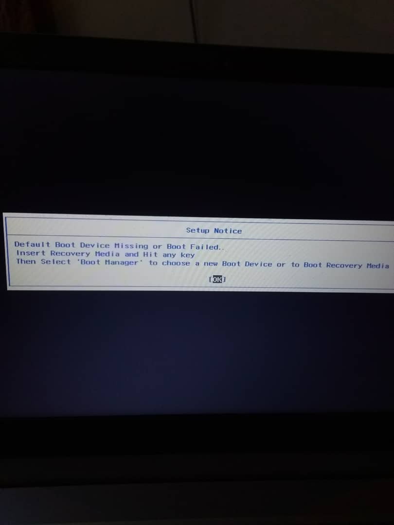

                        #154
                        i flash bois from here
                        https://www.badcaps.net/forum/troubl...-nm-c781/page2
                        missing boot missing ssd

                          You are making problems for yourself. The bios you posted is the original one, i checked the serial "PF2GB3SP" ,why mess with another bios ? did you even check if its the right version,is the ME firmware clean, did you copy the DMI from your backup ? .Just use the RAM patcher on your original bios and try it

                              81WB00R4AX​
                              this bin file working and display but missing boot after restart missing ssd
                              i remove ic internal ram i cant editing bois
