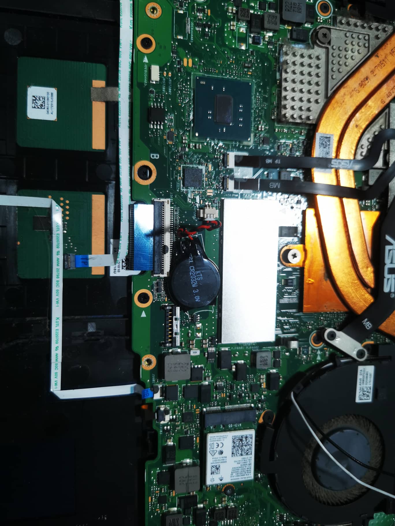

    please help. need bios bin badly

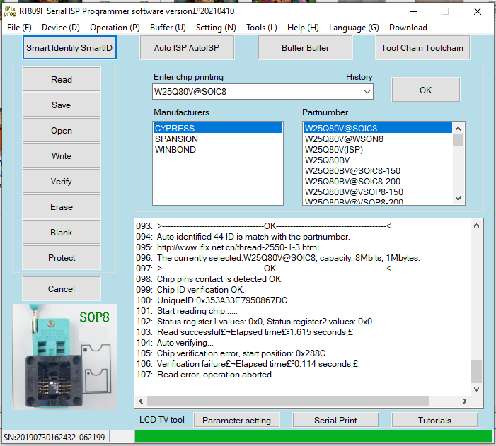

      Re: ASUS ZenBook Pro UX550V Bios bin
      it cannot be read it always failed

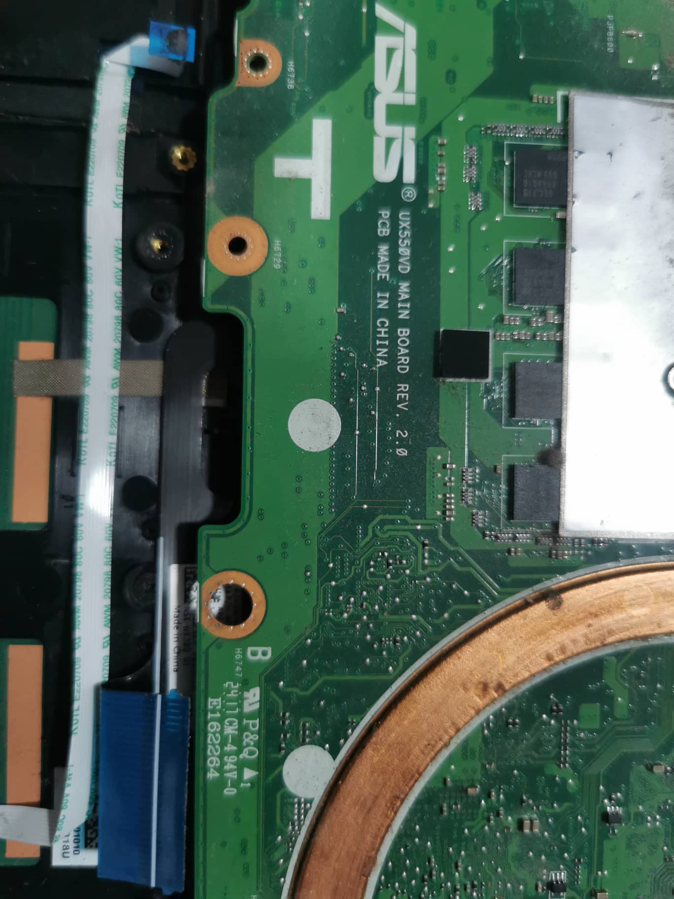

        It shouldn`t be a Cypress chip.Choose the chip manually by the part number on top.If it is a cypress chip then youve found the wrong one.
        Look for the bios like the one in the attached picture,its on the right side, it could be a macronix chip marked MXIC
          i did manually its a winbond W25Q80V@SOIC8,
            Wrong chip.
              Wrong one.See post #4 i edited it and added a picture

                  i thnk the bios chip is broken. thats whty it cannot be read. can i just replace it with other same brand winbond then write the bios bin file. is someone share it.
                  Wrong,see post #7 .The W25Q80 is 8 megabits,not megabyes.It is 1MB megabyte, an 8MB bios will not fit onto it
                  W25Q80: 8M-bit / 1M -byte (1,048,576) datasheet - https://pdf1.alldatasheet.com/datash...ND/W25Q80.html
                    u mean that chip is the bios chip of this laptop?

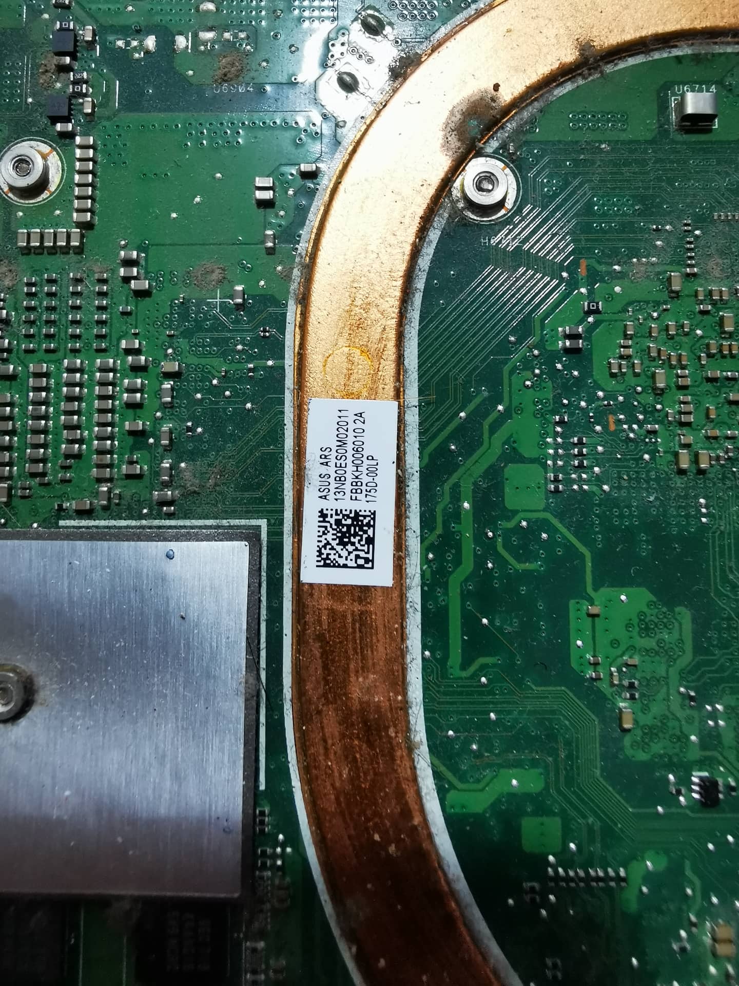

                        finally i found it this is my backup bios laptop no power
                          • 20914
                          The chip is not SOIC16 ,it has 8 legs,so choose @SOIC8 .The programmer probably read it ok but check it yourself next time and choose the chip manually by the part number on top of the chip and the type of package, SOIC8,SOIC16,WSON8 etc
                            understand and noted boss. thank you for your tip

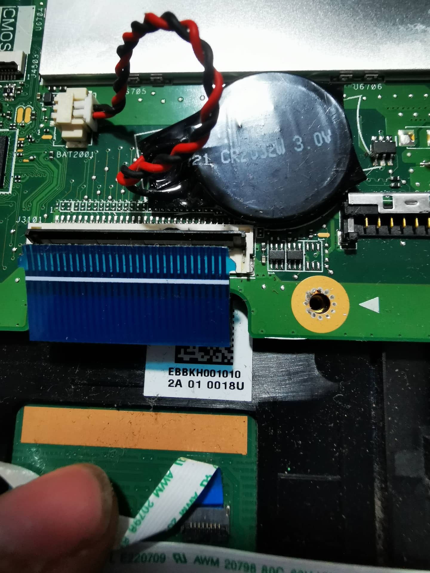

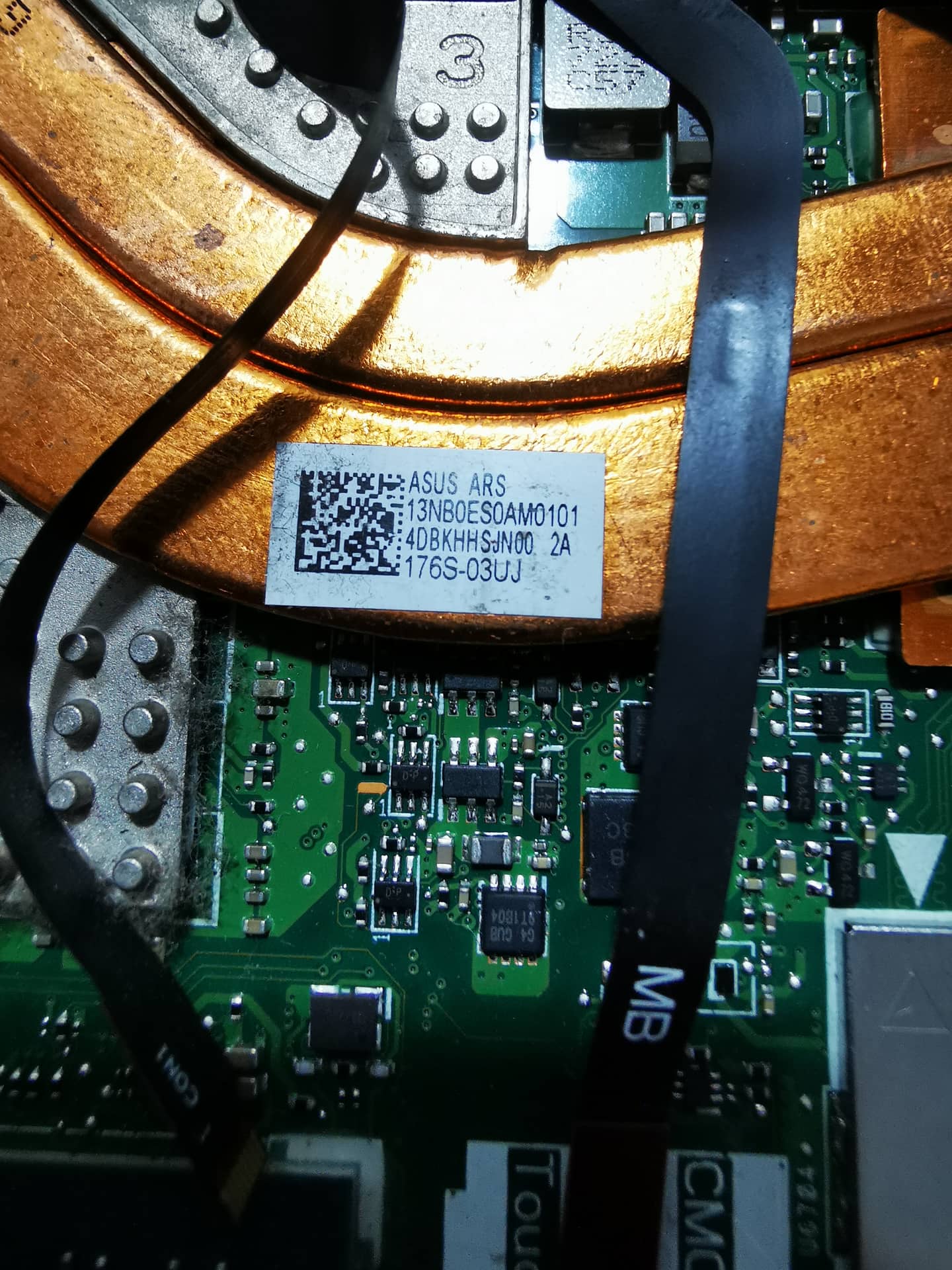

                                If there is a long white barcode sticker under the SSD drive or on the ram slot,or a square white QR code on the motherboard post a picture of it
                                • mydayparade
                                  • Jan 2021
                                  • 24
                                  • philippines
                                  i saw this two
                                  • mydayparade
                                    • Jan 2021
                                    • 24
                                    • philippines
                                    other 2 sticker on the other side

                                        The sticker on the heatsink is the part number for the heatsink. The sticker or QR code will be on the motherboard !
                                        "If there is a long white barcode sticker under the SSD drive or on the ram slot,or a square white QR code on the motherboard post a picture of it "
