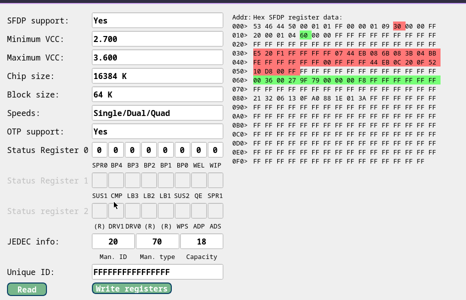

    I'm having difficulty figuring out how to get a working and properly sized bios for an Asus Zenbook UX425JA. The bios from Asus is 16.25 MB, whereas the XM25QH128A on the motherboard - which I am attempting to program with a CH341A - is 16 MB in size.
    SN: L833NBLP0002CXMB
    Thanks.

    Please read the BIOS chip with programmer and attach it here, the BIOS from ASUS website can't be flashed as is, also the DMI area (S/N, WIn key etc.) has to be copied to a clean BIOS

      The bios seems to be corrupted or have other issues (I have tried using flashrom to dump the current bios but every byte was set to 255).

        Check connection with programmer, if you're using a clip, try connecting again, it may take several tries, I don't think chip is completely empty (FF FF ...)
        Try AsProgrammer or NeoProgrammer in Windows, or iMSProg in Linux, press Read ID button, it should detect the chip ID

          IMSProg errors with "error reading block 0", and reading the ID shows the following:
