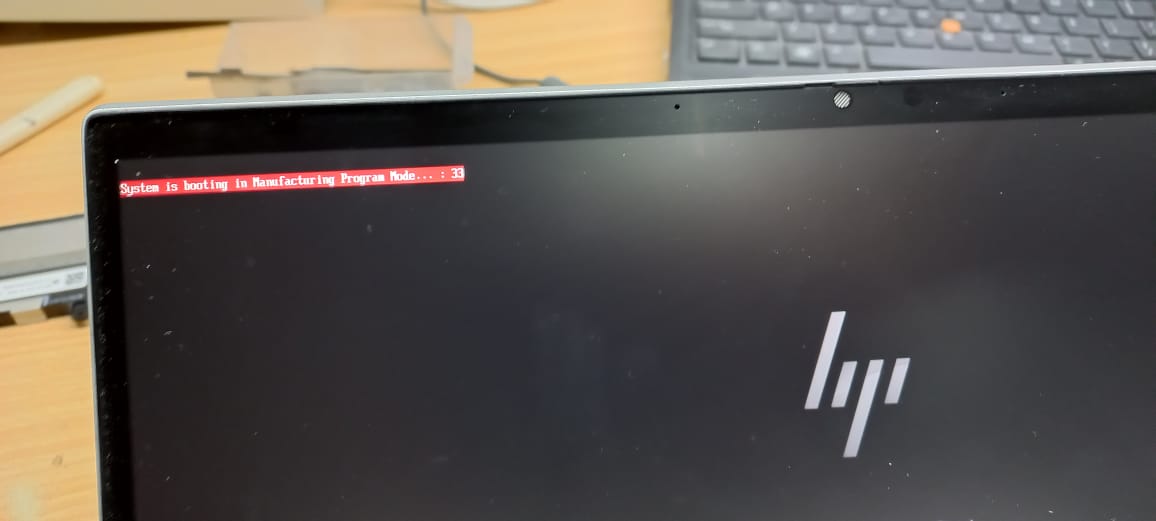

        Password gone works perfect ....Endpoint security issue clear ....But there is another issue which came after Bios Programming.......System is Booting into Manufacture Programming Mode....solution please
          You need to use a tool called BCU to make the programming mode locked, you can search and figure out how to use it.
                  Enter Bios Setup, you have a tab called "Set Machine Unique Data" , you have stickers on the back of bottom cover with Feature Byte, Built ID, etc, write them and save, then boot in windows and use BCU under cmd BiosConfigUtilityx64.exe /get:1.txt, modify MPM from *Unlock to *Lock, save as 2.txt in Docs (will not let you to save under BCU folder) copy 2.txt in BCU folder and use BiosConfigUtilityx64.exe /set:2.txt , restart.
