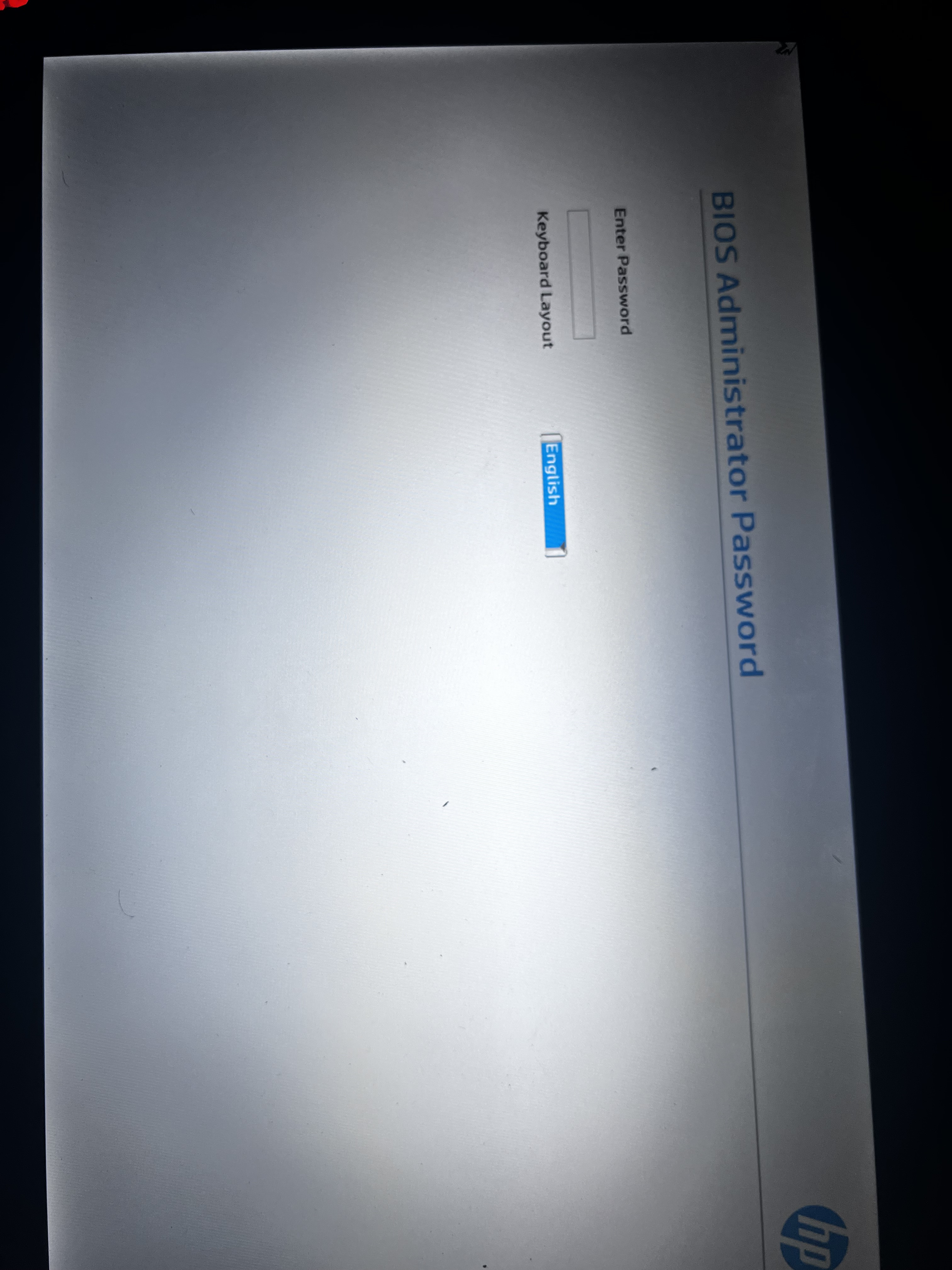

              BIOS LOCKED
              HP ELITEBOOK 830 G8
              PRODID 6A3M6AV
              SN 5CG21508Y5
              • hoaca388
                Badcaps
                • Jan 2022
                • 12237
                #207
                Originally posted by zinnou
                BIOS LOCKED
                HP ELITEBOOK 830 G8
                PRODID 6A3M6AV
                SN 5CG21508Y5
                HP EliteBook 830 G8 Notebook PC
                CT Number_6LGWQ0JWYG73BC
                Serial_5CG21508Y5
                Product_6A3M6AV4
                Fearture byte_76J6S6b7B7H7M7Q7W7m7saBapaqauawb8bUcAdpdqeMfPguhKhkj4jhk8mEmVmwn7nVngpDpq.f3
                Build Id_21WWCVET601#SUUW#DABB
                • zinnou
                  • Dec 2016
                  • 39
                  • algeria
                  #208
                  Serial_5CG21508Y5
                  Product_6A3M6AV4
                  write done put all time show bios password
                  • hoaca388
                    Badcaps
                    • Jan 2022
                    • 12237
                    #209
                    What do you mean ?

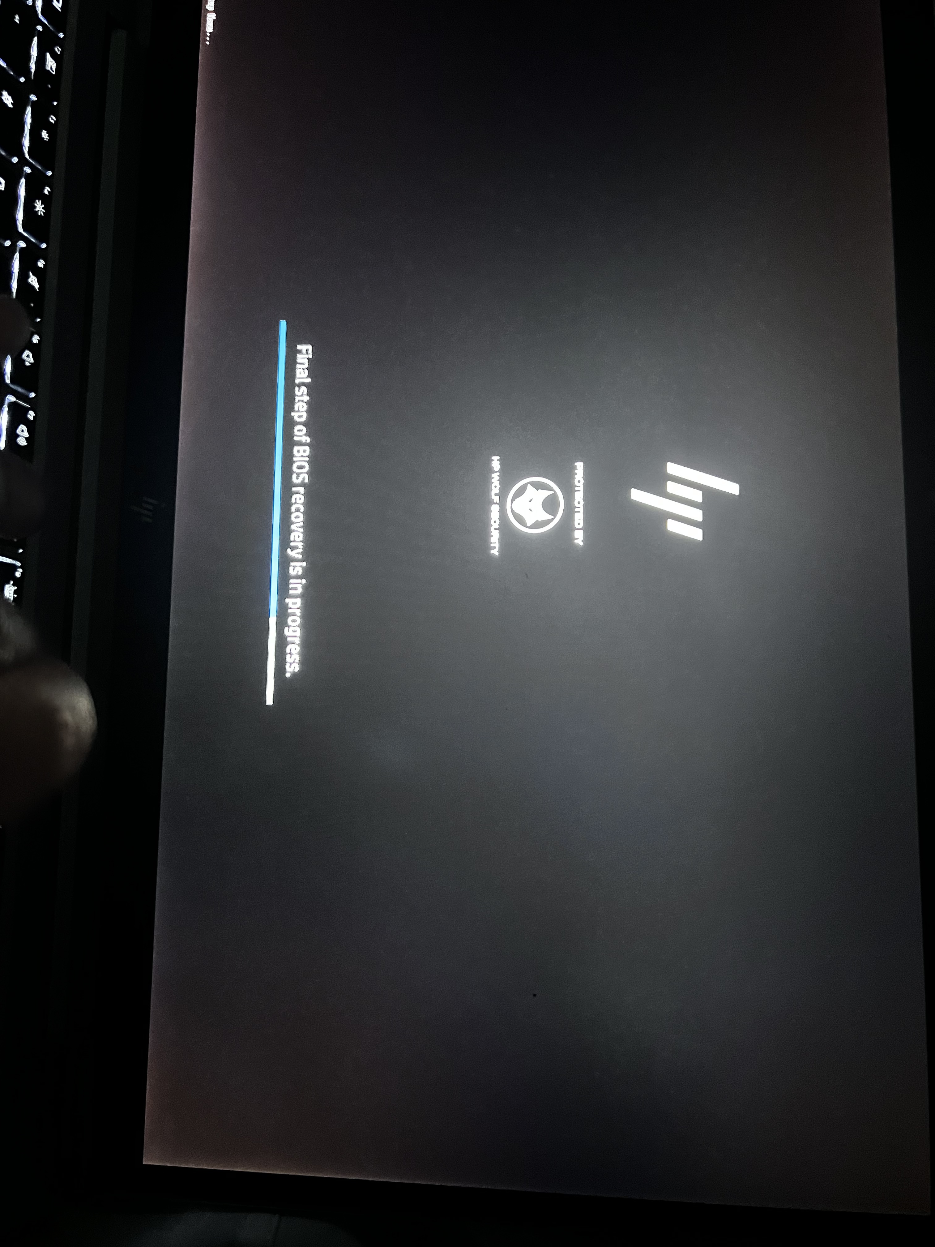

                    • zinnou
                      • Dec 2016
                      • 39
                      • algeria
                      #210
                      After writing the file
                      • hoaca388
                        Badcaps
                        • Jan 2022
                        • 12237
                        #211
                        Have you reset the settings to default ?
                        • zinnou
                          • Dec 2016
                          • 39
                          • algeria
                          #212
                          Power and click f10 show boot menu and restart 3 time and show password not open bios setting
                          • hoaca388
                            Badcaps
                            • Jan 2022
                            • 12237
                            #213
                            Ok , You have a second chip, post it here.
                            • zinnou
                              • Dec 2016
                              • 39
                              • algeria
                              #214
                              second chip
                              • hoaca388
                                Badcaps
                                • Jan 2022
                                • 12237
                                #215
                                second chip
                                Here
                                • zinnou
                                  • Dec 2016
                                  • 39
                                  • algeria
                                  #216
                                  Here
                                  work fine thank you
