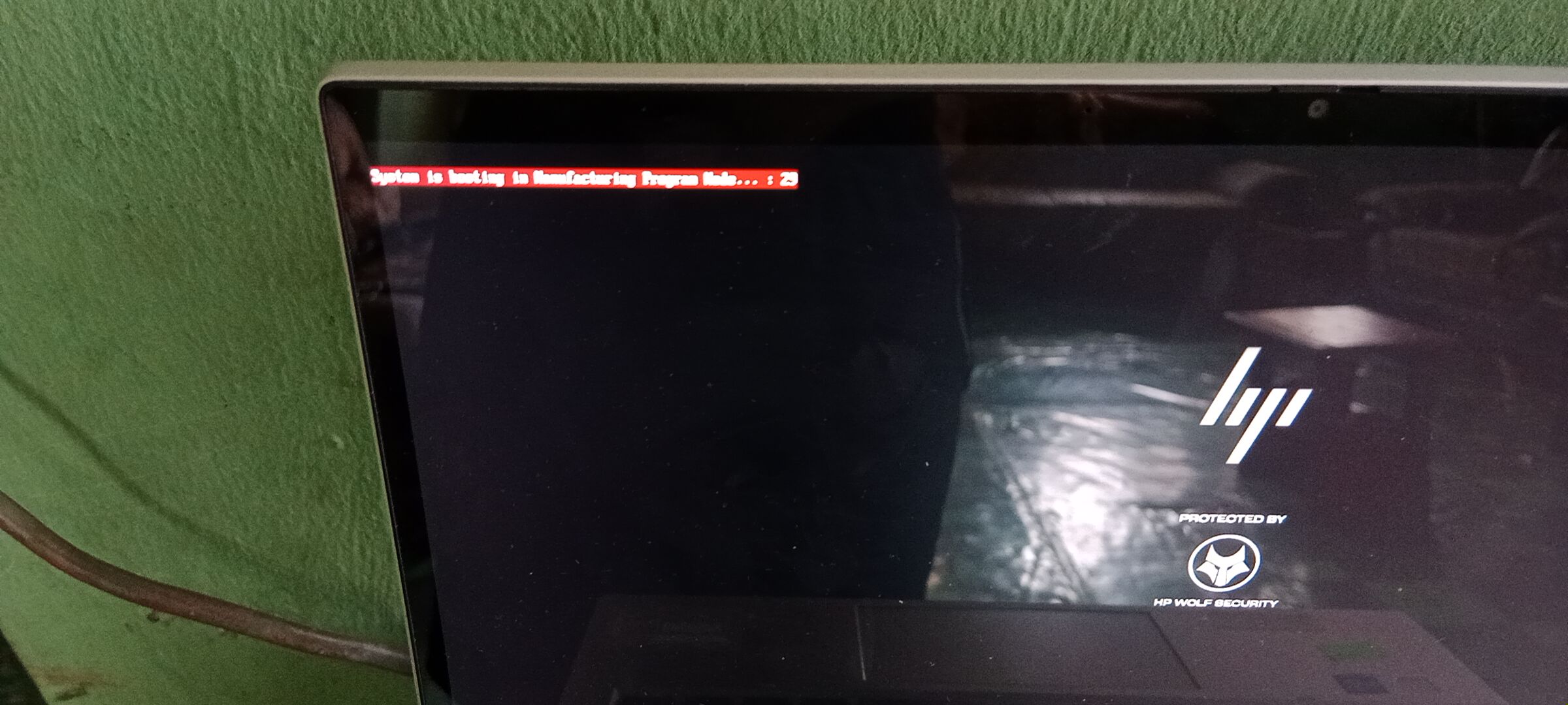

                #107
                Re: Please need unlock 830 g8
                PLease help me to remove Computrace
                • Bolanle
                  • Apr 2023
                  • 17
                  • vn
                  #108
                  please help

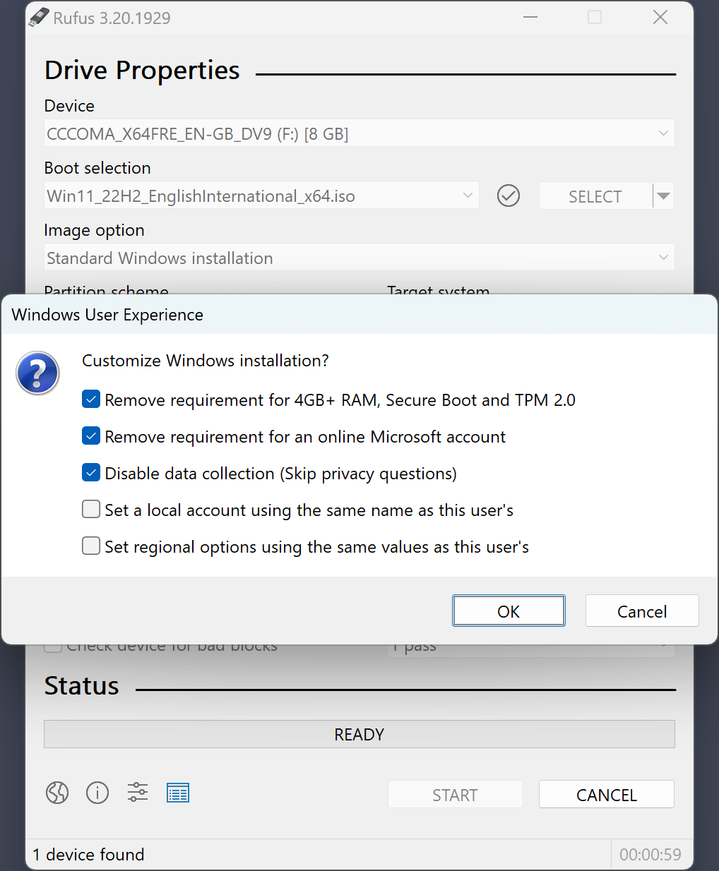

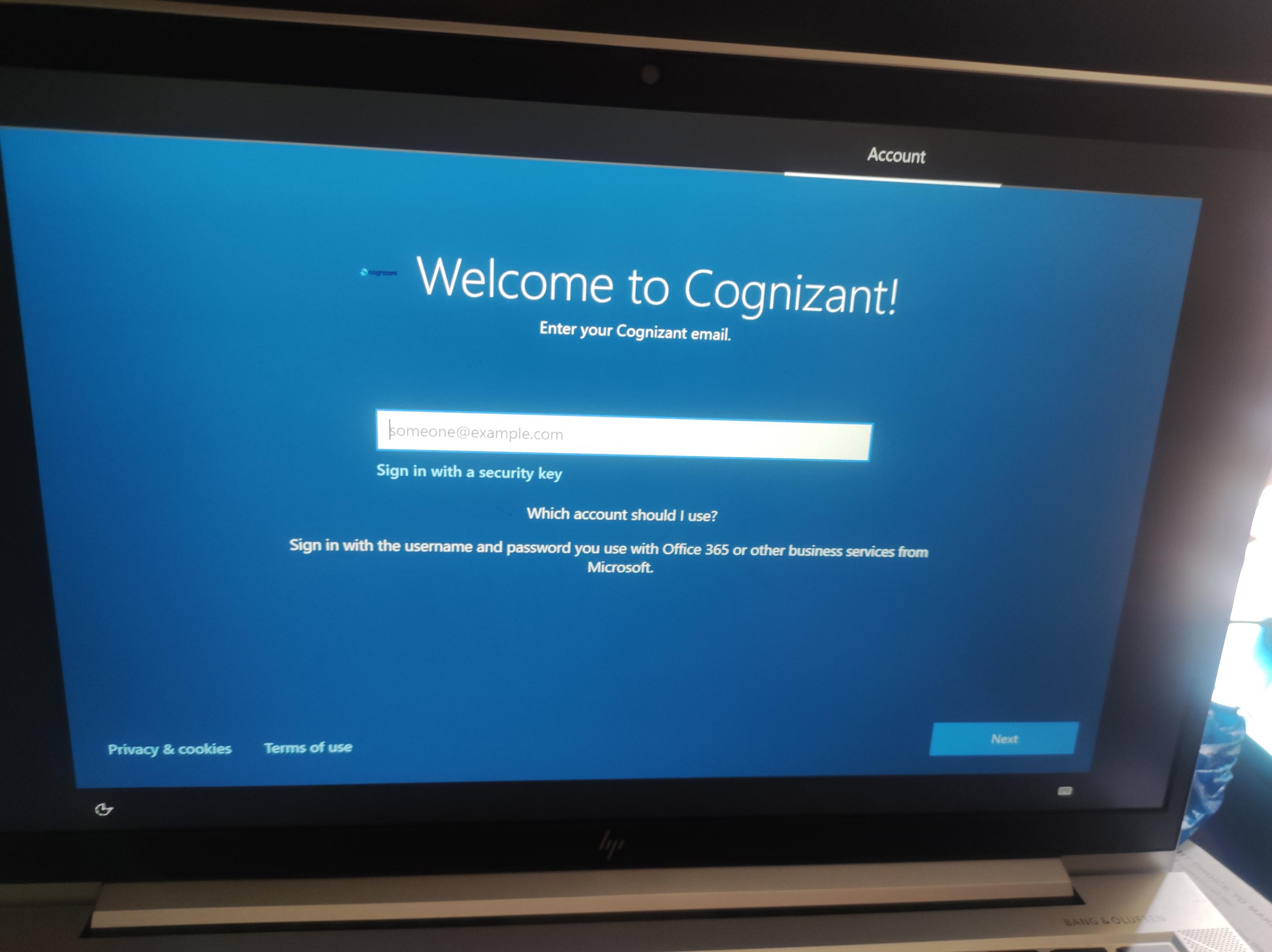

                          #112
                          how to remove this as shown on the picture,
                          already remove bios password and absolute lock
                          but my problem now is this setup no skip step on netword setup i think this is setup company lock, allready format m2 many times, anyone can help remove this tnx

                            • aldopc
                              • Jul 2017
                              • 465
                              • Chilito
                              #114
                              this is autopilot.

                                        #119
                                        Computrace disabled but battery not detected nor charging
                                        I have put all the details but still showing error as well
                                        you are in Manufacturing Programming Mode, write DMI in Set Machine Unique Data, save then boot to windows, use BCU 4.0 (Bios Config Utility) under cmd.
                                        biosconfigutility /get:1.txt and in 1.txt modify Manufacturing Programming Mode from *Unlock to *Lock (erase *from Unlock and put it to Lock) save file as 2.txt and use biosconfigutility /set:2.txt then restart. Other method to get rid of MPM mode is: after you write all DMI restart laptop how many times counter shows.
                                        When you have only Computrace activated as in your case and no password use BCU as above and look in 1.txt for Absolute Computrace and change from *Yes to *No and *Active to *Inactive (or *Enabled to *Disabled) or if you want to permanently disable put a * to Permanently Disabled, no need to write bios with a programmer.
                                        • volinakis
                                          • Jan 2021
                                          • 2723
                                          • N/A
                                          #120
                                          create a USB install with Rufus utility and check boxes as in picture. When it asks to connect to internet click to I don't have internet.
