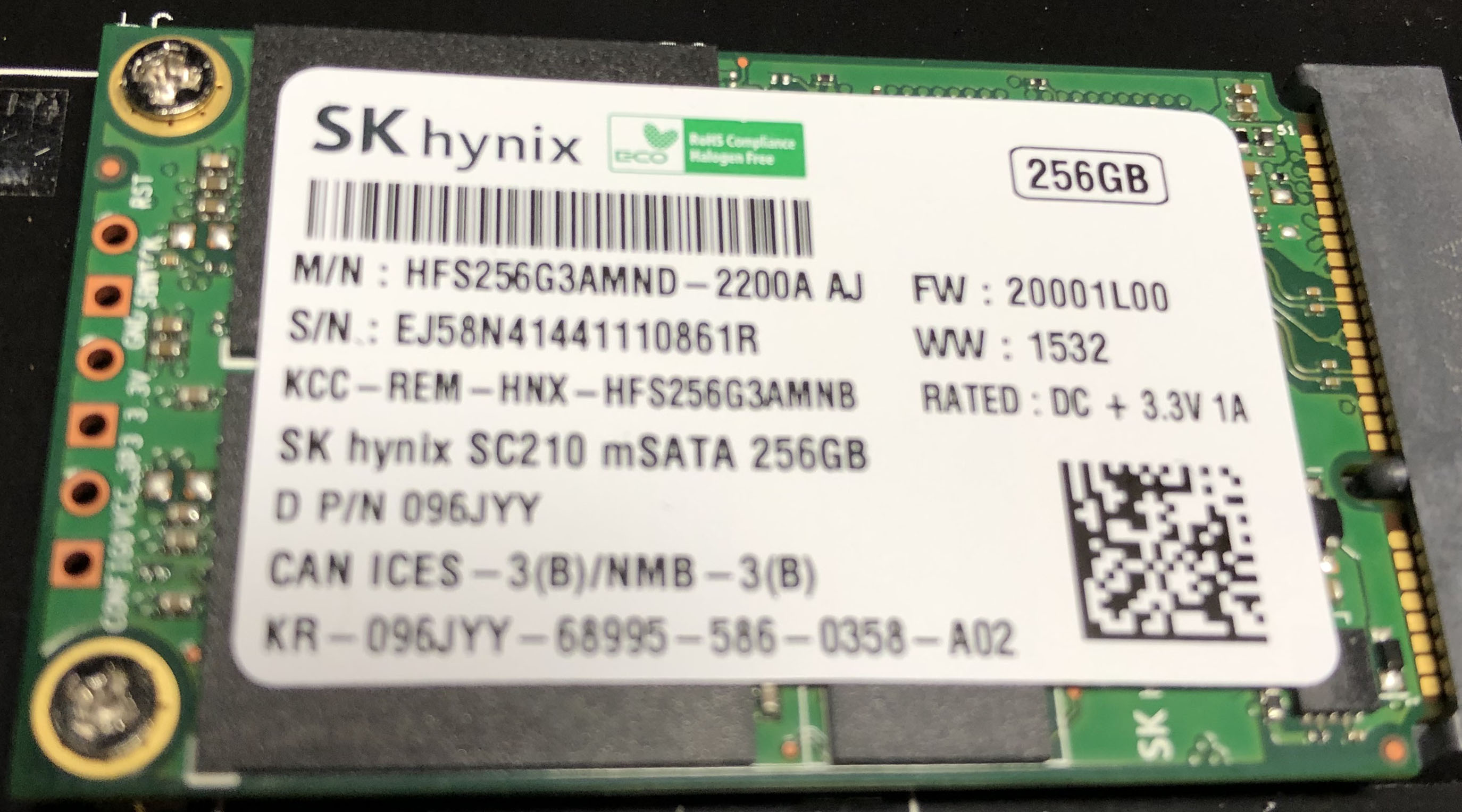

Dell password for Hynix SC210
  • pfrcom
    Oldbie
    • Jun 2006
    • 1230

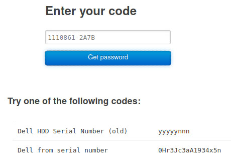

    I've had no success with a couple of Dell password generators, both originating from HPGL, Russia
    Trying the right 11 characters of SC210's serial number, and also the code given by Dell's lock message
    Also no success with BIOS_PW.ORG, using first 7 characters of Dell's lock message
    FWIW, BIOS_PW generates same codes when I input same as for HPGL
    Could someone please supply a password, or advise what I'm doing wrong above

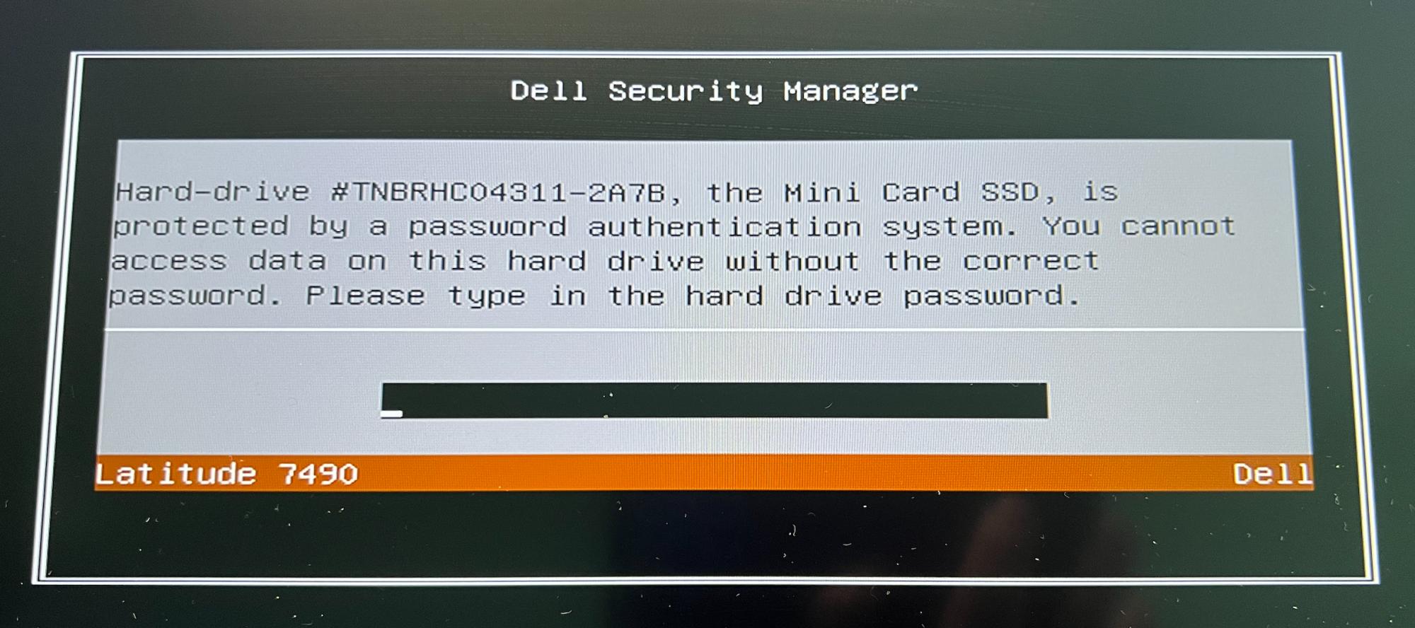

      Pls help me generate some passwords for this code TNBRHCO4311-2A7B/TNBRHC04311-2A7B

        Re: Dell password for Hynix SC210
        Have you tried entering the password using an external keyboard, US layout, USB 2.0 interface?

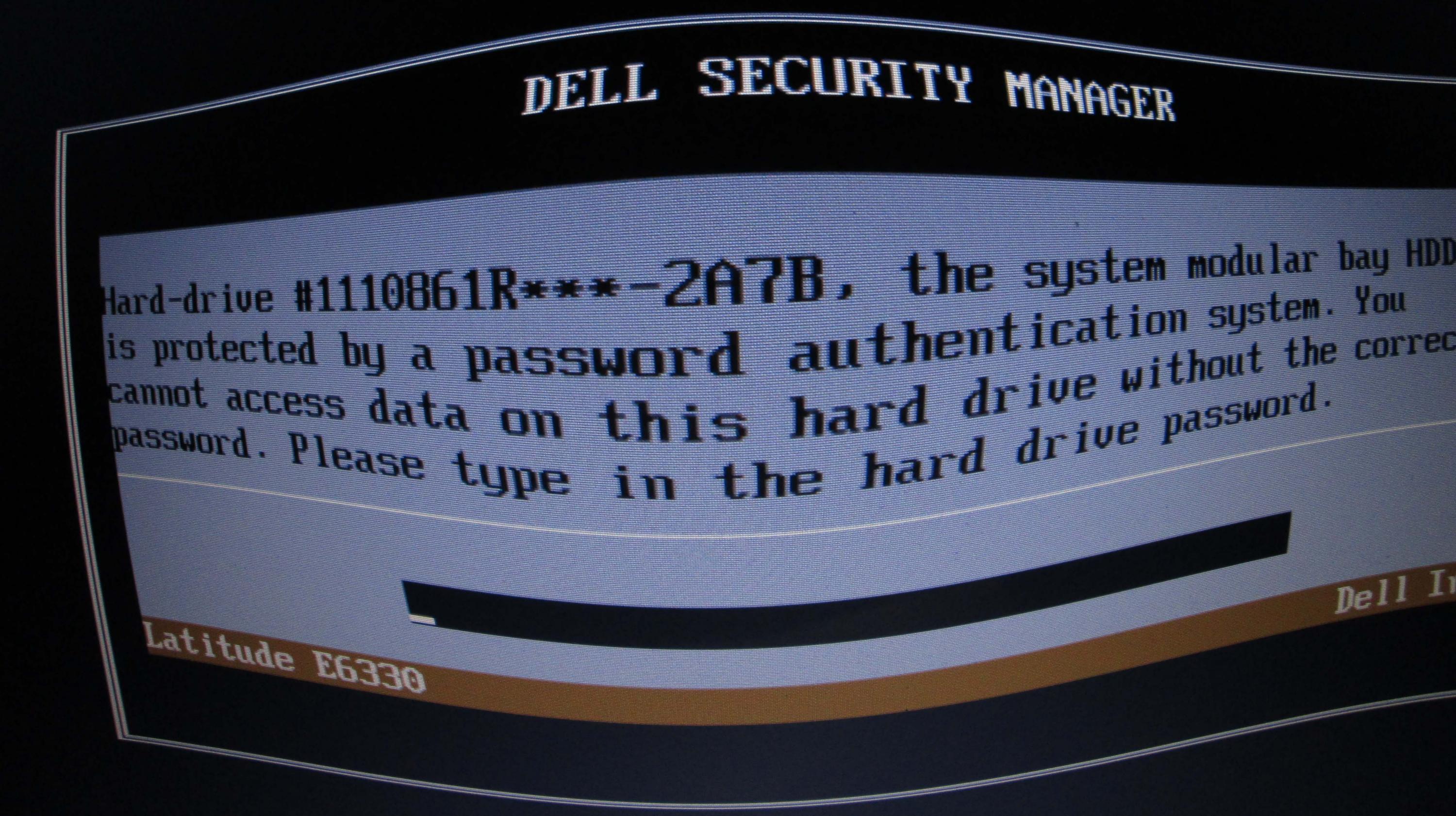

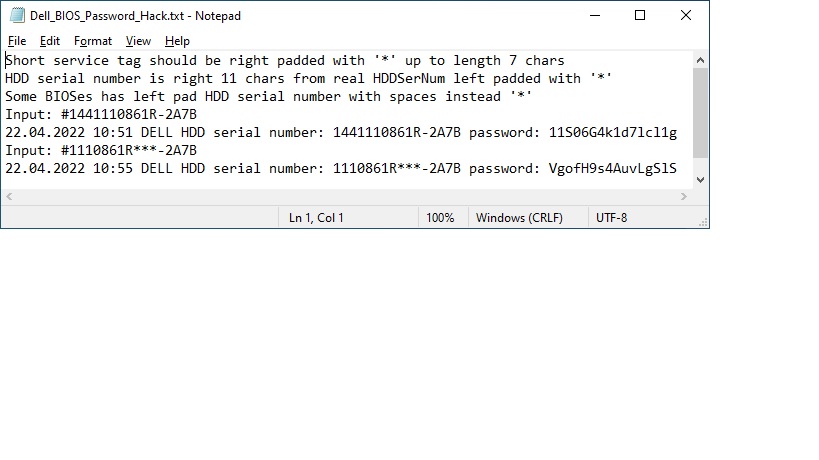

                Thank you to everyone who participated
                I am making progress
                Now have generated a password using https://beta.bios-pw.org/ (thanks SMDFlea) which is accepted with Ctrl&Enter from notebook keyboard
                But even though I see "Secure Erase in Progress", the Lock message returns when it reboots
                Noting imramromi's advice, tomorrow I'll put the SSD back in its original E7250, try again, and report back
                    I did restore SC210 into original E7250
                    A bit disconcerting that suffix of lock message had changed from 2A7B to 1F66
                    Anyway I generated another password using https://beta.bios-pw.org/
                    This too was accepted with Ctrl&Enter from notebook keyboard, but unlike when SSD was in E6330, "Secure Erase in Progress" took two or three minutes
                    And when E7250 was rebooted, there was no error message and Dell BIOS Security showed Primary disk: No password set
                    Thanks again to everyone who participated
