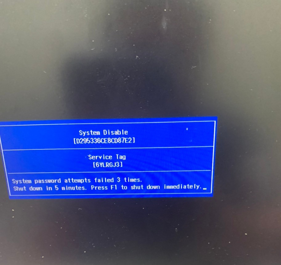

    need remove password bios dell vostro 3505
    helo everry body
    please help me remove password bios dell vostro 3505
    thanks!

    Do you have 2nd bios chip ?

      What is shown on the screen after entering the wrong pass 3 times

        Re: need remove password bios dell vostro 3505
        thanks reply !
        after entering the wrong pass 3 times. screen shown code : D295 336CE 8CD87E2
          Originally posted by clrscr
          thanks reply !
          TRY
          3vnip94e
          nygn47p0
            Originally posted by Bsolution
            TRY
            3vnip94e
            nygn47p0
            hix ... not working

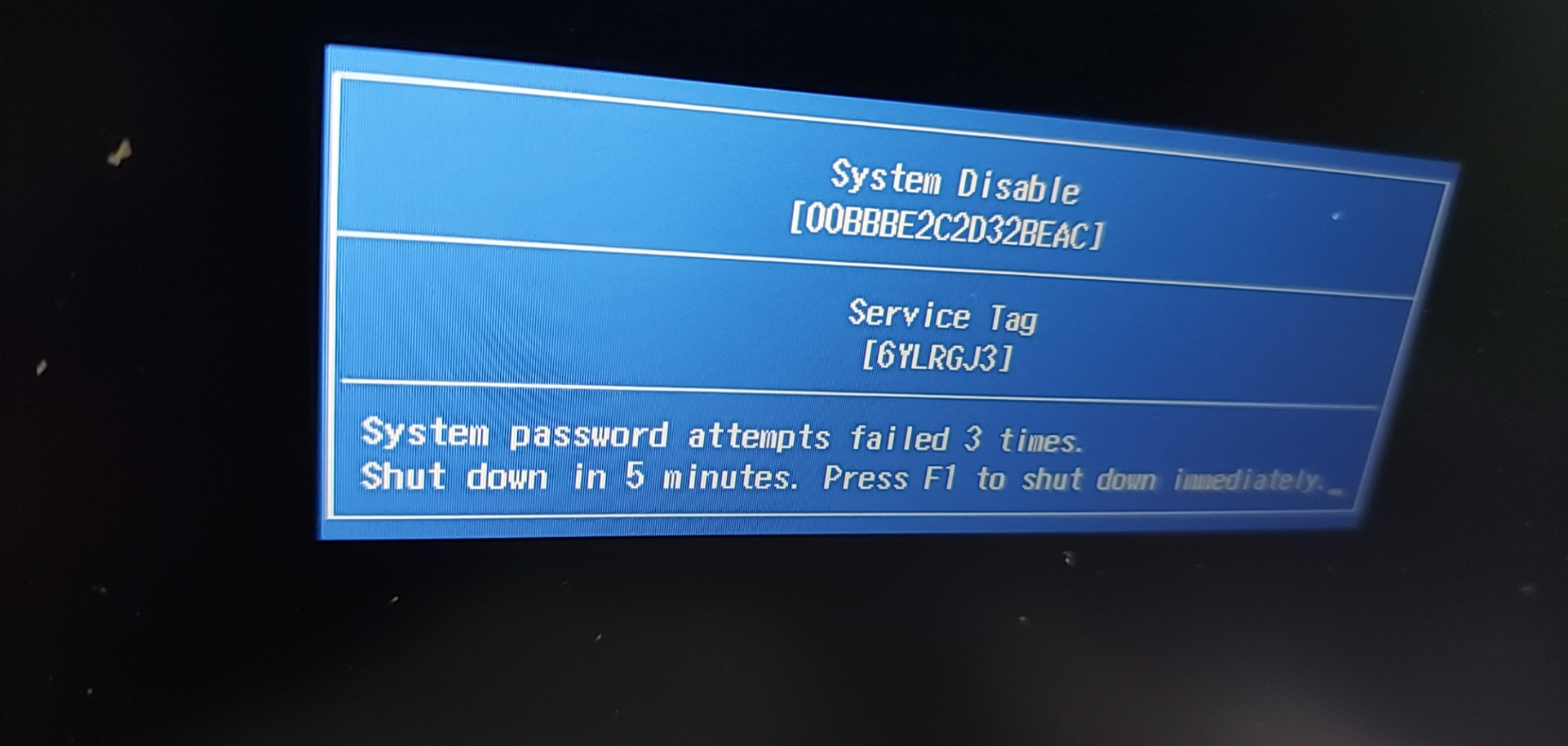

              thanks reply !
              After entering the wrong pass 3 times. Screen shown code : D295 336ce 8cd87e2
              83169425
                83169425
                when i try. it show new code 00BBB E2C2 D32 BEAC, can you help me
                  @clrscr
                  Dell bios engineers modified 16-hex System Disabled algorithm, so in some models it behaves as with Dell laptops that use suffix, so instead of typing the "8-digit password+ENTER", use CTRL-ENTER-ENTER right after typing the 8-digit password.
                  Give it a try, it should make a difference.
