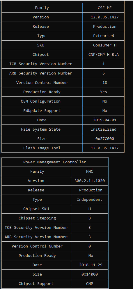

                      #90
                      Originally posted by hoaca388
                      Fault backup.
                      How can I make It? What program should I use?
                      Update:
                      May be this one?
                      • hoaca388
                        Badcaps
                        • Jan 2022
                        • 12333
                        #91
                        Update:
                        May be this one?
                        Try new file
                        ​https://www.badcaps.net/donate
                        • LybNik
                          • May 2025
                          • 5
                          • Russia
                          #92
                          I did it, yay!
                          I used method from this video https://youtu.be/IhRw7ePhLKs
                          Thank you, guys! You encouraged me to start figuring out how to get fault bios backup, it really helped
                          • Mathsx98
                            • Jun 2025
                            • 2
                            • Brazil
                            #93
                            I need help fixing the BIOS on my Lenovo L340 Gaming laptop.
                            The BIOS has been showing missing system information even before I updated it — the update was done using the latest version available on Lenovo's official support page.
                            Here are the issues I'm facing in the BIOS:
                            • Serial Number: INVALID
                            • Machine Type Model (MTM): INVALID
                            • Product Name: INVALID
                            The correct information should be:
                            • Serial Number (SN): PE05JXPH
                            • MTM: 81TR0002BR
                            • Product Name: L340-15IRH Gaming Laptop (ideapad) - Type 81TR
                            I don't have the original BIOS or a previous backup.
                            If it's necessary to send a dump or backup of my current BIOS, please let me know how to do that safely.
                            Any guidance on how to restore the correct DMI/system info would be greatly appreciated.
                            Thanks in advance!
                            • danito
                              • Jun 2016
                              • 1097
                              • Romania
                              #94
                              • MTM: 81TR0002BR
                              Thanks in advance!
                              https://www.badcaps.net/forum/troubl...rces-and-tools
                              Read
