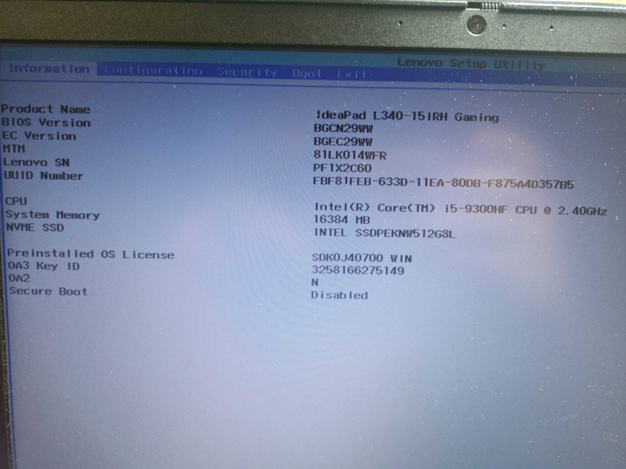

              #66
              Hi,i have a lenovo ideapad L340 Gaming laptop.
              I made a firmware update,and if i install the nvidia gpu its working fine,untill i restart the laptop,after restart i have black screen.I think its bios problem because i cant flash the latest one because i dont have battery,and ask me for that.Can someone make a bios with the latest version for me pls? Maybe a clean one? Would be much appreciated.Thanks in advance
              Laptop is ideapad
              L340-15IRH
              SN PF1X2C60
              MOBO is FG541/FG741 NM-C362 Rev1.0
              Bios version on laptop now is BGCN29WW and the latest on lenovo page is BGCN36WW

                #67
                Laptop is ideapad
                L340-15IRH
                SN PF1X2C60
                bios extracted from Lenovo website update for..L340-15IRH Gaming, L340-17IRH Gaming
                DMI 632000 - 633FFF
                • pityulix
                  • Nov 2021
                  • 30
                  • Targu-Mures

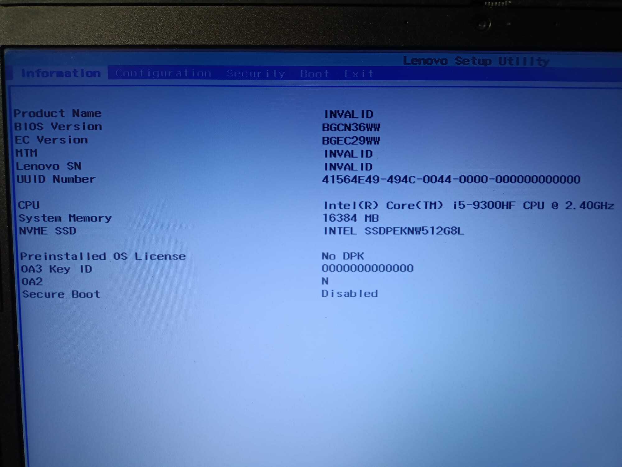

                  #68
                  Click image for larger version  Name:	WhatsApp Image 2025-02-25 at 20.05.37.jpg Views:	0 Size:	171.7 KB ID:	3581071 Click image for larger version  Name:	WhatsApp Image 2025-02-25 at 20.05.36.jpg Views:	0 Size:	101.7 KB ID:	3581072
                  Thanks for quick answer,here are pictures before i flashed the cip and after with the new bios,what can be? Still no picture on windows with any kind of driver for nvidia,on safe mode i have post on windows,and i can uninstall,but when i isntall back game over on screen.
                  DMI 632000 - 633FFF
                  • peste
                    • Dec 2016
                    • 13641
                    • ROMANIA
                    #69
                    DMI information is missing, you have the information range above, switching from one bios to another..

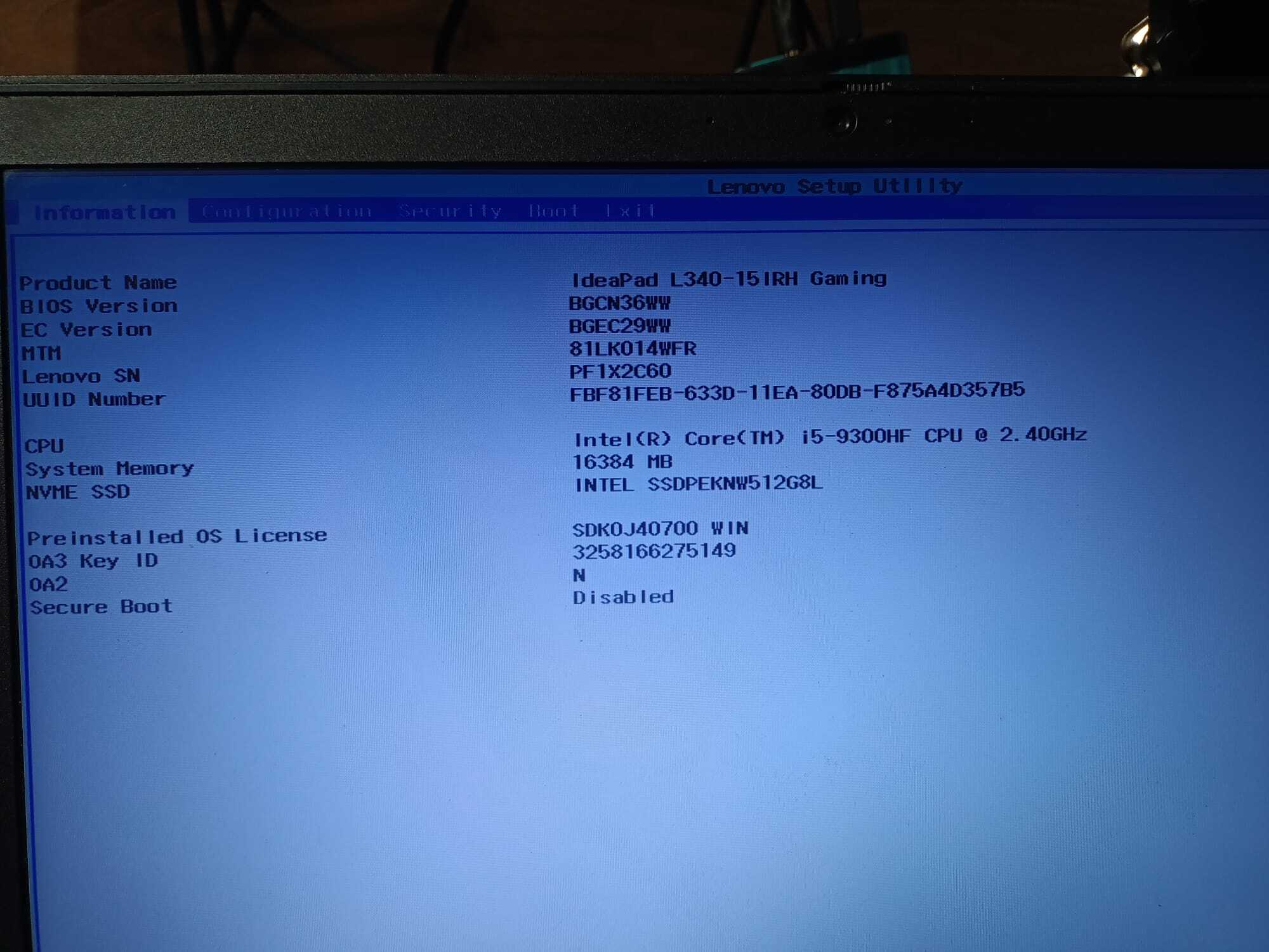

                      #70
                      sorry but im not familiar with that,what i have to do next? (i`m not experienced with bios things yet
                      • peste
                        • Dec 2016
                        • 13641
                        • ROMANIA
                        #71
                        the bios from post 68 is virgin, use the HxD program (it's free on the internet), enter both bios into the program (your laptop and the virgin one),
                        select that interval mentioned in both bios, copy the interval in your bios and pass it to the virgin bios (copy - paste)....and that's it...
                        • pityulix
                          • Nov 2021
                          • 30
                          • Targu-Mures

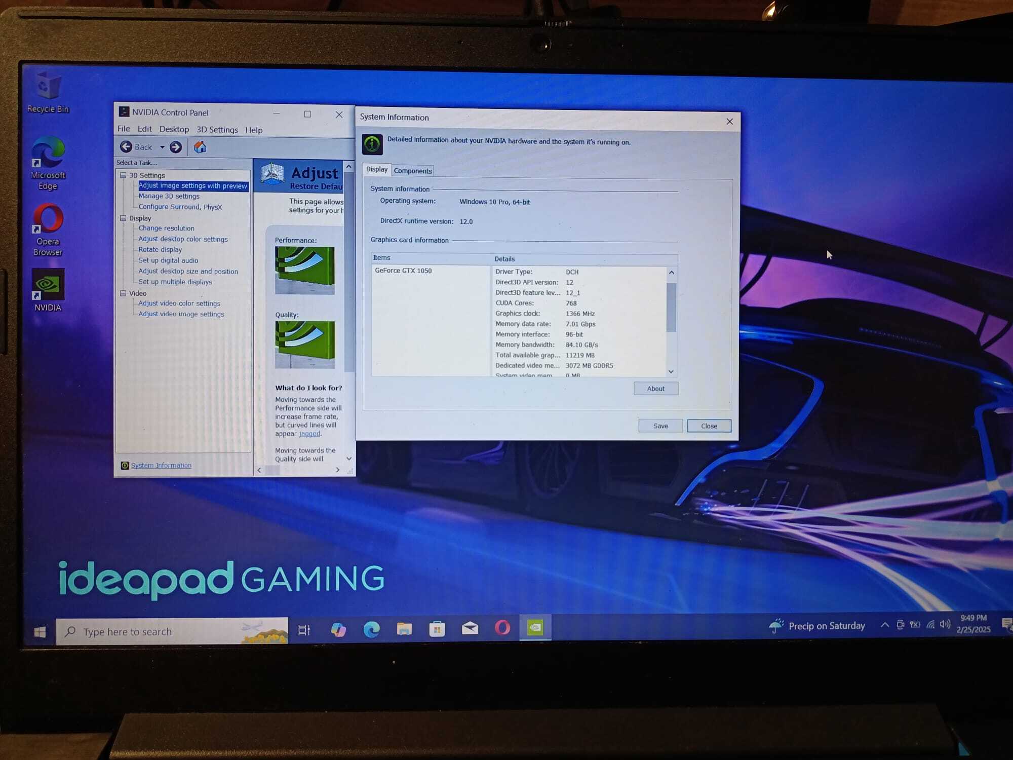

                          #72
Name:	WhatsApp Image 2025-02-25 at 21.50.37 (1).jpg
ID:	3581153 Click image for larger version
Name:	WhatsApp Image 2025-02-25 at 21.50.37.jpg
                          I did it with your kindness an patience for me,many thanks and wish u all the best.(Multumesc ) working fine.Cheers.
