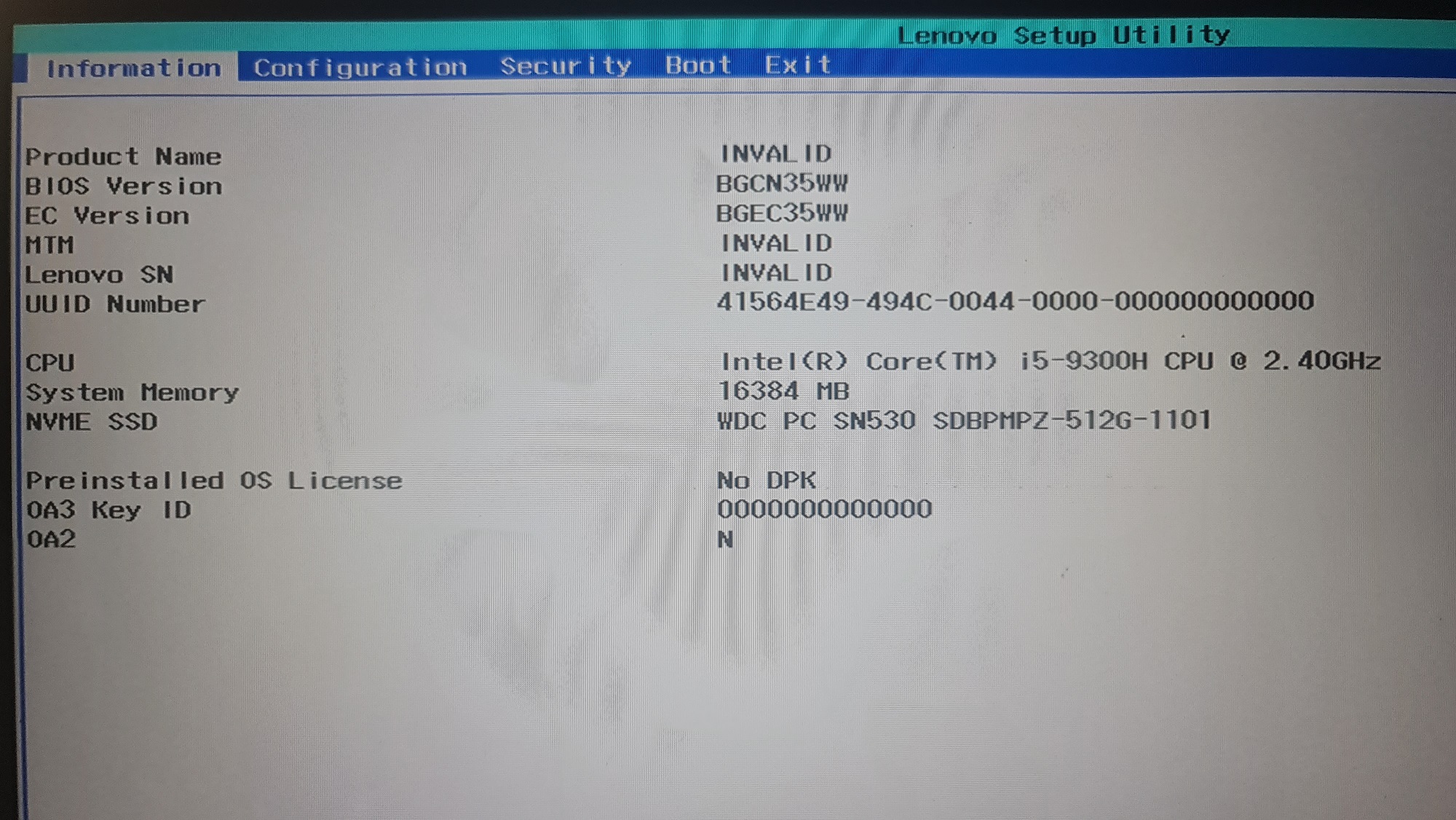

                    Got a lenovo l340-15irh laptop from previous owner.
                    He had a problem with bios (after changing a setting in bios, device got bricked)
                    He had a shitty fix for that.
                    Laptop works except TPM, Wired lan, secondary hard drive(sata port) and Intel Audio( Intel Smart Sound Technology OED with error: FW did not sent FW Ready notification.)
                    TPM, Wired Lan, Second drive is not recognized by bios or windows. Audio is but maybe driver issue.
                    Fix included changing flash chip i presume. Because it is not original in service manuals and it has barely noticable reworking.
                    Flashed Bios does not have any MTM, Levono serial number(i have the original box, and label on device so i have correct MTM and serial) and Os License OA3 key. Though windows is original, it was not formatted before and after fix and receives any windows updates
                    My questions: Probably because a shitty bios flash replacement and flashing a half ass bios is it possible these hardware disabled or not recognized by device? Is it possible to fix!? bios? Or at least would anyone help filling mtm and serial at least? Also what would you think after changing a bios setting (he told me it was about virtualization) having these hardware issues are normal or should i post it hardware forum also?
                    Thank you (maybe also this is not a good tldr, sorry).
                    I have current bios dumped, i also ordered and got original winbond flash chip that may be used as a backup. I dumped bios 4 times and with two different software, checked with HxD and they are identical. So attaching below as "BGCN35WW-current.zip". Also there is a bios update at:
                    https://pcsupport.lenovo.com/us/en/p...3-B07A93E0428C
                    or with direct link -> https://download.lenovo.com/consumer...s/bgcn36ww.exe

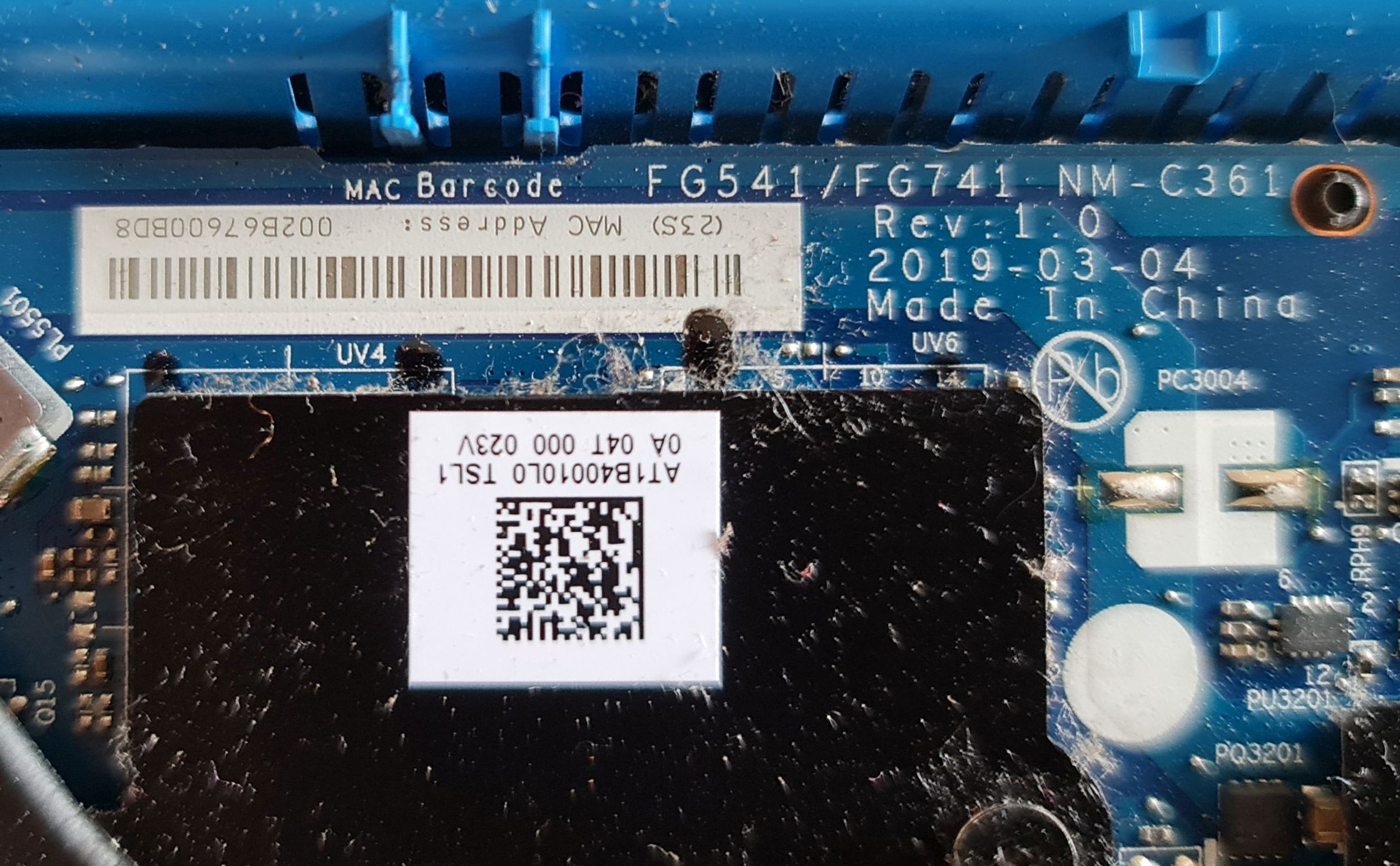

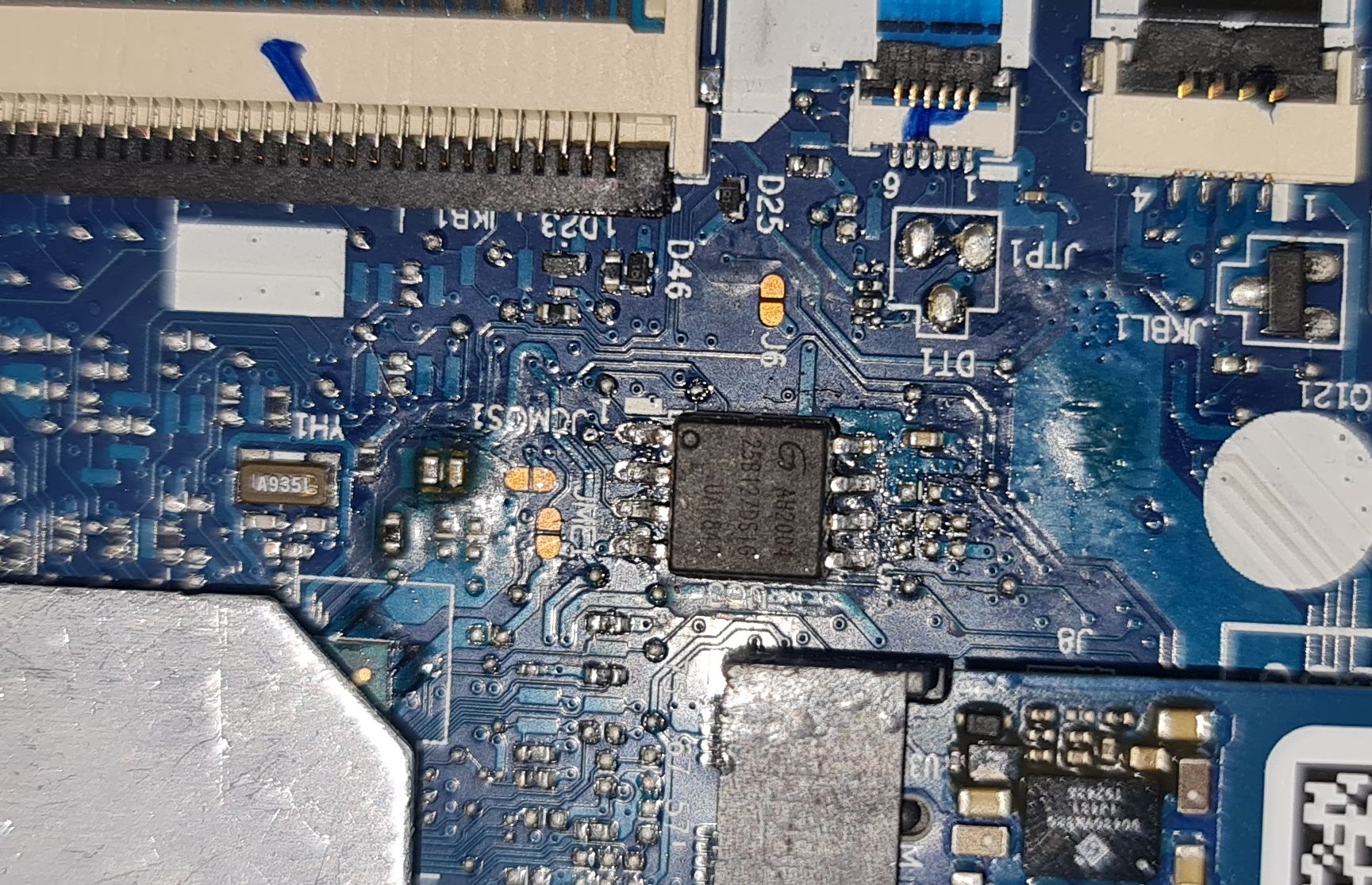

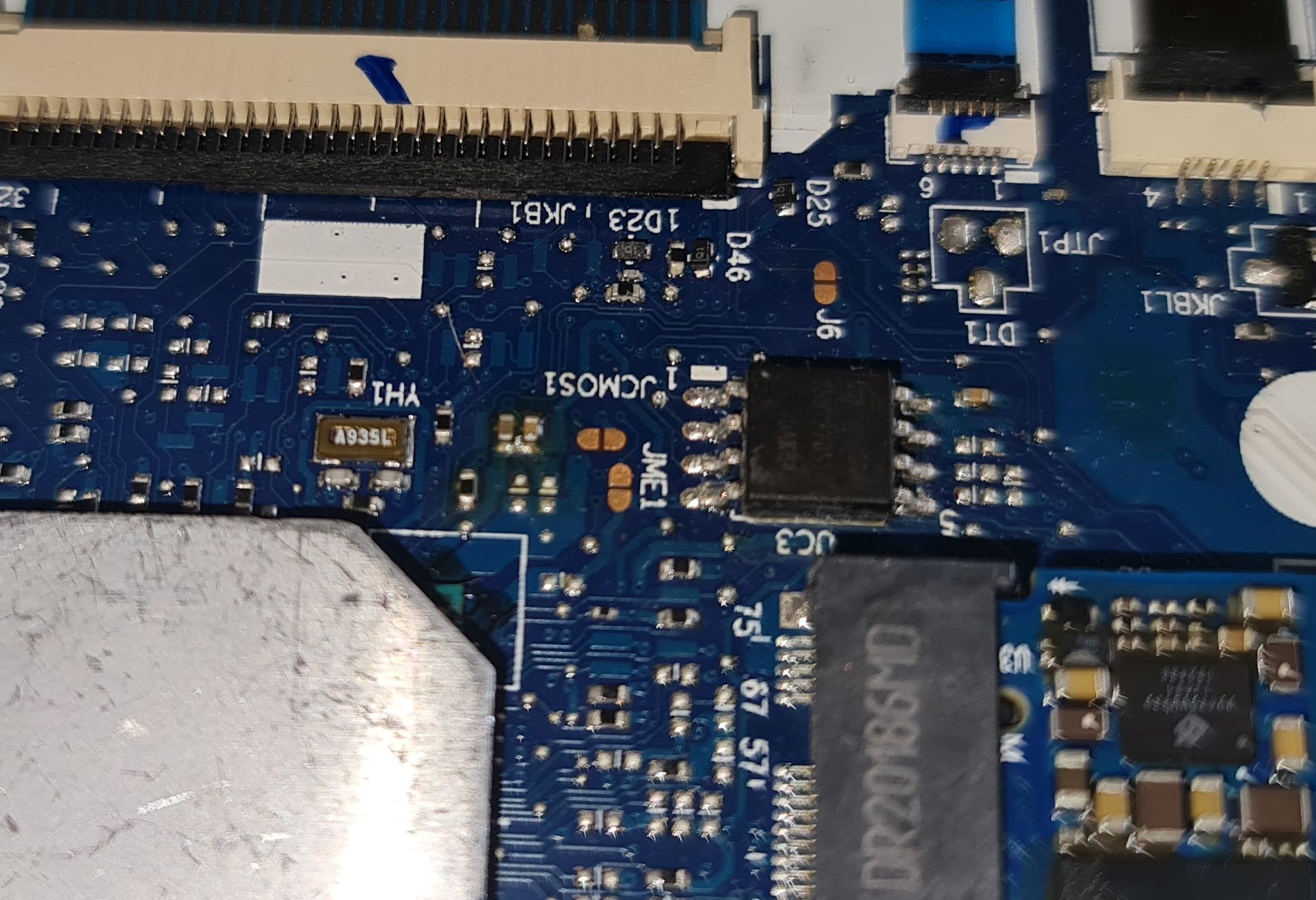

                    I disassembled device and noticed that bios chip is changed with gigadevice GD25Q128 and when i checked pcb documents found in this forum original one is winbond W25Q128JVSIQ. I ordered new winbond and may use as a backup.
                    If you would at least help me filling Product name, mtm, serial nr for bios here they are:
                    Product name: IdeaPad L340-15IRH Gaming
                    Model Name: 81LK
                    MTM: 81LK01KUTX
                    Serial: PF2A8A20
                    Also I am attaching pictures for Flash Chip area, there is some residue on left side, do you see/suspect any hardware issues about this job, thanks.
                    Thank you for your time
                    Hardware/PCB info: FG541/FG741 NM-C361
                    Rev:1.0
                    2019-03-04
                    Schematic: https://www.badcaps.net/forum/showthread.php?t=99699 (for rev 0.3 but i think it is similar)

                        I dont have original bios. Will try these tools. About other hardware problems (TMP, wired lan, sata connection not detected etc), do you think these may happen because a faulty/incomplete bios?
                        • gurselaksel
                          • Jul 2023
                          • 0
                          • Türkiye
                          #32
                          Re: Lenovo L340-15IRH Type 81LK Gaming/IdeaPad BIOS Problem
                          Lenovo U1 Tool did not work. Formatted USB, followed instructions @ https://github.com/ASparkOfFire/lenovo-u1-tool, booted with usb, selected tool, entered commands as stated, did not receive any error but bios info did not change. will try other
