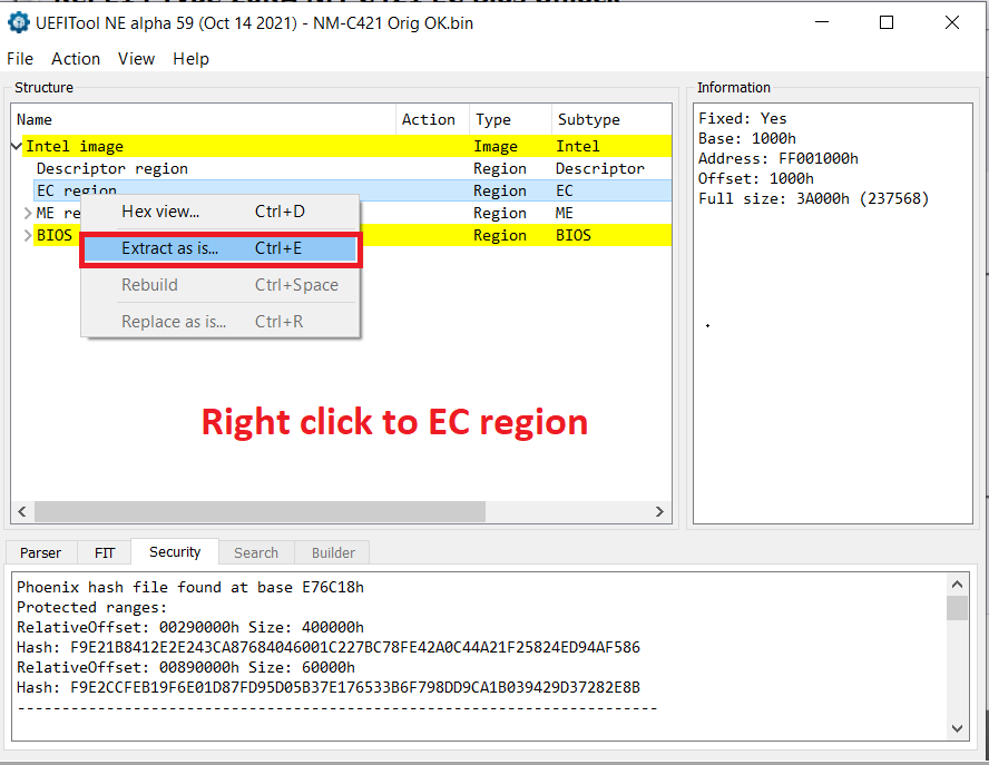

        Hi... I need the EC bin (256mb) of Thinkpad E15 type 20RE-S1RD00 S/N PF2D8VY3
        Motherboard NM-C421 Rev 1.0
        i only can find one in vinafix, the laptop turn on but have many problems in boot and keyboard, i don´t have the original because i replace de ITE. Thanks in advance.

            Re: E14 Type 20RA NM-C421 EC Bios Unlock
            Hi... I presume that repair fail but you update one 128kb dump and this model is 256kb, you must set the kb in the programmer before read the dump.

                    I don´t understand... That is my main bios, i want the EC dump (256kb).
                    This is the bios update of Lenovo page...

                        @hoaca388 i try this EC and work but have a same error. Can you extract the main bios dump of the Lenovo Page bios update? I already update. Thanks!

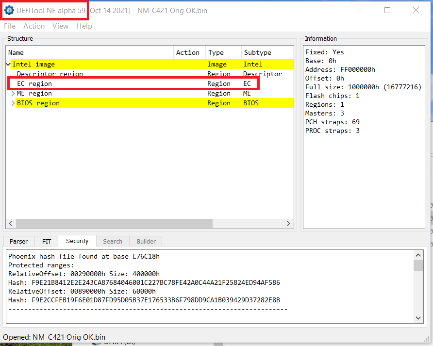

                                Hello, Sorry I don't mean to hijack, What chip is the EC chip ?
                                I have a locked E14 and I have a bad CRC error.
                                I have tried all the dumps I can find maybe I need to program the EC.
                                Any info will be great thanks.

                                  Looks like an I/O chip. Usually it can be a big chip with lots of pins.
