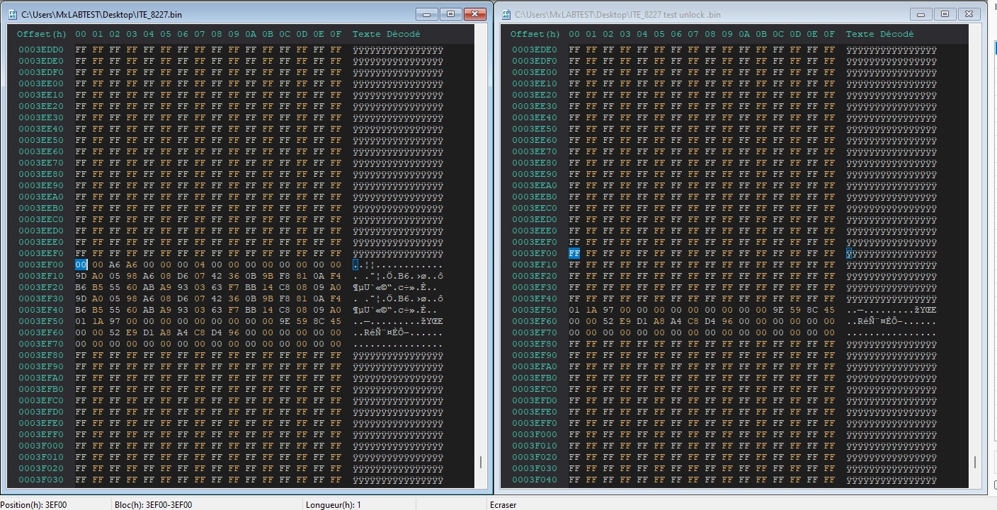

        Hello, everyone.
        Who can help me unlock the bios password in this ite firmware?
        E14 Type 20RA sn PF27ZV0B
        Thank you

          ​try
          • danito
            danito commented
            Editing a comment
            after writing this appears and stops.
            0177: Bad SVP data, stop PoST task.

          #65
          ok we're not far, remove the line from 3EF50 to 3EF5F for test
          we come back to my previous post with the SVP data. you have to try several combinations in this area
          https://www.badcaps.net/forum/troubl...89#post1872689
          https://www.badcaps.net/forum/troubl...76#post3157976

          • danito
            danito commented
            Editing a comment
            it is also my first laptop to which I am trying to remove the password (I mean ITE/MEC).
            I don't know where to start to understand something.

          #66
          try all for test
          After analyse and compare, it seems that you need 00s and not FFs
          try final test
          • danito
            danito commented
            Editing a comment
            It works!!!
            thank you very much for your help. Extraordinary.
