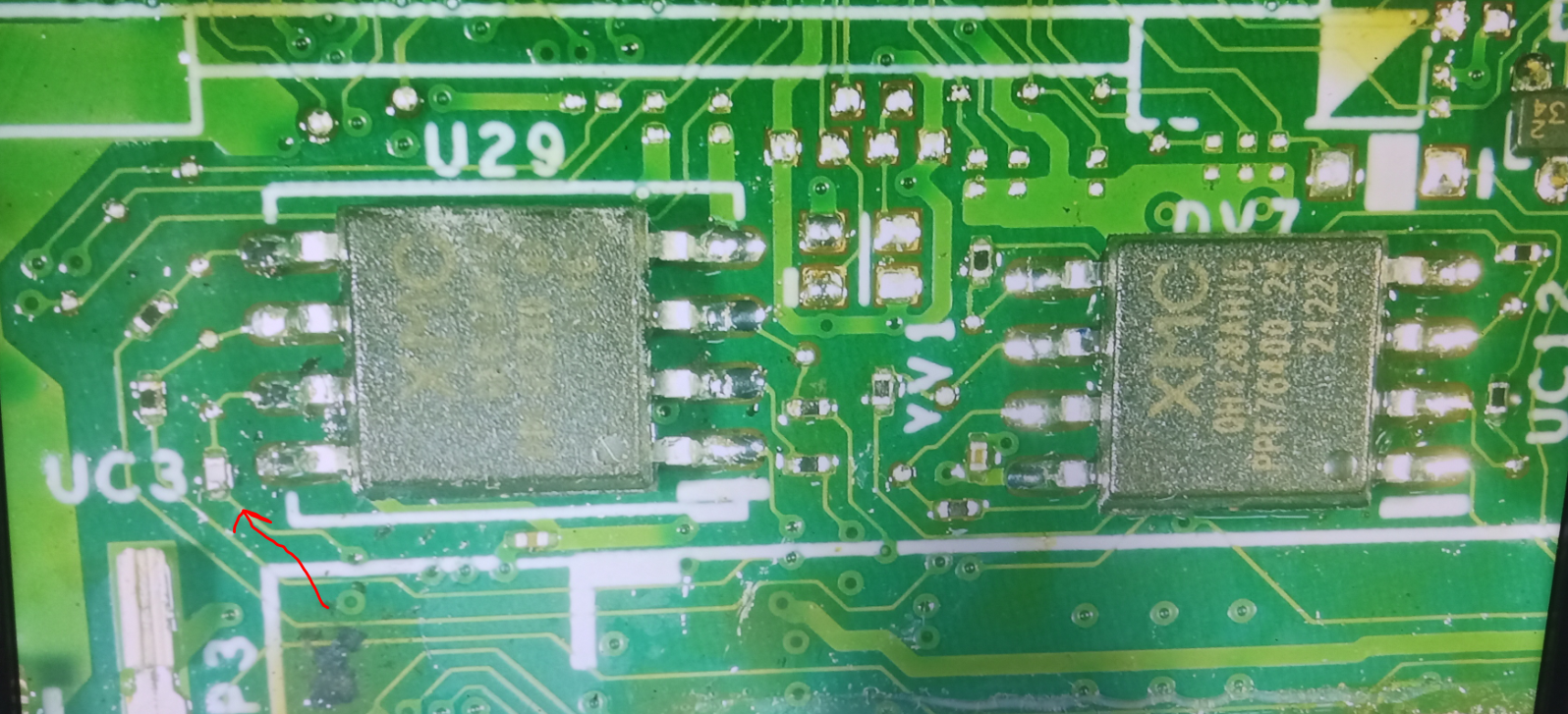

              Hi, can you help me remove the BIOS password from this dump,or tell me what the password is ?
              Thinkbook 15 G2 ITL

                  After reinstalling the chips, the laptop no longer powers on. The symptoms are as follows:
                  • The power button blinks in the following pattern: stays lit for about 2 seconds, then turns off for about 10 seconds, and repeats in a loop.
                  • I left the laptop in this state for at least 10 minutes – nothing changed, it still keeps blinking.
                  • The screen remains black, with no sign of POST.
                  Note: This is not my first time working with BIOS chips. I have experience with programming and soldering, so I’m not sure what could have gone wrong in this case.
                  Does anyone know exactly what this blinking pattern means, and whether it indicates a corrupted BIOS or possibly another type of fault?
                  Should I open a new thread for this issue, or is it okay to ask here?
                  • hardware1
                    • Sep 2021
                    • 2954
                    • N/A
                    #69
                    You didn't erase the chip, so the problem could be a bad soldering, missing component or a broken (chip even if you can still read and write it).
                    all donations are welcome,
                    • Jovica123
                      • Oct 2017
                      • 87
                      • N/A
                      #70
                      No, I did not erase the chip. I even desoldered and read both chips again, then compared the dumps with the ones I had previously posted here on the forum – the contents are identical.
                      As for my soldering work, I’m attaching a photo below so you can see it yourself. I’m confident that I haven’t accidentally removed any components during the desoldering/soldering process.
                      If you believe the chips might be damaged, would it be possible to replace the QH64 and QH128 with Winbond 25Q64 and Winbond 25Q128 instead?
                      Are these fully compatible in terms of pinout, voltage, and performance, or could there be any issues when using them as replacements on this board?
                      And of course, should I actually go ahead and replace them, or would you recommend further testing before doing so?

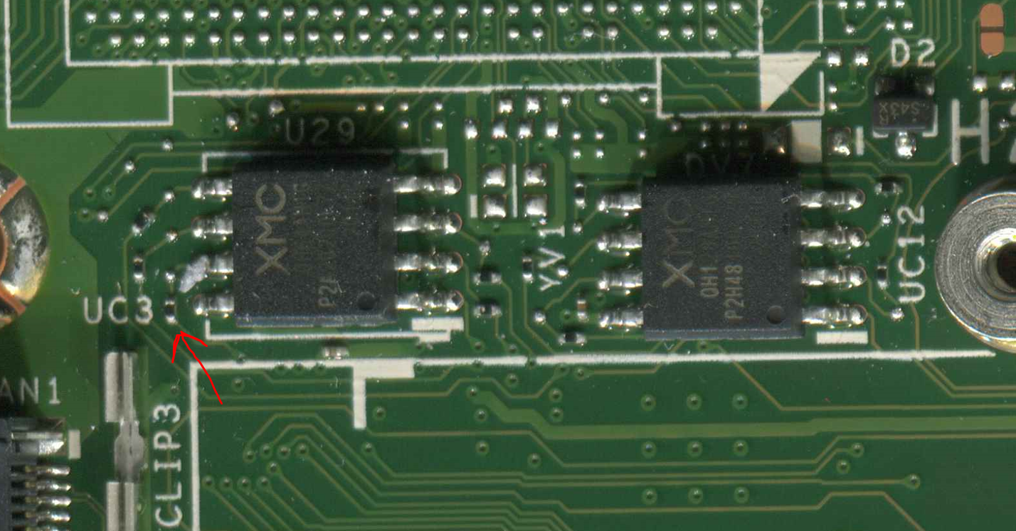

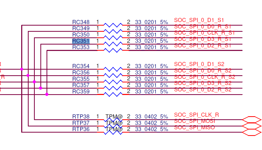

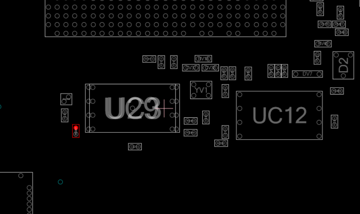

                      • hardware1
                        • Sep 2021
                        • 2954
                        • N/A
                        #71
                        Is that a Capacitor or just a light reflection?
                        According to the Schematic, Boradview and another similar board picture, it should be a Resistor in that place.
                        Everything else looks the same.
                        Premium supporters get full download access and other benefits.

                          #72
                          You’re right, there should be a resistor there. I accidentally moved it, and when I put it back, I placed it upside down, so the white bottom side was facing up. I’ve now corrected it – great observation!
                          What do you think could still be the issue? The only thing I’m certain of is that the BIOS battery was connected when I removed the chips. However, this has never caused problems for me before, and I doubt it’s the case this time either.
                          And just a correction regarding the power button blinking pattern I mentioned earlier: the button stays lit for 5 seconds, then turns off for 5 seconds, and repeats like that.

                            #73
                            Yes, you can use Winbond W25Q64JV/W25Q64FV and W25Q128JV/W25Q128FV.
                            Okay, I can't see anything else.
                            • Jovica123
                              • Oct 2017
                              • 87
                              • N/A
                              #74
                              In the end, it turned out that the problem was not related to the BIOS at all, but to the motherboard itself.
                              When I first received the laptop for repair, I powered it on and saw that it was locked. I turned it off and began the unlocking process. However, after I first removed both chips, read their contents, and soldered them back onto the board, on the next power-on attempt the laptop would no longer display an image (power LED stays on for 5 seconds, off for 5 seconds).
                              This morning, out of curiosity, I decided to try again. I noticed that the CPU was heating up, so I thought everything was fine. However, on the second power-on – after connecting the display – the laptop again refused to start.
                              I decided to try one method: I placed the motherboard in the fridge for 15 minutes, then powered it on again. Amazingly, the laptop started, displayed an image, and I shut it down using the power button. When I tried to power it on again, it wouldn’t start.
                              Is there anything that can be done in this case?
