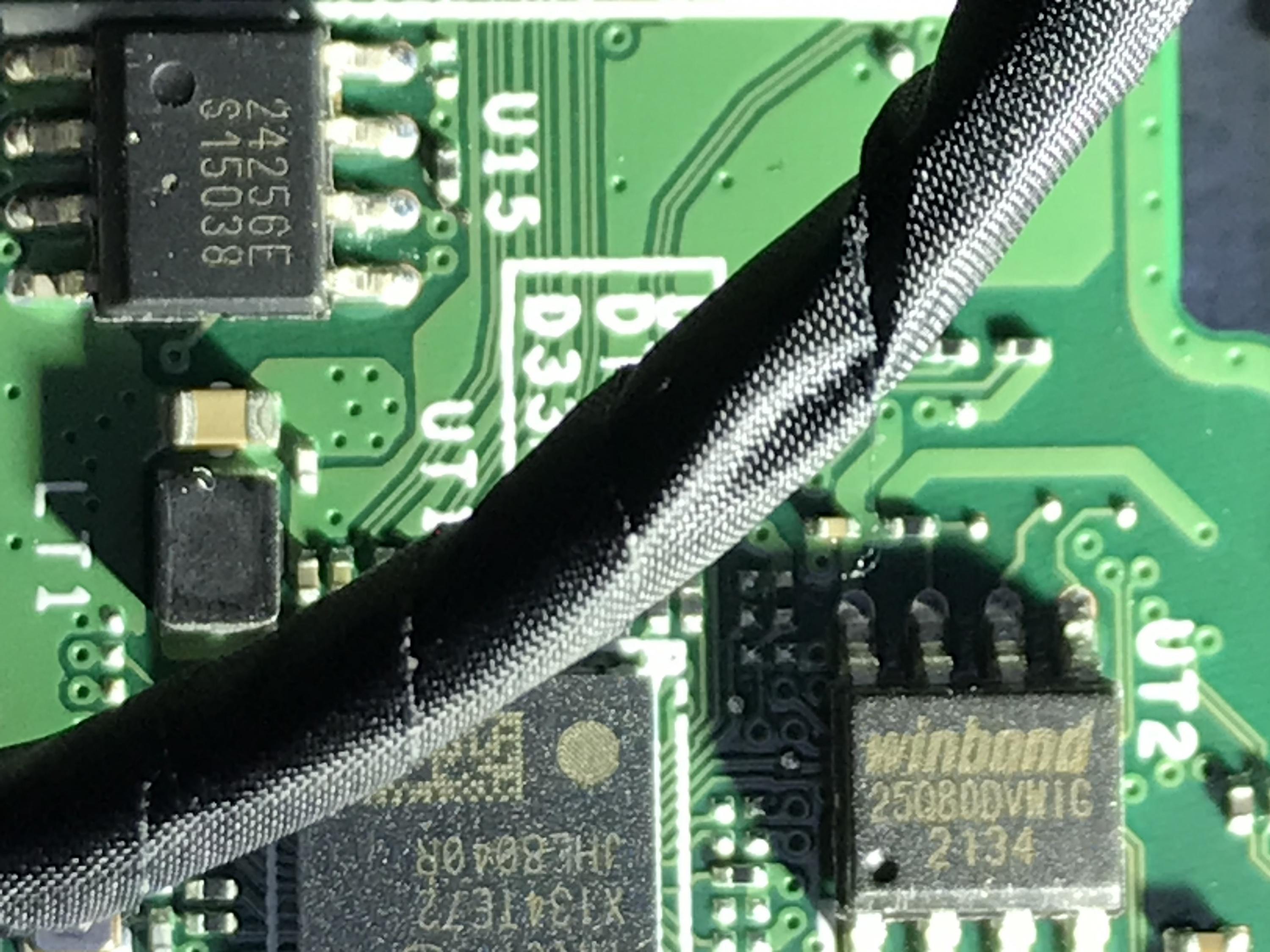

      Hi everyone!
      I need your help with resetting a bios password for this laptop.
      (BTW I had to recreated this thread as it was joined with another with same title)
      I already tried some stuff but I cannot get any further now.
      Laptop Model is a Lenovo ThinkBook 15 G2 ITL
      Interesting ICs on mainboard:
      Winbond 25Q80DVWIG 2134
      24256e S15038
      Details:
      I started trying the stupid things first as I didn't tried reseting a password since several years (took CMOS and battery battery off and such)
      I learned quickly that the new laptops store security things in an extra IC.
      From the official firmware flash I saved the temporary extracted files from the manufacturer (Insyde, H2OFFT) and modded the platform.ini and also reflashed the bios but the password is still there.
      Did a backup of the bios with UDOO so I could learn a little more with UEFITool about the bios and NVRAM.
      As this didnt brought me any further I got myself a cheap EEPROM programmer(CH341A Pro) and tried to read/write directly from the ICs. That worked but even after erasing/rewriting the password was still there.
      Any help appreciated.

        Winbond 25Q80DVSIG 2134 is not a bios chip. Its size is only 1MB. you need to find chip with symbol 64 , 128 or 256... for example 25Q64... 25Q128...25Q256..
