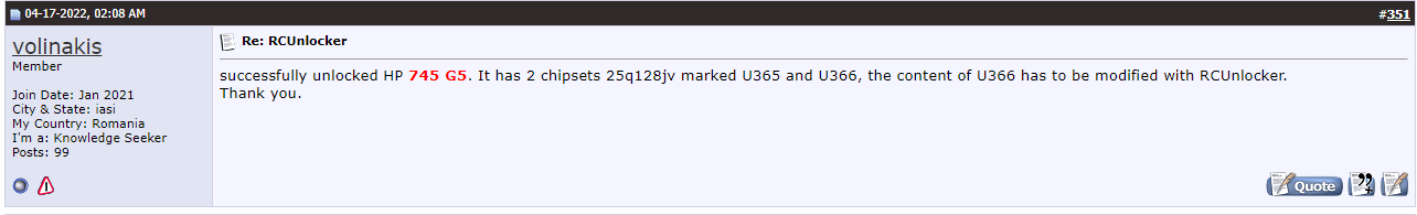

              i have a hp elitebook 745 g5 and need the bios password removed can you help me, thx
              i made a copy of the bios chip, and i used HPUnlocker and soldered it back but still password on the bios, RCUnlocker says wrong chip

                Its the wrong chip as RCUnlocker says. There are 2 chips U365 + U366 .Find the other one and try it again.

                  From another Thread. you need to backup the U366 Chip.

                              ok this is a update. i presume nobody looked at my attachment, but this is what happened.
                              I copied the bios chip to my pc as this:
                              W25Q128JV(OTP)@SOIC8 and i unlocked it with HPUnlocker because RCUnlocker didnt work and programmed it back and it didnt work. so i programmed the original file back.
                              What i had to do is read to bios chip as:
                              W25Q128JV@WSON8 without the (OTP)(i dont know what this is) then the RCUnlocker did work to unlock it and programmed it to the chip, soldered it and now the password is gone
                              so what happened is i chose the wrong chip in the programmer, but it did read and program so i assumed it was correct bu it wasn't
