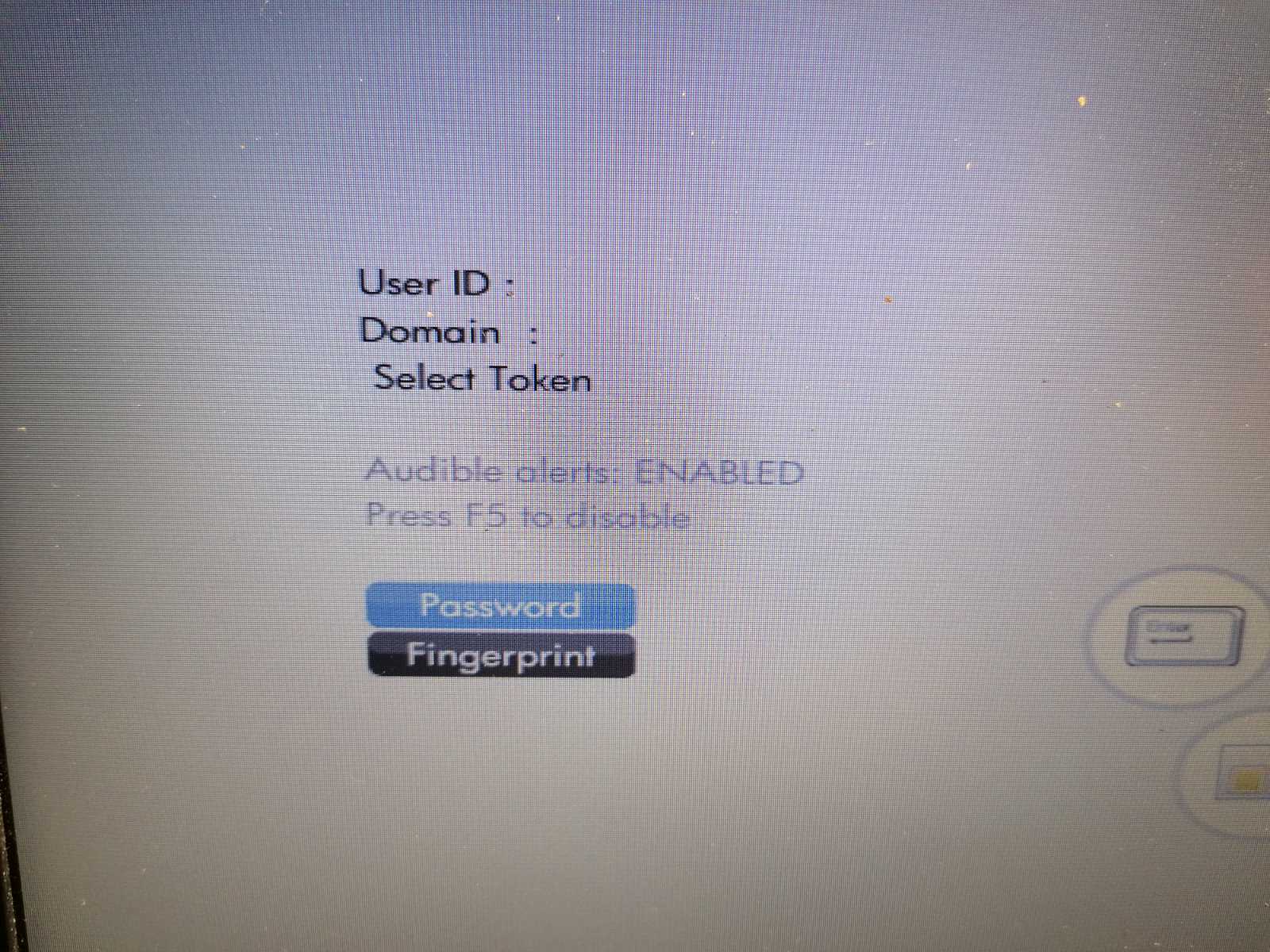

                              • N0f3ar
                                • Oct 2016
                                • 51
                                • Bulgaria
                                #955
                                Re: HP BIOS unlock tool
                                retry ,sorry file before has not been modified
                                thank you for helping ,but still not working .
                                it has admin password and no boot option is allowed.
                                      just password or a page with users?
                                      try

                                          #960
                                          try
                                          no username , but still has password
