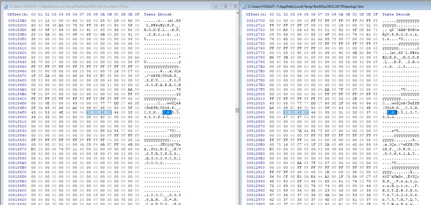

          Hello Together,
          I have a ZBook 15 g1. I desoldered the chip and read it via linux. Used the tool of post #1 and got a _unlocked file.
          Sadly the _unclocked binary is binary identically to the original one
          What went wrong? Is there another possibility to unlock the bios?

            Originally posted by hopey
            Hello Together,
            What went wrong?
            I attached the files. Maybe someone is able to patch it for me or you can help me how to?
            Try this.
            • hopey
              • Aug 2019
              • 5
              #926
              Re: HP BIOS unlock tool
              Originally posted by imranromi
              Try this.
              Thanks, but beyond compare shows me a completely different content
              I'm not even sure to have the same serial number anymore
                Thanks, but beyond compare shows me a completely different content 🙄 I'm not even sure to have the same serial number anymore 😐
                Correct i fix board 10 mint before your i read post.I read bios chip via programmer and sent you
                  look
                    Hello Together,
                    soldered the bios chip back in - they seemed to forget the password on this 🙈 ...and I did not check it 🙄 epic fail!
