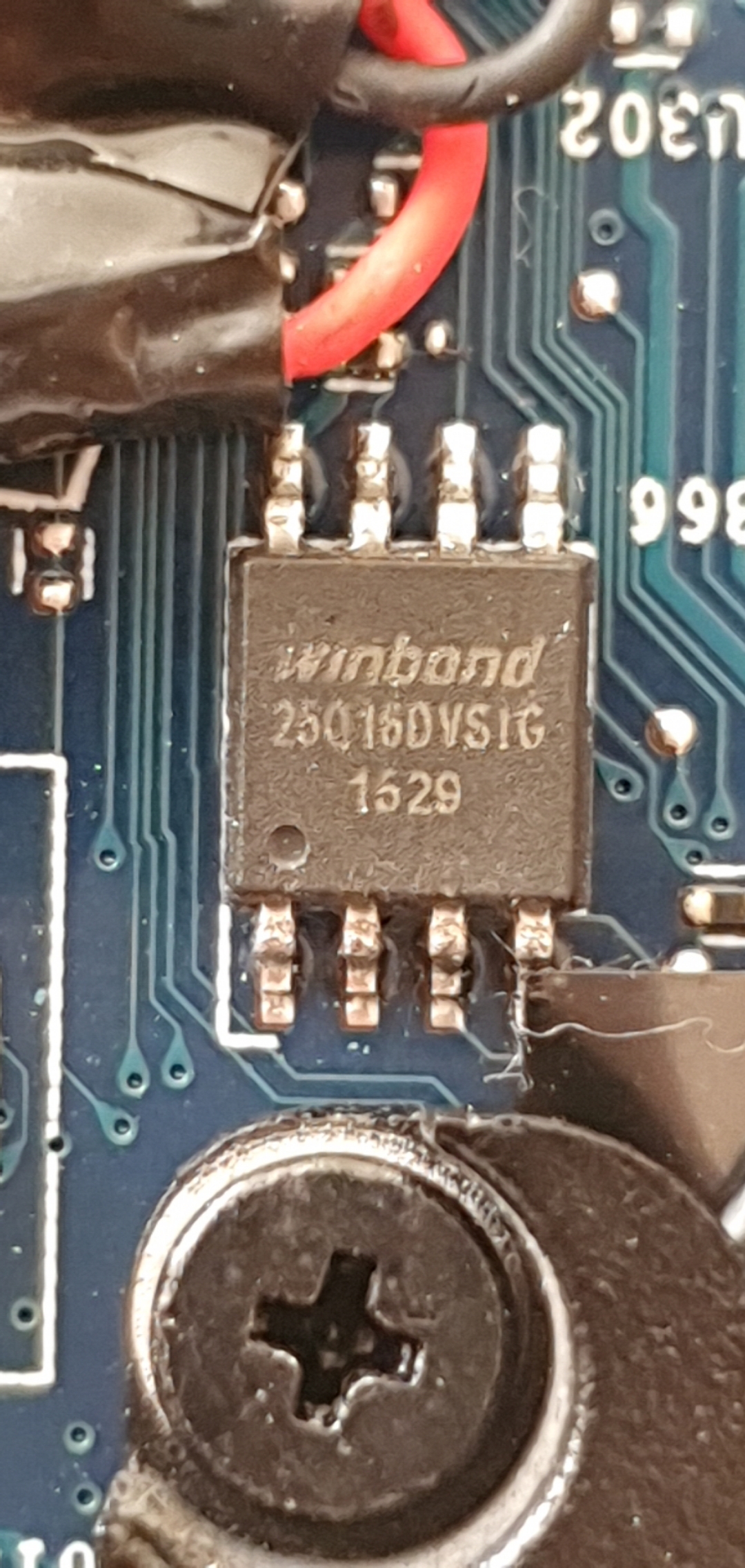

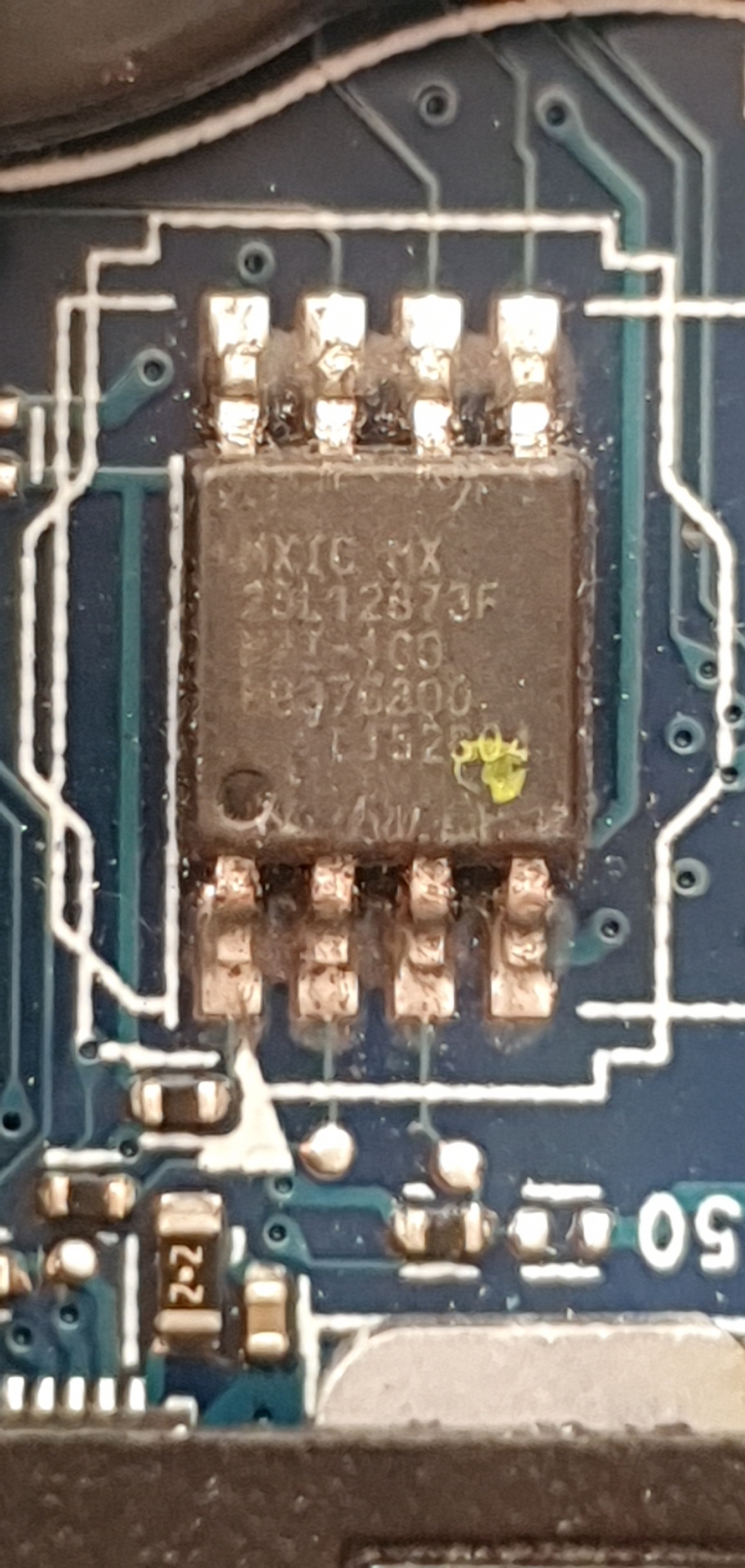

                    #529
                    Re: HP BIOS unlock tool
                    I used an old version of the 341A flasher that did not correctly identified the chip (only 2MB were read out of the chip). I put the dump into the HPunlocker and then I reflashed this 2MB unocked file into the bios chip. Of course now my notebook is not starting anymore. Only LED'S flashing. My Notebook is a HP 840 G2 i5200U.
                    Is it possible to fix the bios chip by reflashing an unlocked version of the bios from someone else?
                    Please advise.
                    If so, can someone send me the unlocked version of the 840 G2 i5200?
                    • peste
                      • Dec 2016
                      • 13880
                      • ROMANIA
                      #530
                      Please advise.
                      post the motherboard model ..
                      • delgado
                        • Oct 2020
                        • 8
                        • DE

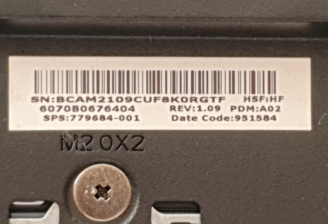

                        #531
                        it is a HP 840 G2 i5 5200U. It has 2 chips. See attachments.
                        • peste
                          • Dec 2016
                          • 13880
                          • ROMANIA

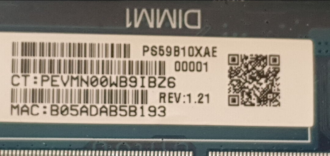

                          #532
                          motherboard model, look for something on the board of this shape 6050a2637901-mb-a02, written on the board with paint ..
                          • delgado
                            • Oct 2020
                            • 8
                            • DE
                            #533
                            A02 Board
                                  ...i did not remove the cover as I used a SOIC clip to flash. Do I need to remove the cover to find the MB number?
                                  yes..remove the cover and read on the motherboard, do not use the clip to read or write the bios chip ... you may have errors..remove the bios chip from the motherboard before reading or writing it ..
                                  • delgado
                                    • Oct 2020
                                    • 8
                                    • DE
                                    #537
                                    thank you for assisting.
                                    I fixed the problem by using a different fashing programm and still using SOIC clip.
                                    My recommendation is:
                                    CH341 V 1.29 programmer does not work correctly
                                    ASProgrammer does not wirk correctly
                                    NeoProgrammer 2.1.0.19 is working!
                                    I used clean 840 G2 Bios dump from another website:
                                    https://www.laboneinside.com/hp-elit...0-g2-bios-bin/
                                    Everyting works fine now & PW is gone!
                                    Thank you.
