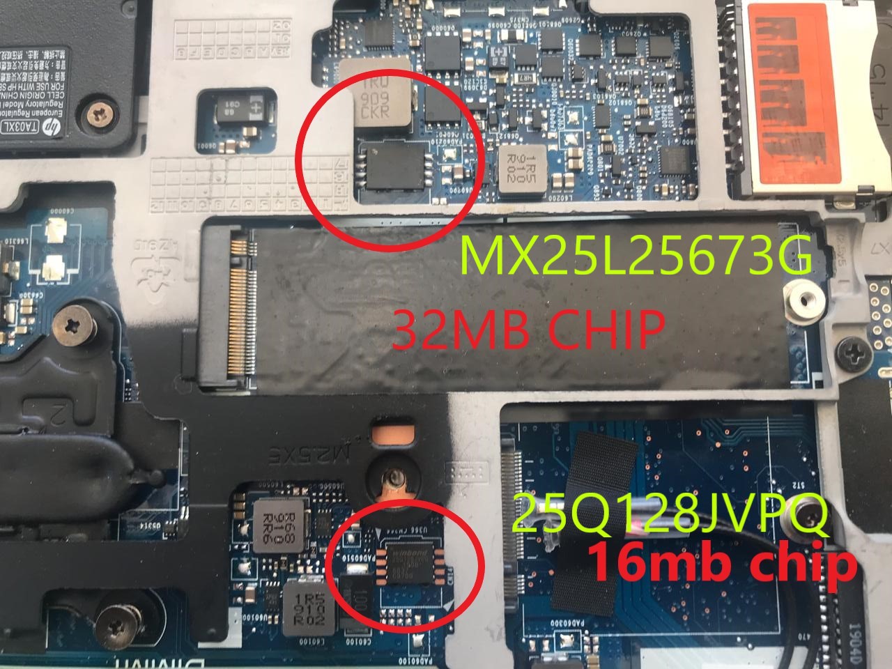

      Hi everyone, quick question: I'd like to avoid to desolder chip, since laptop si still under warranty for 6 months. For that, I'd like to dump EPROM with a clip (may not work, of course, since chip is still soldered).
      First, did you have success with an in-circuit reading? Second, do you know where I can purchase a clip, but not an SO type, but a QFN type? (QFN-8)?
      Thanks !

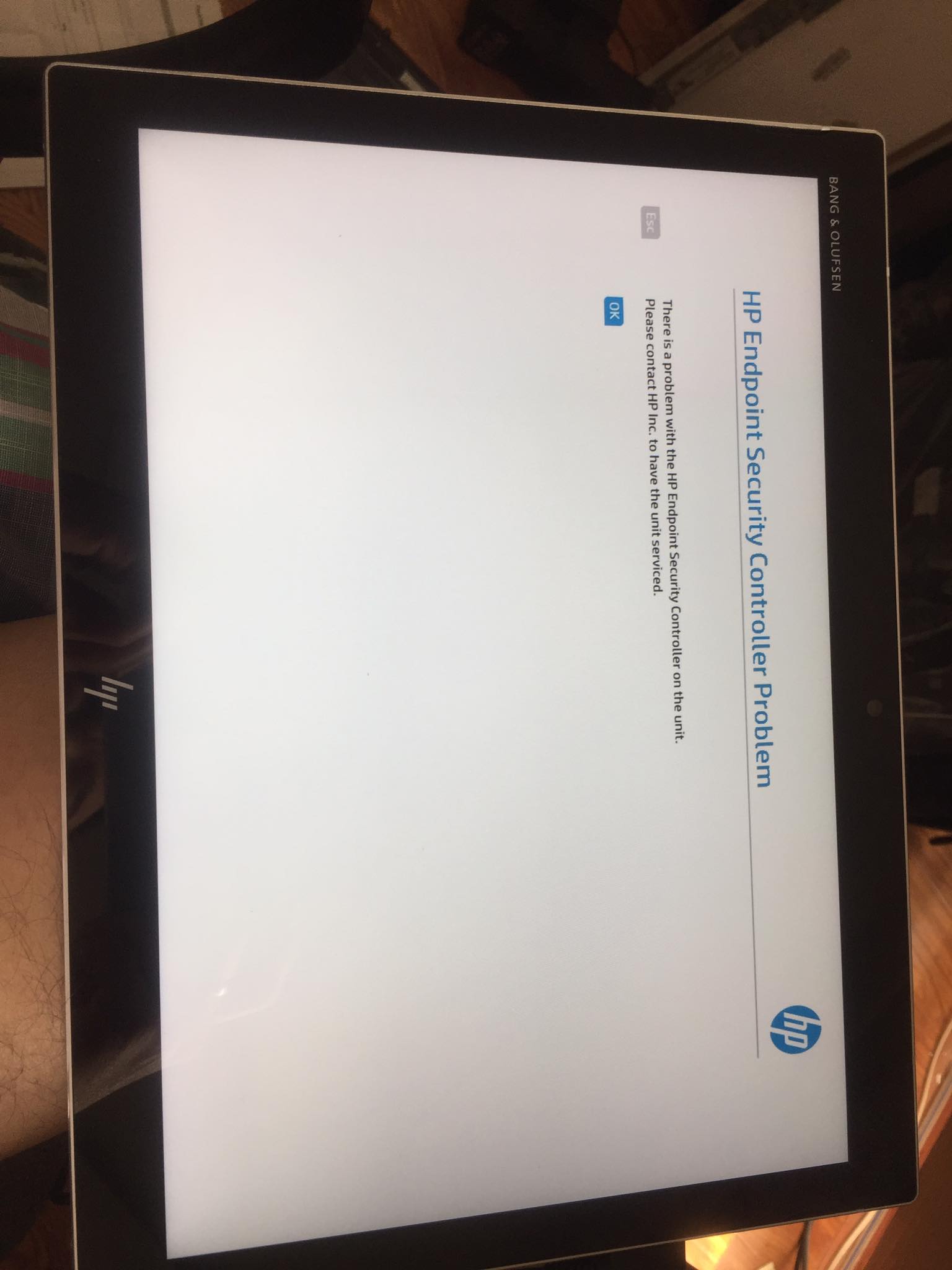

          Here is it Sir. Original Main and Ec bios file add below
          i has do it by myself: replace EC bios file (non pass) from another laptop, password is remove, but there are is problem when it turn on even when i clear ME Region Main bios.
          display showing
          "HP Endpoint Security Controller Problem
          There is a problem with the HP Endpoint Security Controller on the unit
          Please contact HP Inc. to have the unit serviced "
          Can you fix it to use for another Laptop bios password
          thanks you!

              First you would want to flash back both original files, just to see if that error disappears.
              let me know if it disappears, then I will try to patch correctly.
                it disappears sir. only aks for password

                  Try this and let me know if it works or has any issues. Flash only EC bios.
                  You will get an error first boot, just ignore it. Go to bios, reset security settings to factory default. If you can restart successfully without any errors then it works. Please let me know.
                    it working, password is gone. now i test it on another laptop and let you know how it going! many thank you to Sir!

                      Nice. Do not use the same file on another laptop, you will brick it. Make copies of both chips, just in case and just send the EC file here. It's a bit tricky to get it correct.
