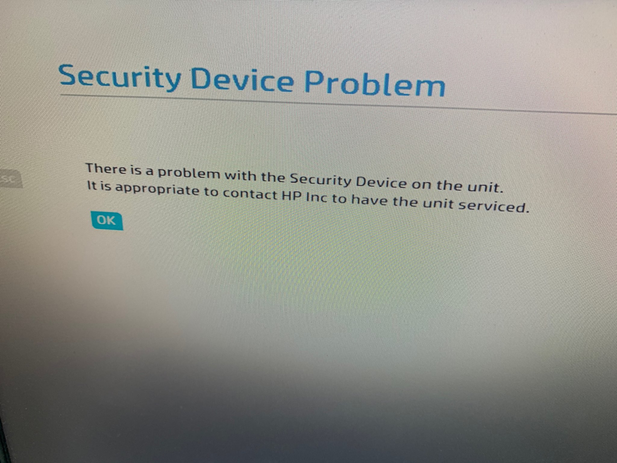

                        #451
                        Re: HP BIOS unlock tool
                        it's not work in Elitebook 830 G5 , plz help...

                          #452
                          Originally posted by itsmagic1
                          The tool works great for a HP 830 G5. It unlocks my Administration Password!
                          Thanx a lot!
                          can show me how u fixed it, i have same model but it not work..

                            #453
                            that's 2 file bios i found in motherboard
                            plz help...

                              #454
                              plz help...
                              try this if it works enter the DMI information

                                  #456
                                  i tried 2 file but it's not working , then i kept file 32M orig + file 16M (you fixed) -> it's work -> bios password removed
                                  But have a problem -> security device
                                  you have any solution , thanks

                                    #457
                                    try again with what I sent you to post # 454, the 33mb bios posted by you is longer, it can't work ... and be careful when writing ...
