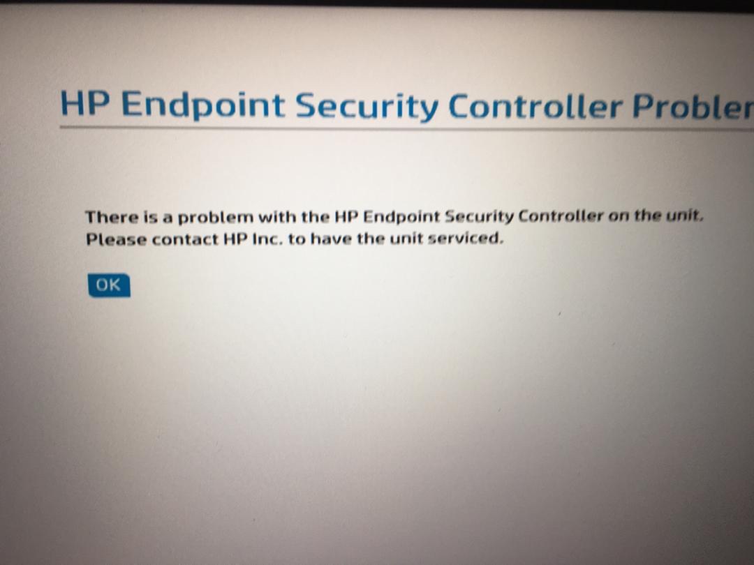

                            • Ghamidi
                              • Mar 2020
                              • 305
                              • France
                              #594
                              Re: HP BIOS unlock tool
                              i have elitebook 830 G6 when i refalsh EC i have this message in picture
                              any help Mr RethoricalCheese
                              thank you
