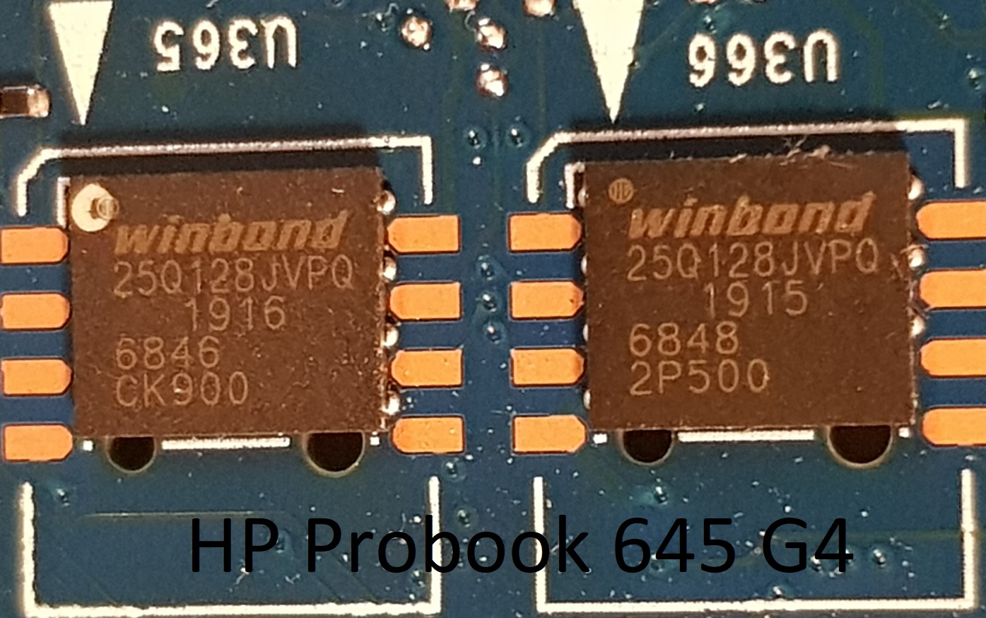

      #482
      Re: HP BIOS unlock tool
      Thanks.
      Is it the one to the right in the picture (without the dot) that needs to be reprogrammed?
      (Guessing from your reply to Kilroy2020)

          #484
          Originally posted by Mugatu
          Thanks.
          G4 is old style. Please dump both of them, add U366, U365 to names and upload them. I will unlock then. I just want to check something aswell.

            #485
            Will do when I have the tools for it, but it won't happen anytime soon I'm afraid.
            He had a G6 tho, #471.

                  #488
                  What I should have said was that the 645 G4 came at the same time as the 745 G5, after the 840 G5, and before the 840 G6.
                  The generations of 800 and 600 aren't synced, and the 600 doesn't even exist anymore. Maybe it doesn't matter..

                    #489
                    Oh yeah, totally true, already forgot that.
                    Really need to make a list about that so people would know which chip to dump. But I need lots of locked files for that, just to verify
