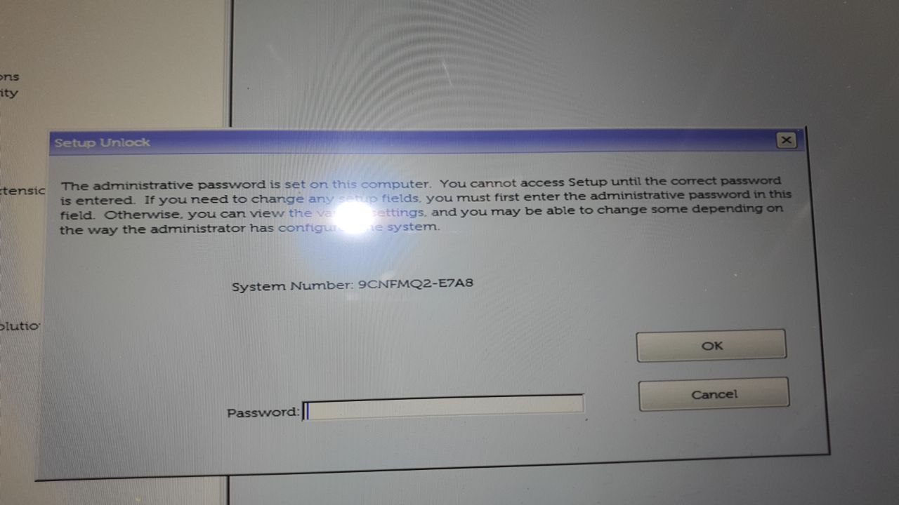

        hope someone can unlock mine? bios-pw(dot)org diddnt word for me, even not with ctrl + enter
        thanks in advance

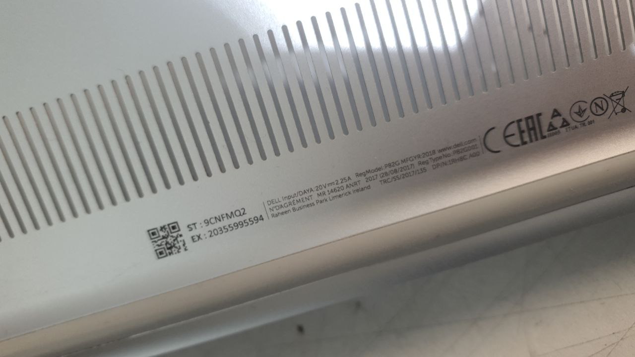

              service tag is wrote, but where is the suffix?
              is it -6ff1?
              you can find it in bios menu.

                  If this your code (9CNFMQ2-6FF1), so try this one:
                  Dk6akhkLDI[sMPIn
                  be careful with capital and small litters, use QWERTY (US) Keyboard and Use left CTRL then ENTER twice.
                  all donations are welcome,
                  • Verlengsnoer
                    • Sep 2016
                    • 109
                    • Netherlands
                    Re: Bios password Dell XPS 13 9370
                    Dk6akhkLDI[sMPIn

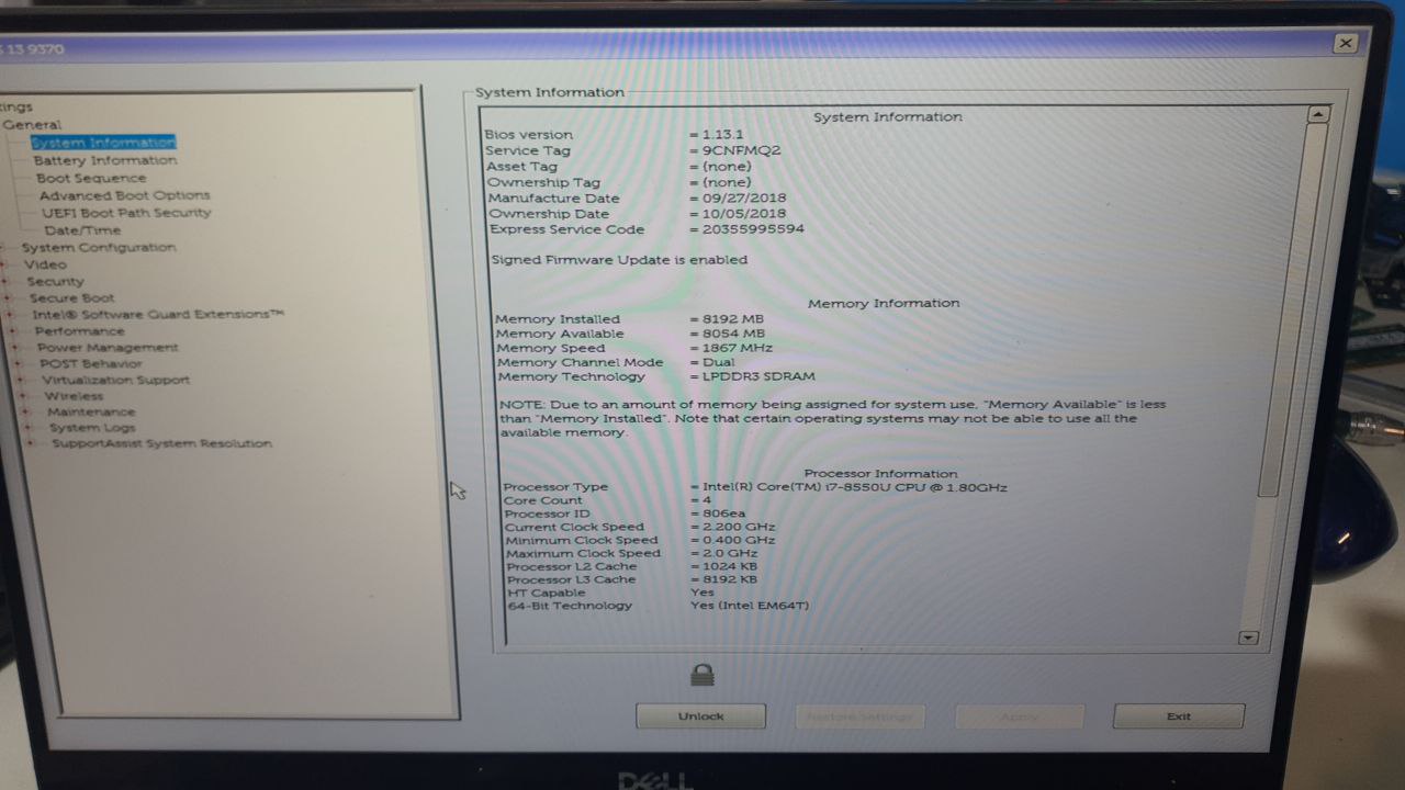

                    diddnt work sadly, here a screen of the bios, hope u can do something with it
                    • hoaca388
                      Badcaps
                      • Jan 2022
                      • 11732
                      After put "Unlock button " , what do you have ?
                      • Verlengsnoer
                        • Sep 2016
                        • 109
                        • Netherlands
                        then i get this

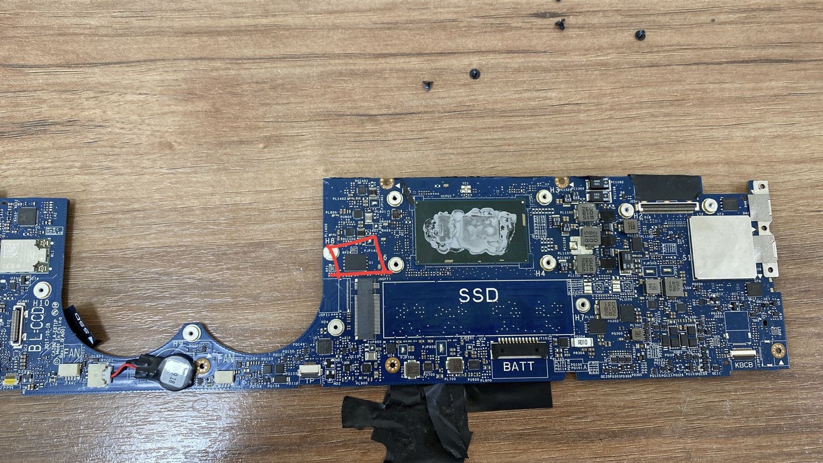

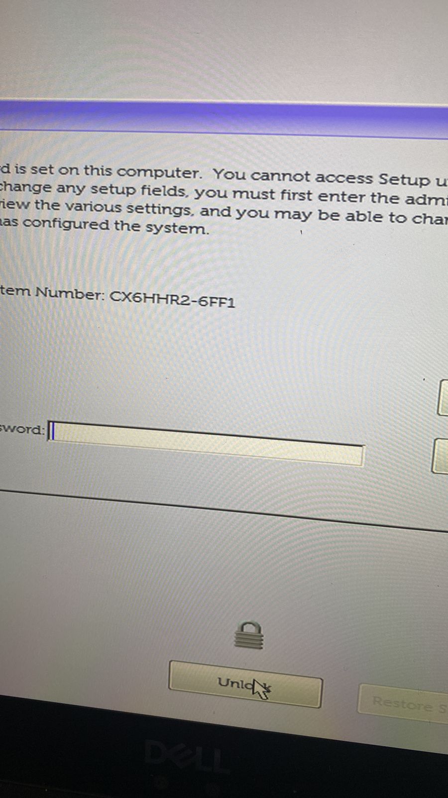

                                  hi, i need unlock 9370
                                  this is my service tag CX6HHR2-6FF1
                                  To read the bios is it the IC in the image or is it another one?
                                    • 20873
                                    Havn`t you tried unlocking it with the password generator.Have you read post #2 ?

                                      Yes, sure
                                      I have tried that method, it doesn't work for me
                                      • volinakis
                                        • Jan 2021
                                        • 2728
                                        • N/A
                                        Yes, sure
                                        use external USB qwerty keyboard
