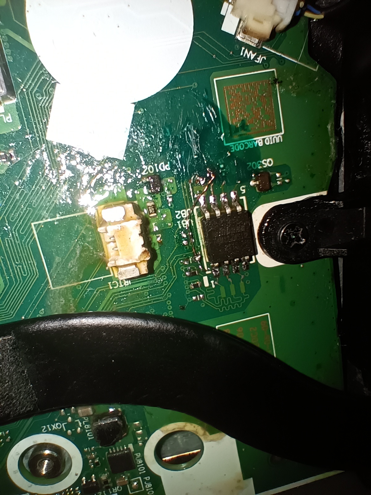

    Hello bro, I need help
    Lenovo laptop with board code like the picture I uploaded, but I can't give you the complete type of laptop because the sticker on the laptop has come off.
    I had a laptop no display problem after updating Windows, then I flashed the bios IC with the file here, the laptop indicator flashed, please repair my old bios file bro, thx

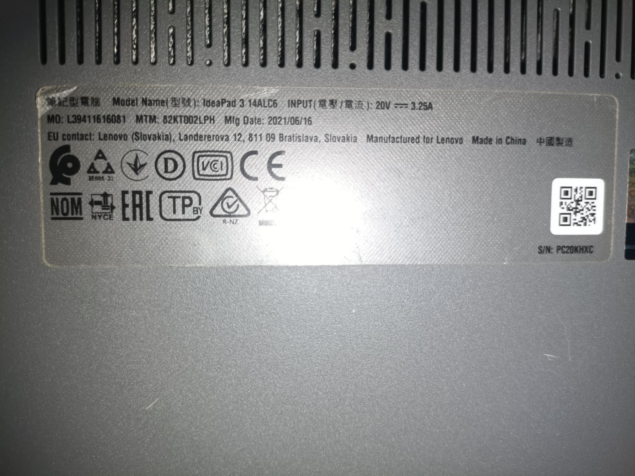

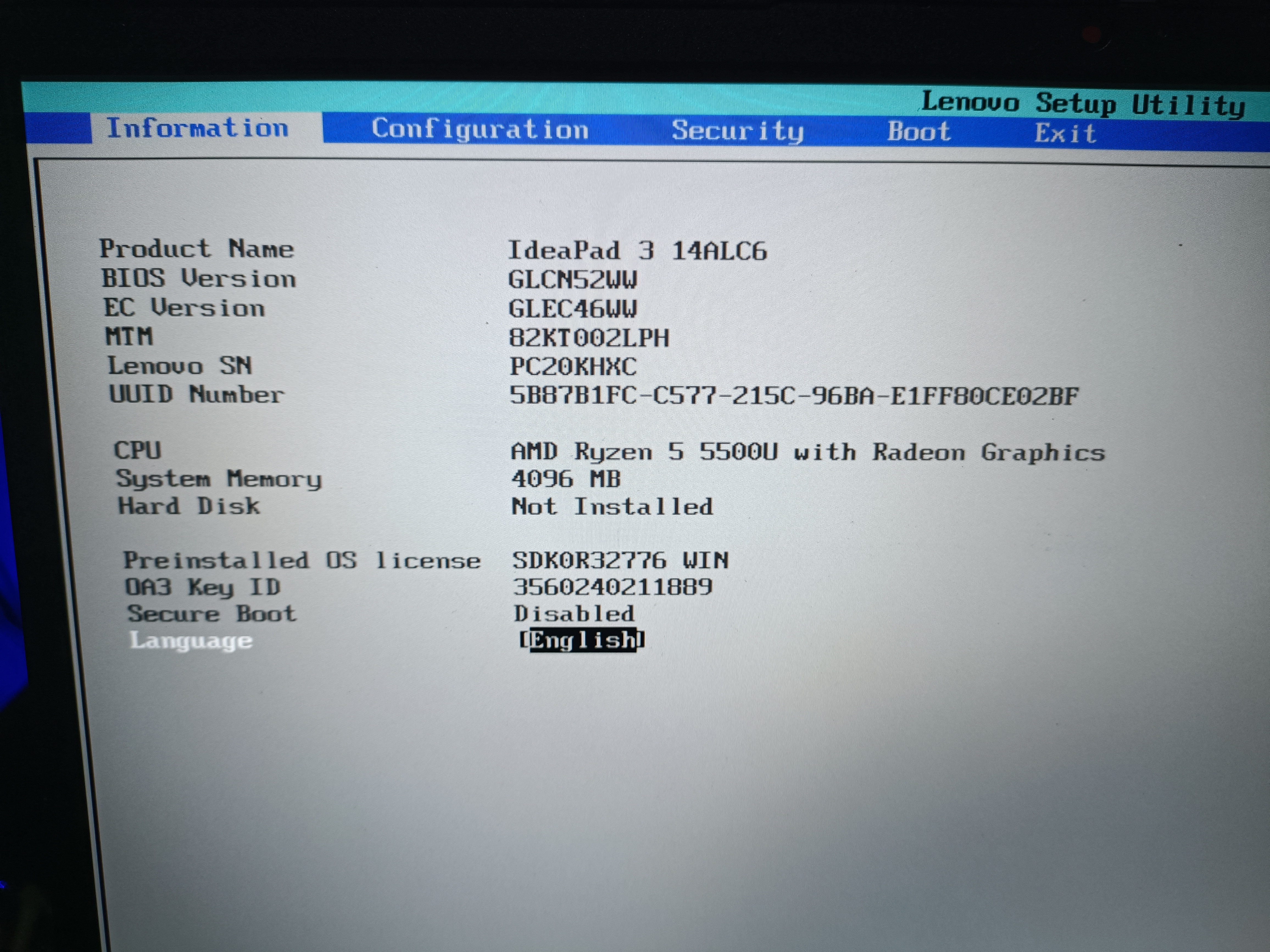

      Hello everyone just new here on badcaps and find this same issue with you. Blackscreen stable power led
      BOARD NUMBER : HS461&HS561&HS761 NM-D521 Rev 2.0
      MO: L39411616081
      MTM: 82KT002LPH
      S/N: PC20KHXC
      Here is my Backup OLD BIOS. Tried copying the DMI : 1000h --> 2FFF But those are valued from 1000 FF only I assume this is corrupted also
      Can you please help me add my S/N to the bin on virgin # 56 post

        use the HxD program (you can find it for free)..include both bios in it and copy that interval where the DMI information from the original bios is found in the bios from post#56...(copy-paste)...

          If you can`t use a hex editor use the script in this post to add it https://www.badcaps.net/forum/troubl...08#post1605508

ID:	3304997​​​​​update everyone. This unit came from other computershop and the BIOS it came is Winbond but the voltage is 3.3v i assume this was replaced. will it work if the Bios chip is 3.3v instead of winbond that have 1.8v or do I buy that 1.8v bioschip

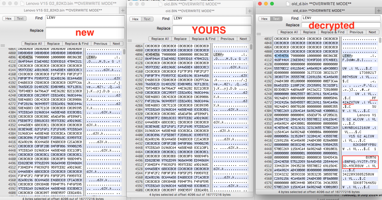

              Hello maybe any can repair my bios?
              Model: V15 G2-ALC Laptop (Lenovo) - Type 82KD
              S/n:PF42AZVT
              BOARD: HV461&HV561 NM-D522 REV: 2.0
                S/n:PF42AZVT

                  #108
                  try
                  Its working but no s/n nothing and no os license key
                    I made the transfer of DMI to new bios. DMI is encrypted as you see in picture. try this one:

                      #110
                      Thanks!!

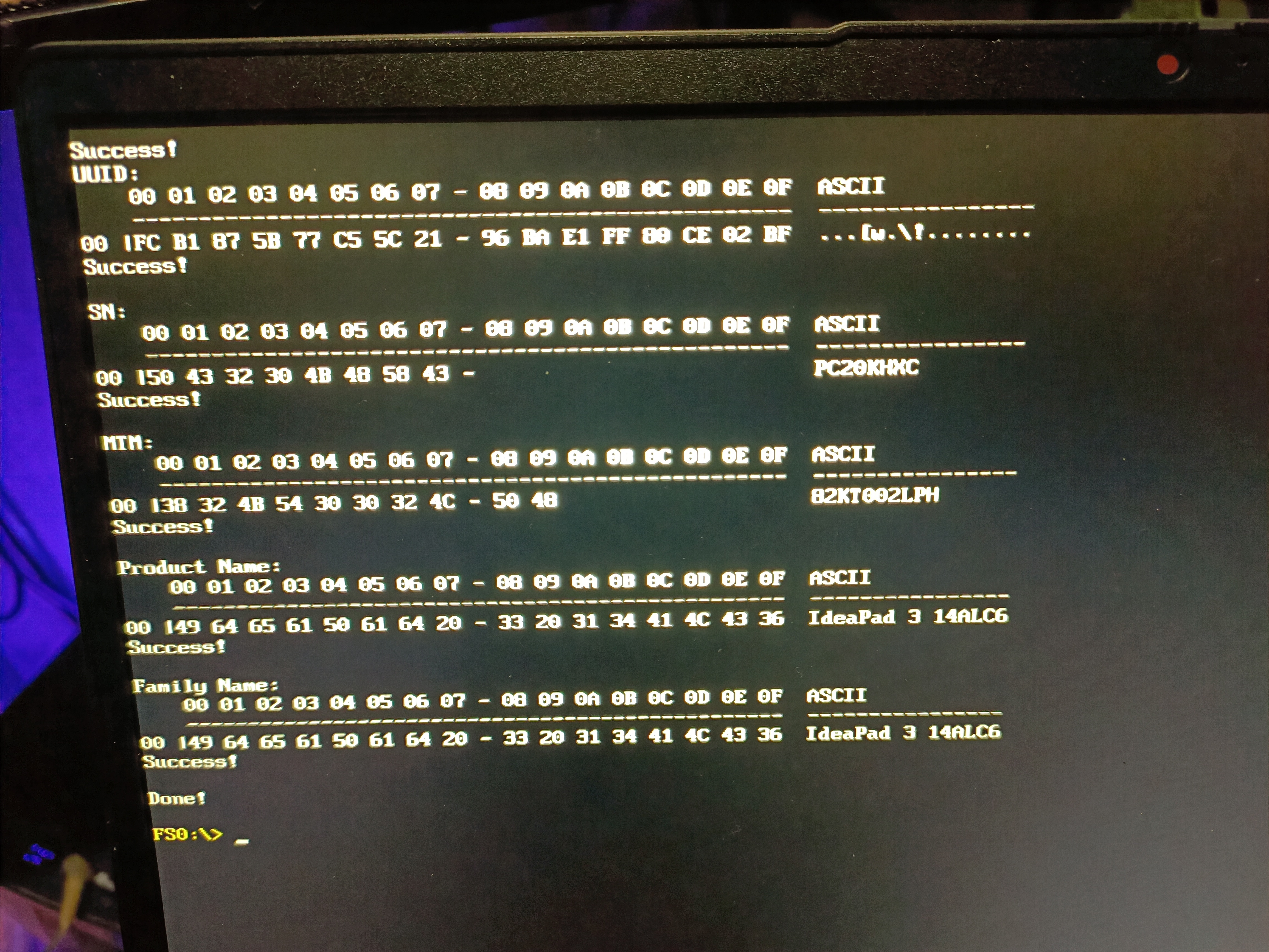

                        Originally posted by martindlm
                        Re: Hs461 hs561 hs761 nm-d521 rev 2.0 bios plz
                        Hello, I share a dump extracted from a working nm-d521 board.
                        Hello Martindlm thanks for the dump my laptop is working now
                        • Alexander Inciong
                          • 4
                          • Philippines
                          #112
                          I successfully replace my S/N ,MO and MTM via tool called Lenovo GoldenKey U1 Tool. Thank you again everyone the laptop works great now

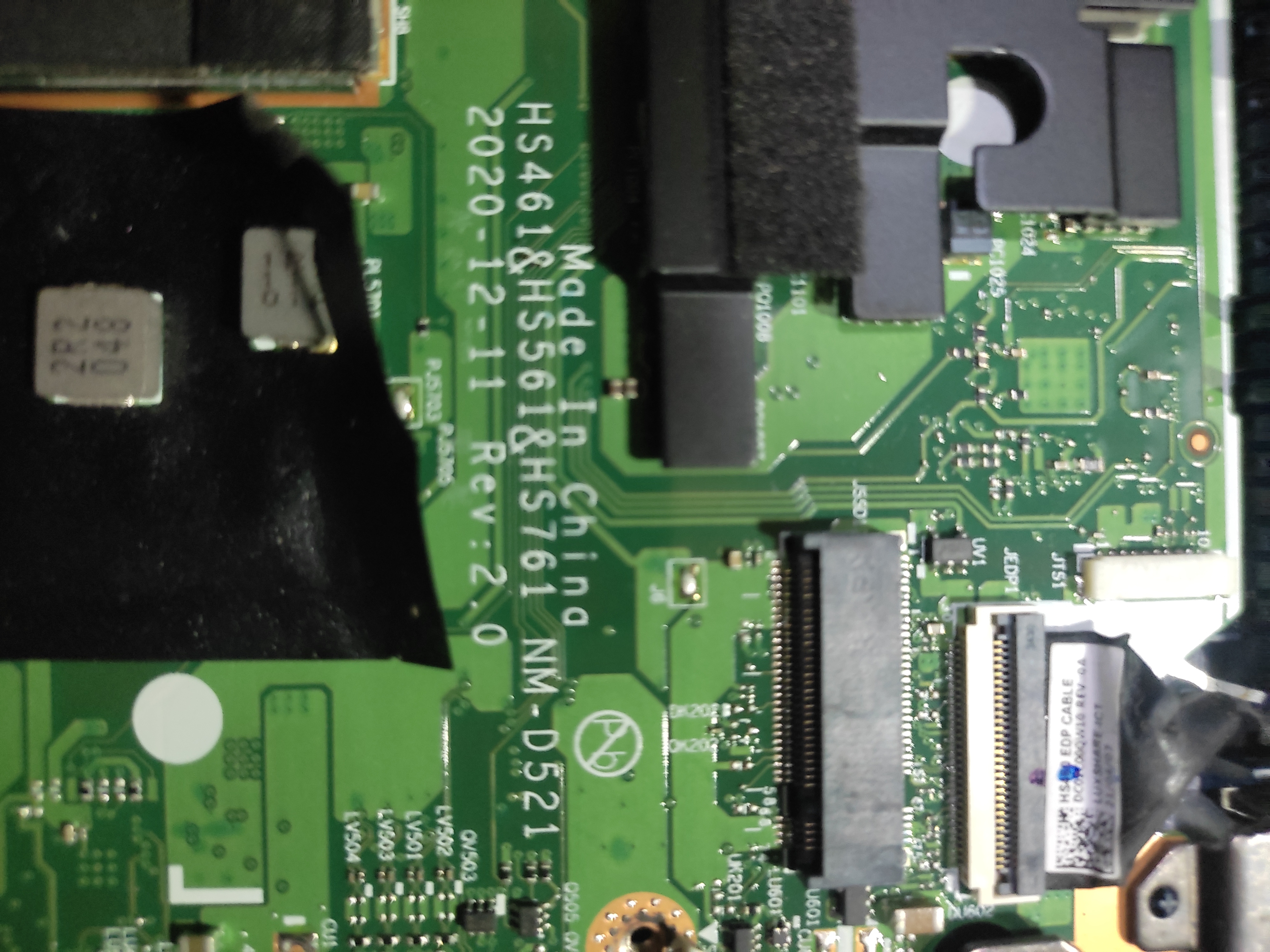

                                please bios my laptop lenovo ideapad 3 15ALC6
                                S/N : PE08RDEC
                                MO : PE9012311000
                                MTM : 82MF0004BR
                                Board: HS461$HS561$HS761 NM-D521
                                2020 - 12 - 11 REV 2.0
                                I don't have an old bios

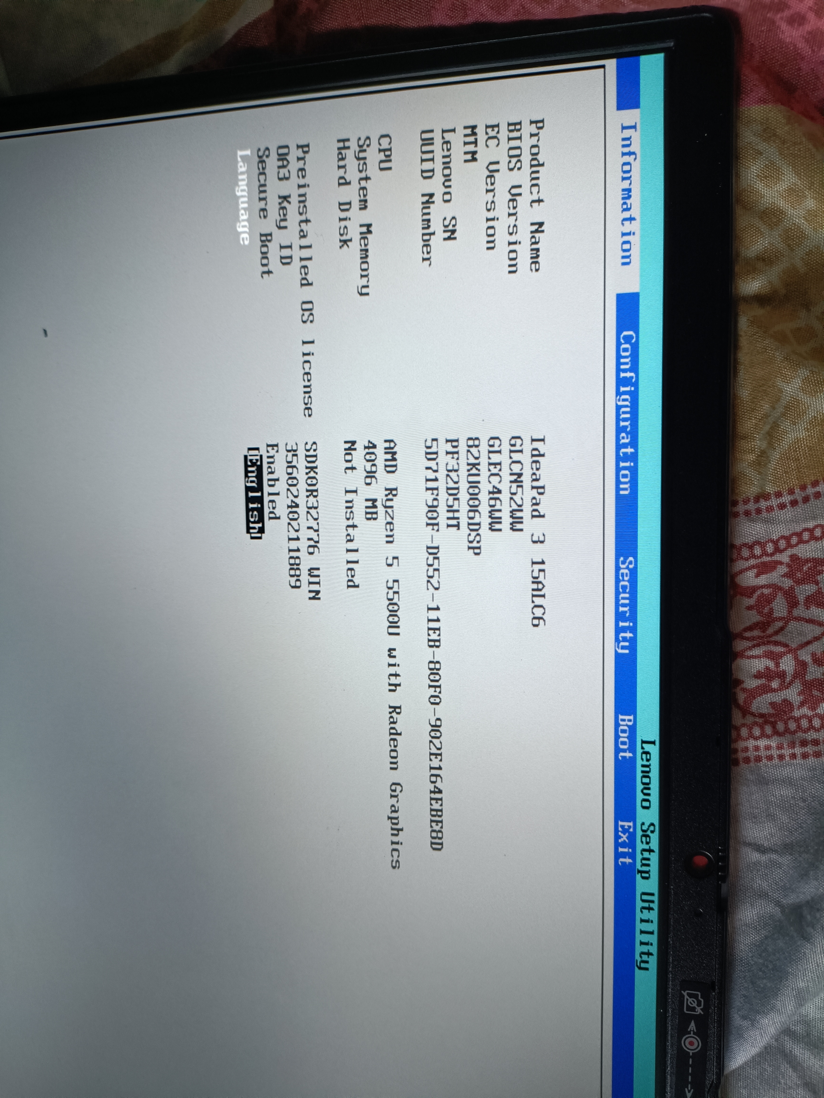

                                  S/N : PE08RDEC
                                  MO : PE9012311000
                                  MTM : 82MF0004BR
                                  Ryzen 7-5700U
                                  try this one from a working board change the seral number using U1 TOOL https://www.badcaps.net/forum/troubl...r-bootable-usb
                                      Could someone do this procedure for me? I'm Brazilian and I don't know how to use this app mentioned
                                      did you already flash the bin file? did the laptop power on and display?
