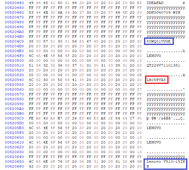

                                    My V510-15IKB starts, but no image on display. Work perfect with external display (HDMI)
                                    I already change display and LCD cable, but same result.
                                    Maybe bios probleme here. I was try some dumps from here, but not work.
                                    On Lenovo download site, I found only BIOS UPDATE and I can't extract bin from there.
                                    Can anyone help me with new bios bin, or repair the original?

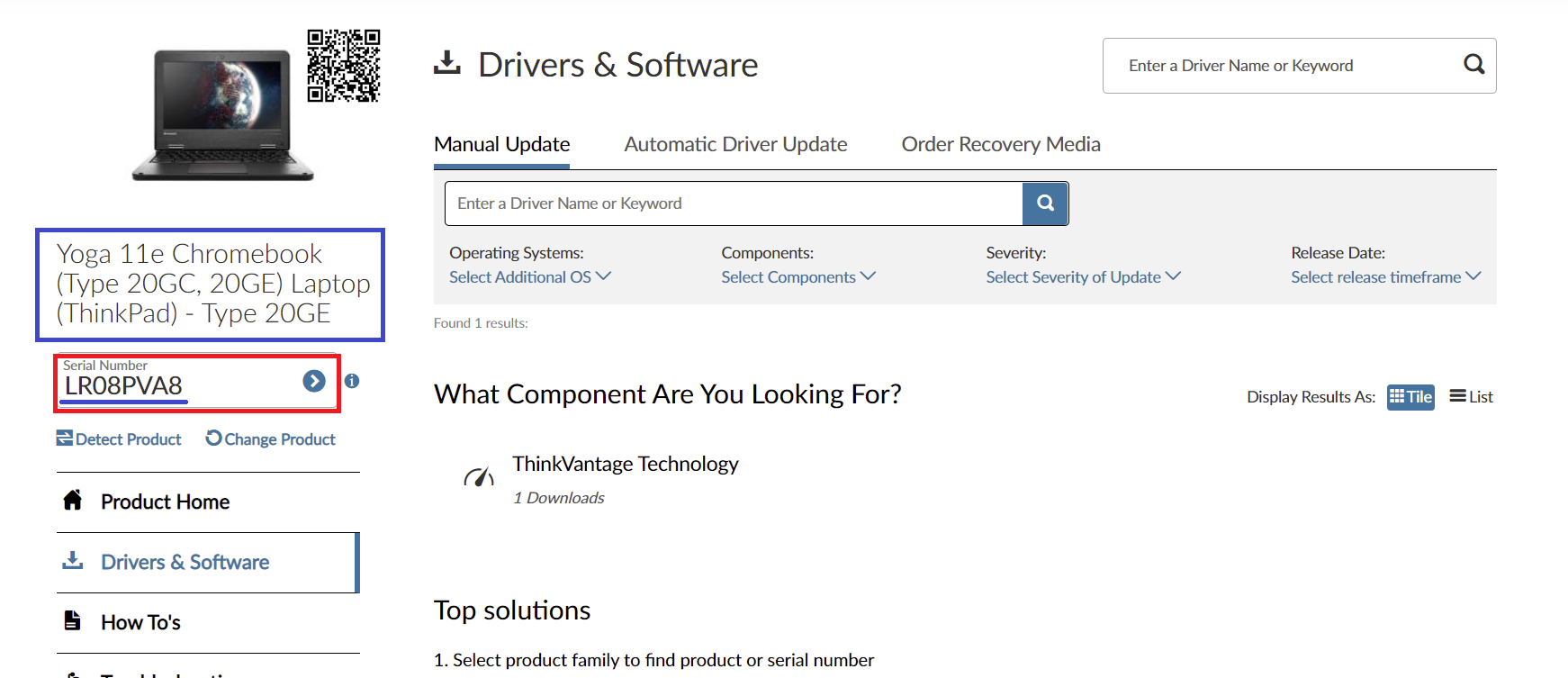

                                    • hoaca388
                                      Badcaps
                                      • Jan 2022
                                      • 12178
                                      Re: Lenovo V510-15IKB LV6 corrupted BIOS
                                      LENOVO V510-15IKB
                                      Model Name: 80WQ
                                      MTM: 80WQ01VUGE
                                      Thank you!
                                      I searched by serial number LR08PVA8, got Yoga 11e Chromebook (Type 20GC, 20GE) Laptop (ThinkPad) - Type 20GE and no bios. Strange, where did I go wrong?

                                      • danro
                                        • Aug 2011
                                        • 54
                                        • Serbia
                                        Hi, thanks for answer.
                                        For sure is V510-15IKB. On the bottom case is a sticker with SN: LR08PWA9, ID:CS20, MO: LRNXB741000W.
                                        The spi flash was come with solder/desolder traces, so maybe not original content or have some modified blocks
                                        If need other info, please let me know
