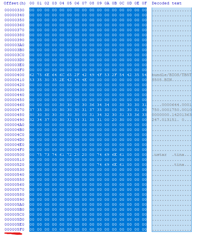

    Hello, the bios on my Lenovo TD350 ThinkServer got corrupted during a bios update, the bios restore function killed the Server.
    I need to flash the bios inside the MX25L12835F SOP8, i have already desolder the chip and solder it into my SOP8 adapter and read it with a ROM programmer.

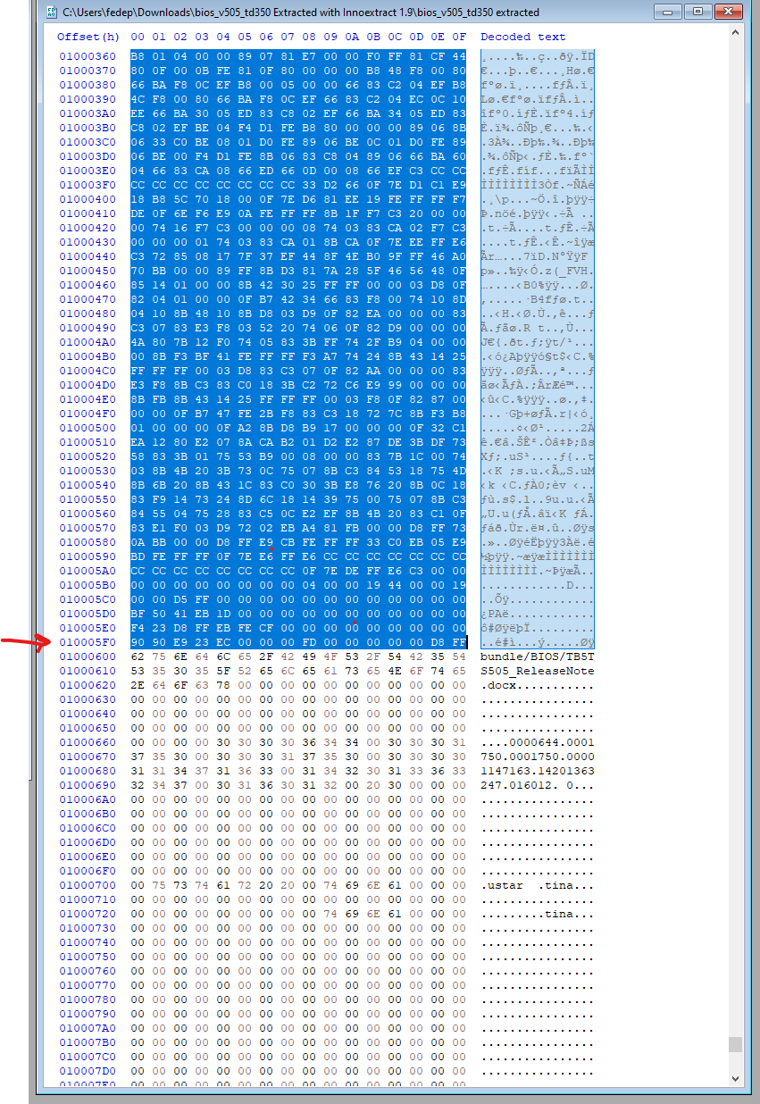

    I use the innoextract 1.9 software to extract the bios file from the .exe file that i download from lenovo website, can you help me edit the Hex file (removing the Index part and resize the file)?
    This guy claim to have done it https://forums.lenovo.com/t5/ThinkSe...up/m-p/5123818 but he did not mention the bios file modification.
    I have also attached the "corrupted" 1.5 bios version rom that i backup to compare it.
    Thank You

      I was able to revive the server by removing this parts of the file, (see the attachments), flashing it to the ROM and Re-soldering it to the Motherboard.
      Now the Server works and it's updated to the last BIOS version!
      The dimension of the file should be exactly 16384KB.
