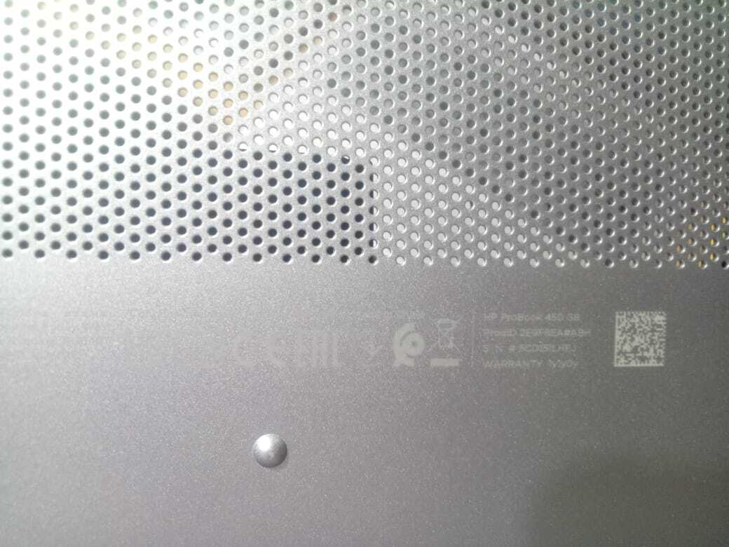

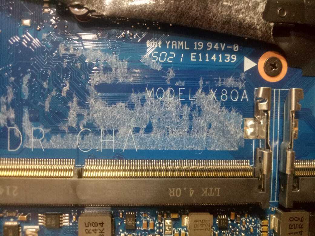

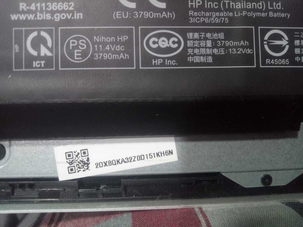

                Please post some pictures with labels from back cover and under RAM slot.
                Like this...
                Click image for larger version  Name:	IMG_0711.jpg Views:	0 Size:	927.9 KB ID:	3219543
                Thank You.

                    Thanx bro but Mr Nobody sent these pictures for just an example .....these pictures for 840 G5 not for my model my model is 450 G8 ....Thanx for your help

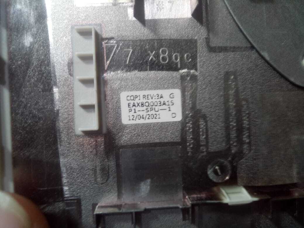

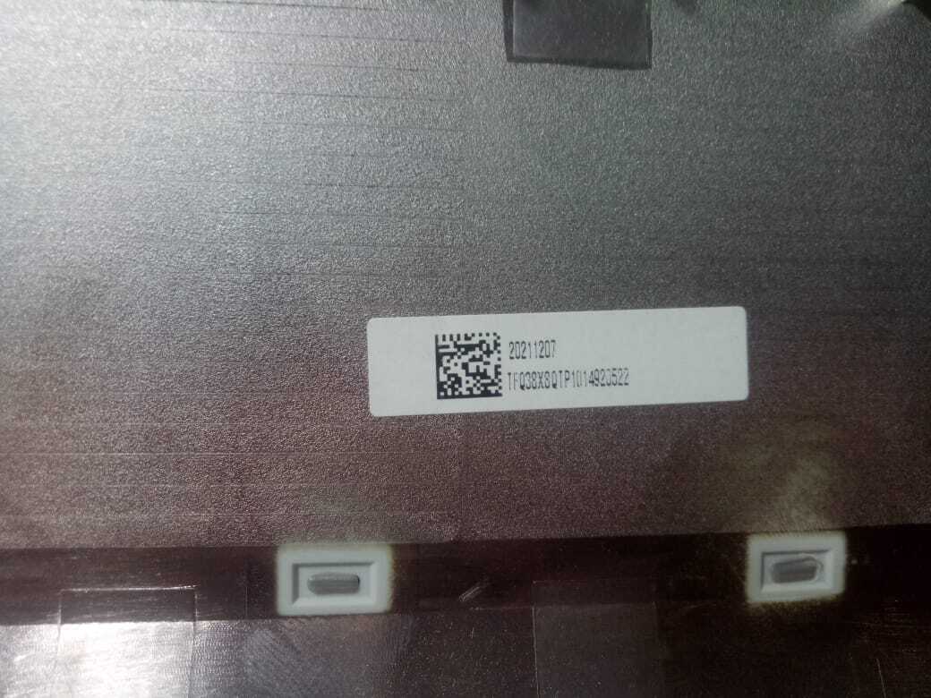

                      Hey bro these are images for my model ......
                      Hp Probook 450 G8
                      SN # 5CD151LHFJ
                      PRODUCT ID # 2E9F8EA#ABH
                      Click image for larger version  Name:	WhatsApp Image 2024-02-21 at 12.17.47 PM (1).jpg Views:	0 Size:	74.7 KB ID:	3220438 Click image for larger version  Name:	WhatsApp Image 2024-02-21 at 12.17.45 PM.jpg Views:	0 Size:	67.7 KB ID:	3220439 Click image for larger version  Name:	WhatsApp Image 2024-02-21 at 12.17.47 PM.jpg Views:	0 Size:	80.3 KB ID:	3220440 Click image for larger version  Name:	WhatsApp Image 2024-02-21 at 12.17.49 PM.jpg Views:	0 Size:	57.5 KB ID:	3220441 Click image for larger version  Name:	WhatsApp Image 2024-02-21 at 12.17.48 PM.jpg Views:	0 Size:	97.1 KB ID:	3220442
