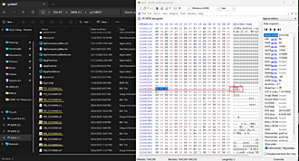

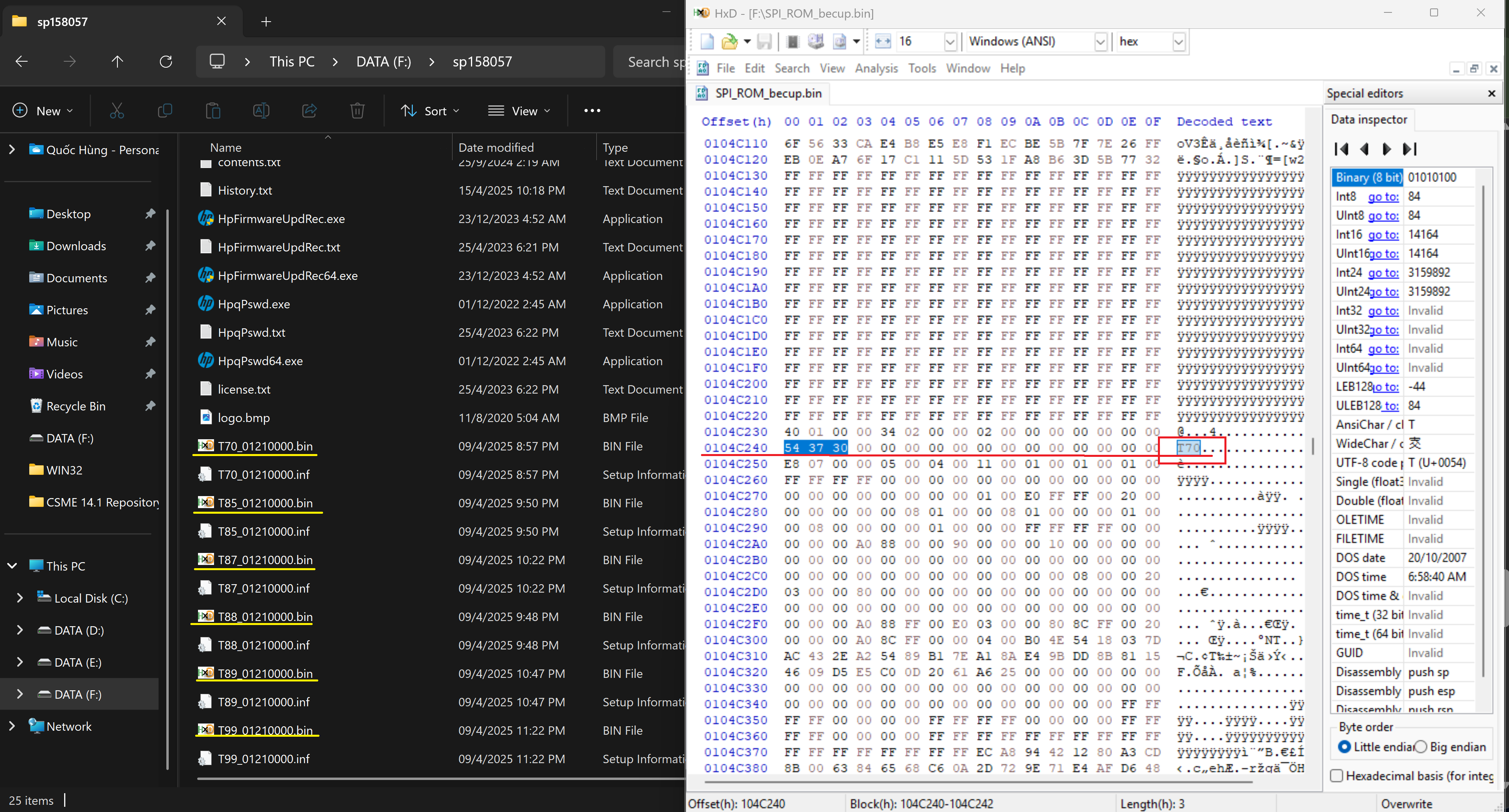

                  #228
                  @Keg85 : Your version is T70, please find the correct version.
Name:	2025-07-14 09_03_17-Settings.png
                  • Keg85
                    • Jul 2017
                    • 3
                    • Russia
                    #229
                    Maybe someone has a suitable version for EC (bid T70)? I've tried many files from this thread, so far without success.
