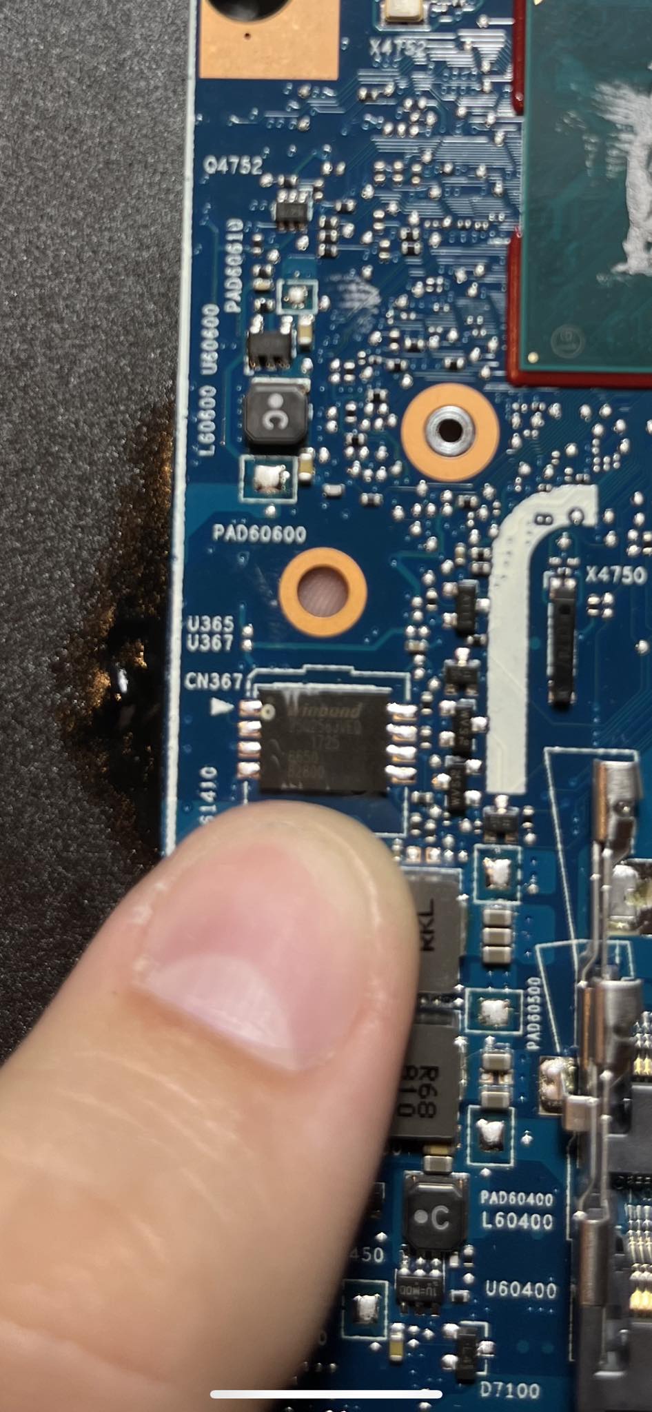

      Hello people
      I need help, I need to unlock the bios on my hp, but I don't see the bios chip, does anyone have a picture where I can find it. thank you in advance.
      • peste
        • Dec 2016
        • 13924
        • ROMANIA
        #43
        Re: HP ProBook 650 G4
        Originally posted by ribar96
        Hello people
        well, you'd better post clear pictures of the motherboard on both sides..

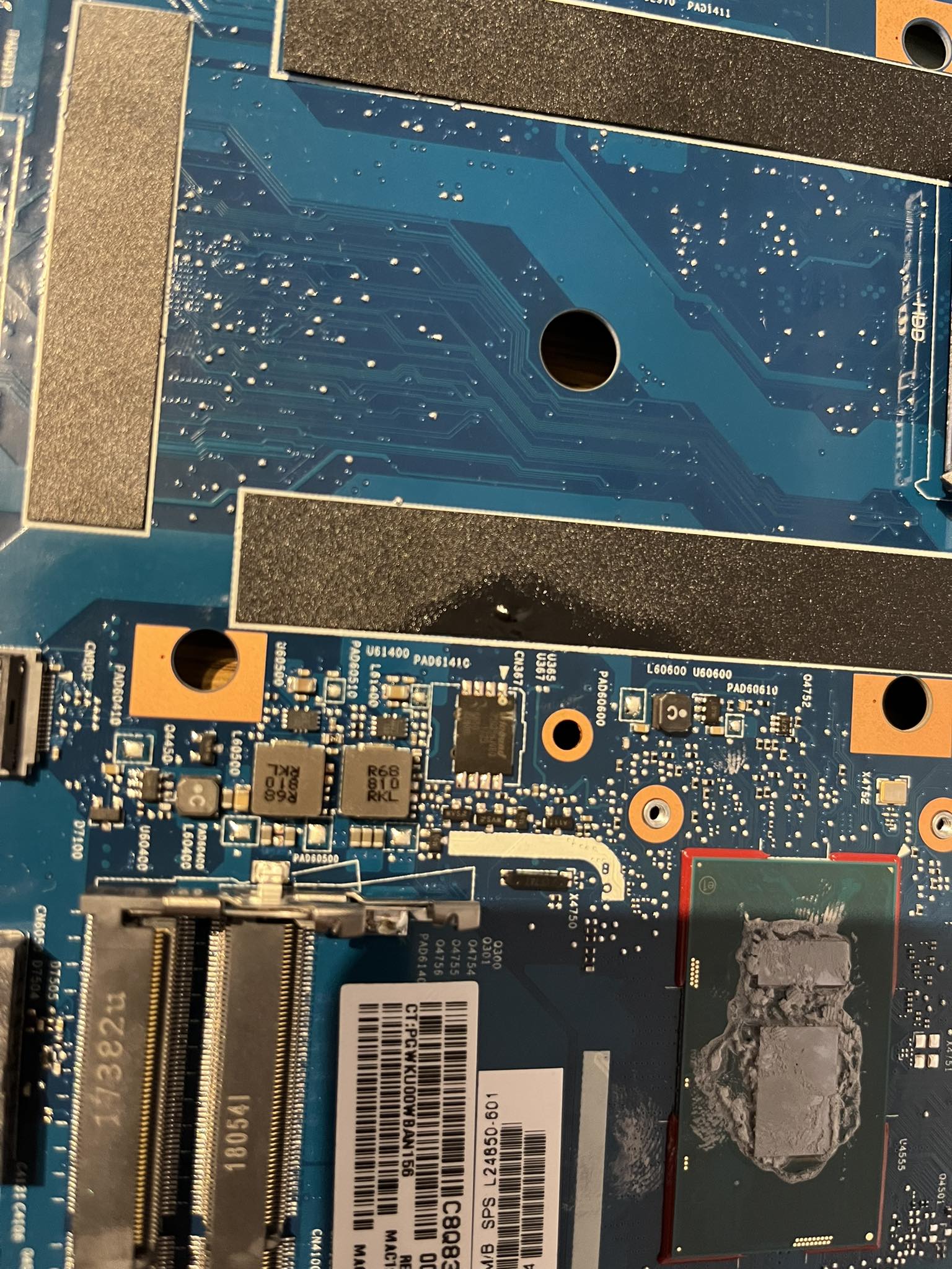

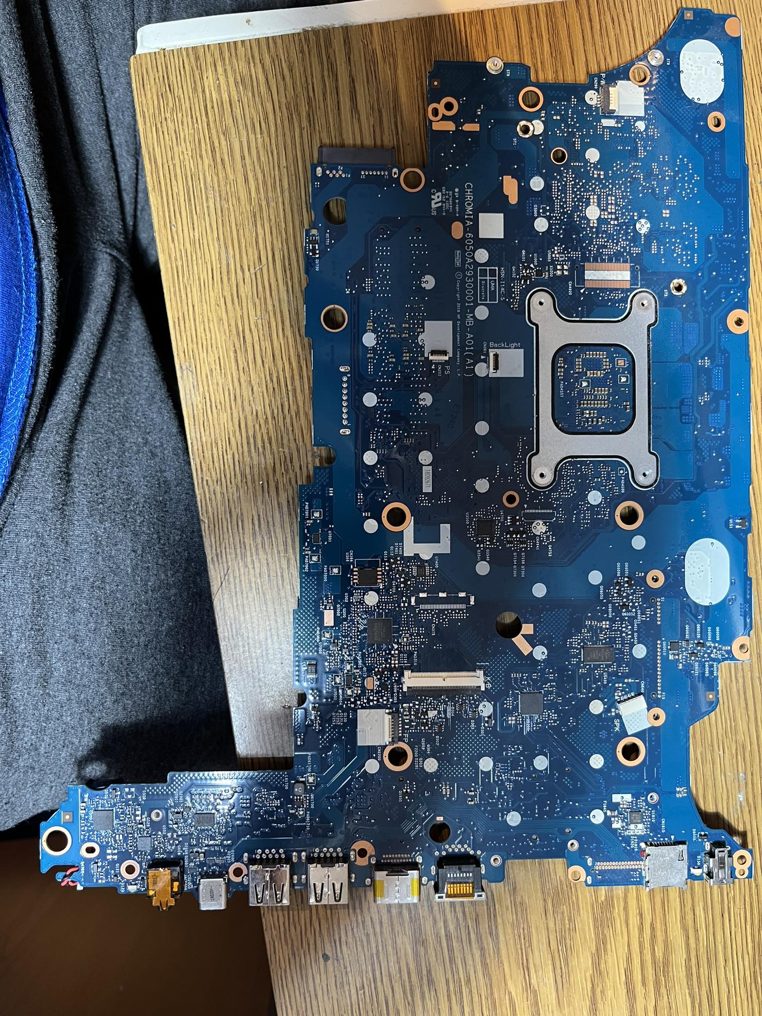

          #44
          attached is a picture of the motherboard, and the label is
          CHROMIA-60650A2930001-MB-A01(A1)
          You can see on the board where I was trying to remove one chip it said winboard, but I'm not sure if that's it.
            • 22293
            #45
            Post the part number etched onto both of the WSON8 chips.

              #46
              you mean these two chips. thanks in advance
                • 22293
                #47
                Yep ,backup the 25Q128 chip. If its only got an admin pass RCUnlocker will unlock it.If it has a user pass as well backup the other chip and post both. Please post the laptop serial number,its required.You`ll find links to RCUnlocker if you read - https://www.badcaps.net/forum/showthread.php?t=103570
