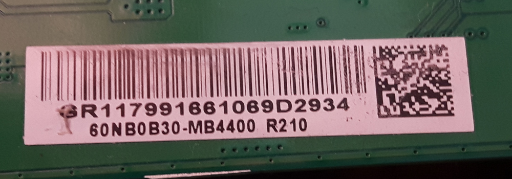

    Hi Asus F540S, mb X540SA Rev2.1, SR2KN (Celeron N3060). lightly flooded with fluid. Cleaned. I need bin bios, bios from this site doesn't work. Only led light flashing, no screen. The current consumption oscillates between 10 - 180mA Bios I find from elektroda.pl, this bios charges the battery but the rest remains unchanged. I think there are bios files for Pentium discs available here. I don't know if it matters and if I'm right.

    Post a good clear picture of the motherboard sticker with the barcode on it

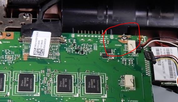

        Try this one ,and put the screw in thats circled in red .

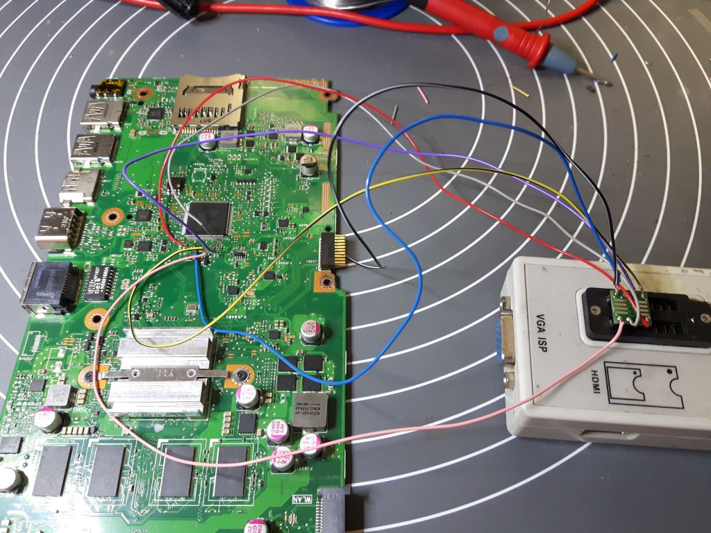

          Thank you, now board current consumption oscillates between 10 - 100mA (battery charging adds ok 0,6A). I have an RT809F programmer, it is possible that I will program KB902QF with it by selecting KB9022 but I have to do it in the socket. This will take some time if possible. I will give a report.

            Re: Asus F540S

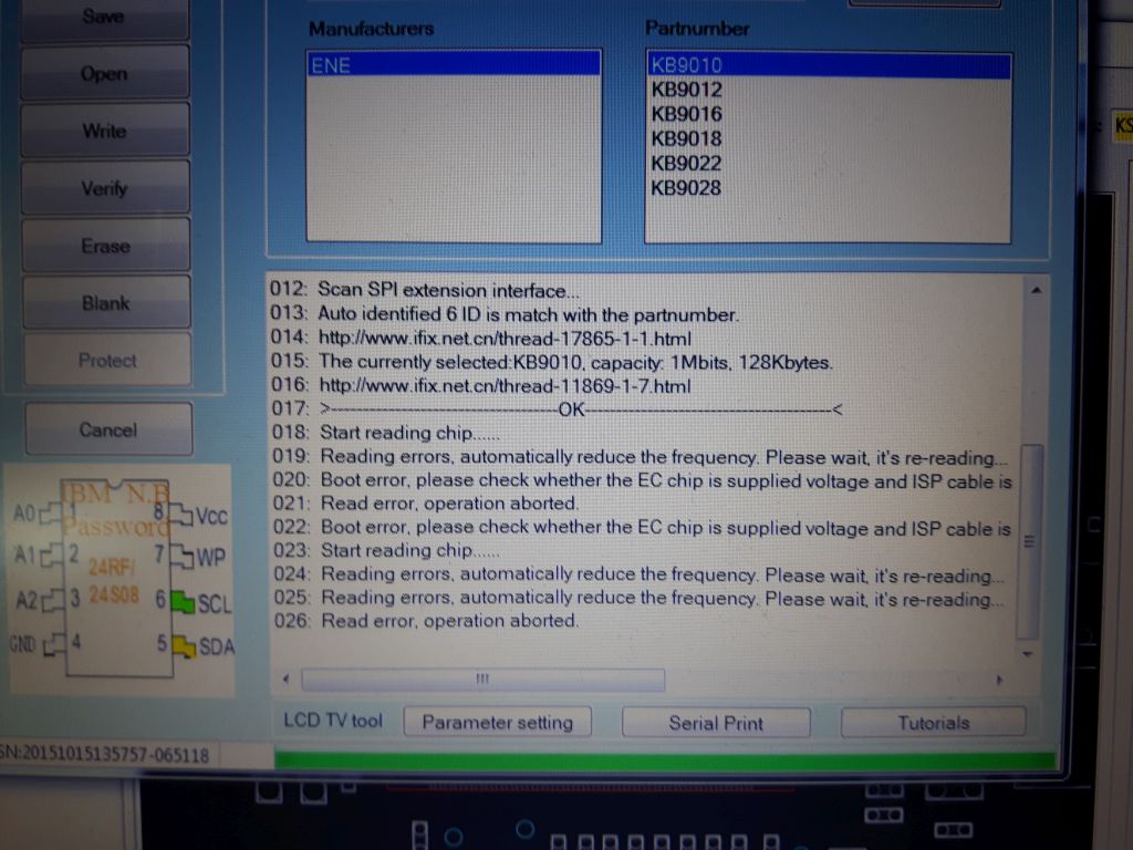

            I try programm KB902FQ with RT809F but no succes.
            I use boardvew ASUS X541SA REV2.0 to identification KB902FQ.
            the programmer recognizes the chip as KB9010 but not read.
            In picture first answer programmer when board without power 19V.
            any solution ?
            My soft RT809F 20210410. Board supply 19V.
