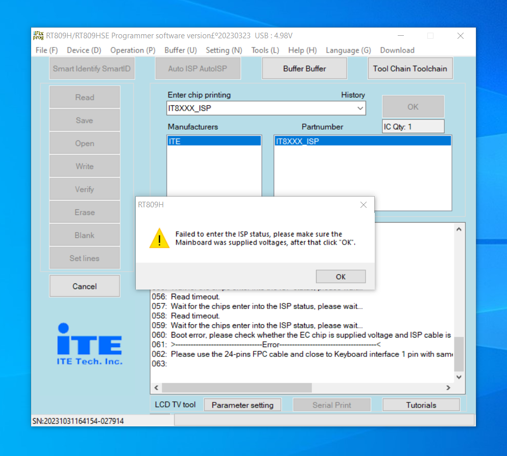

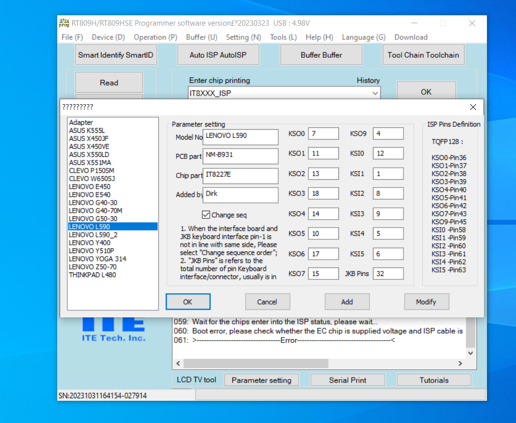

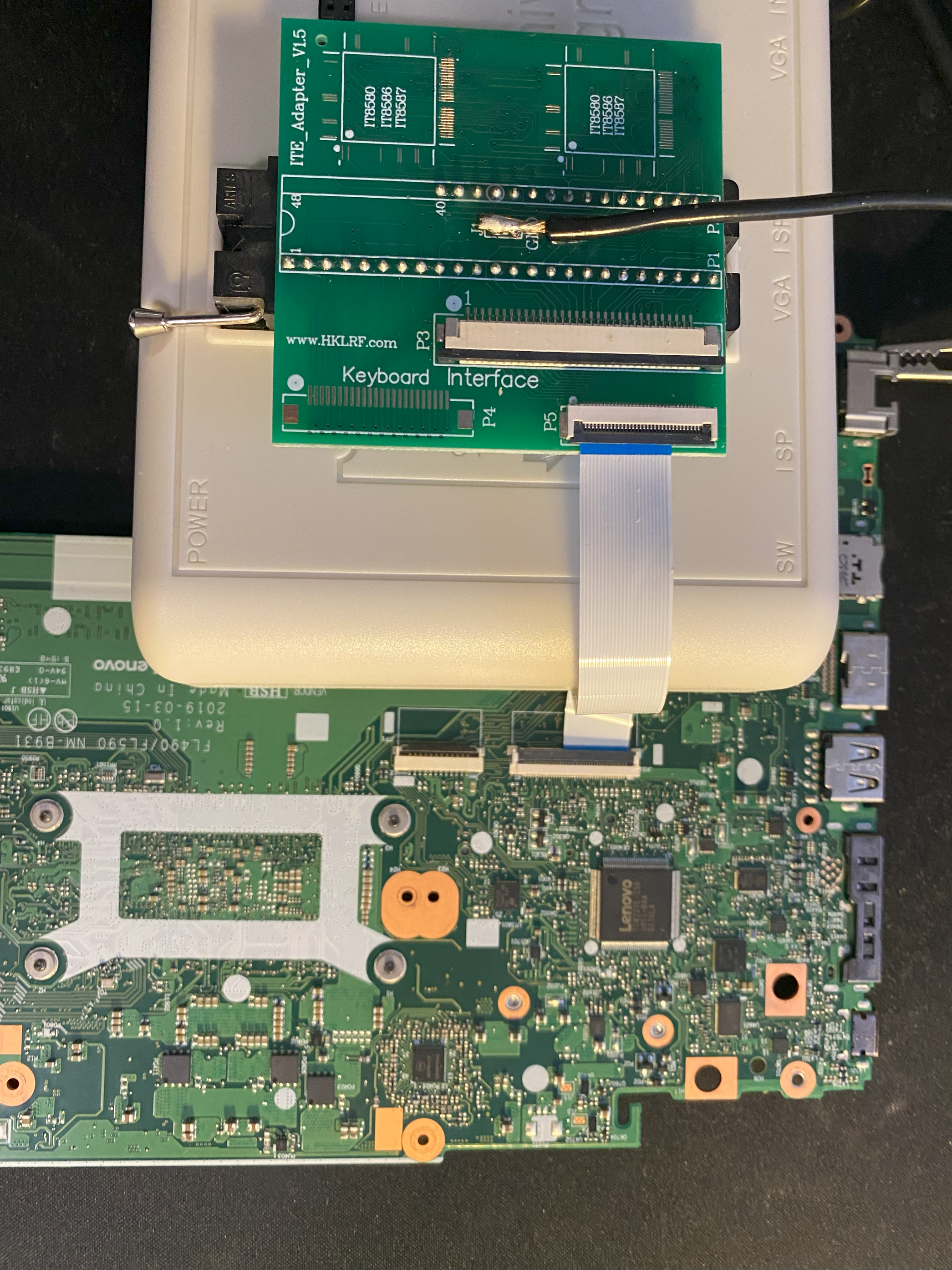

                        Hi, I´m trying to program the IT8227E with a RT809H programmer on a Lenovo board NM-B931.
                        I´ve set up the lines according to the schematics and connection is made with a 24pin flat-cable. (see pictures).
                        Unfortunately I get a error message when I try to read this chip. I´m curious if this chip is really not programmable via the keyboard connector. If I measure with my multimeter I get a connection between the EC and the pins on the KB-connector...
                        Can anybody help?
